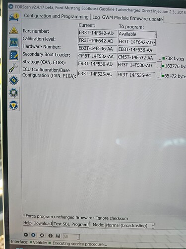

What I would like to try next is to update my 2015 GWM to 2018 or 19.
Also would like to find some information on the GWM asbuilt. The database has nothing in it for the GWM.
You can update up to the 2018 firmware with your hardware. But I doubt that is what the issue is with the remote start thru the FP app.

Replaced the GWM with a J series from a 2018 mustang. Deleted the Mustang in the app, uninstalled the app, rebooted the phone, reinstalled the app, added back the Mustang but still no remote lock/unlock/remote start through the app.
