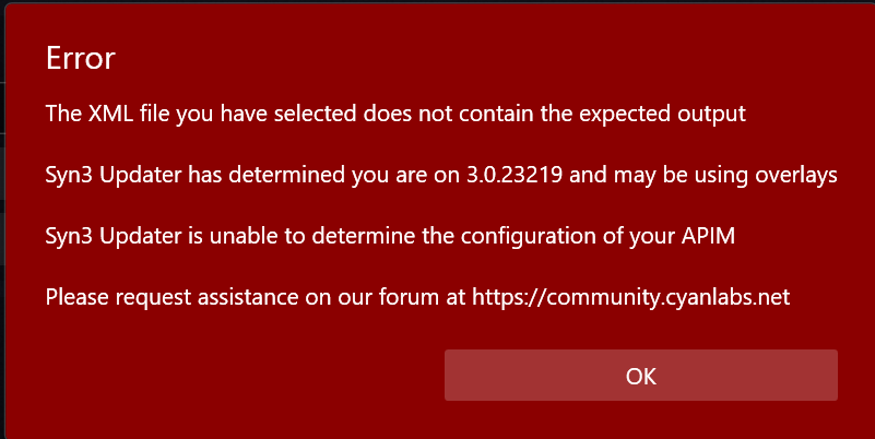

this is the message i got
I’ve asked for 2 simple things:
You didn’t provide it.
I’ve lost interest in this thread.
this is what your looking for? i apologize I’m not too good when it comes to this kind of stuff…
