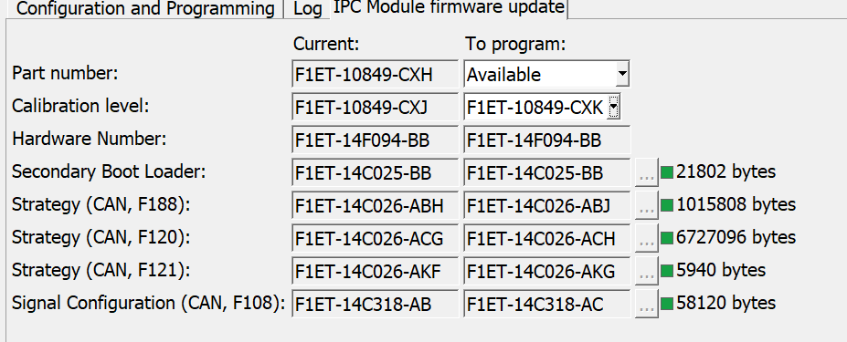

Charger shouldn’t be an issue either since I have access to a few, but taking a peak at my current cluster with Forscan says the latest calibration level available is F1ET-10849-CXK, I’ve attached a photo below for reference.
Would this still work on this firmware since the other 2016 is probably the same Part #?
I’ll say “should”
The 2017s I looked at on eBay have -CXN, so a jump like that makes me wonder if the 2017 has a hardware component change like the Fusion had where the 2013-2014 clusters had a smaller ROM than the 2015-2016, with another change in the 2017-2020.

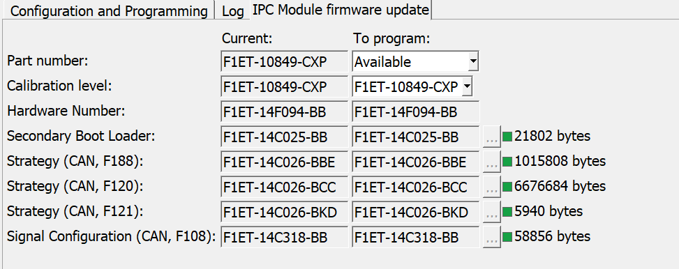

Well, I just got back from another scrap yard and was able to grab an IPC from a 2017 Focus Hatch.
It’s the proper part # and running the same firmware you had mentioned in a previous post.
I just finished installing it and programming the correct mileage and parameters to match my old IPC.
I’ve attached yet another photo below of the new IPC firmware.
