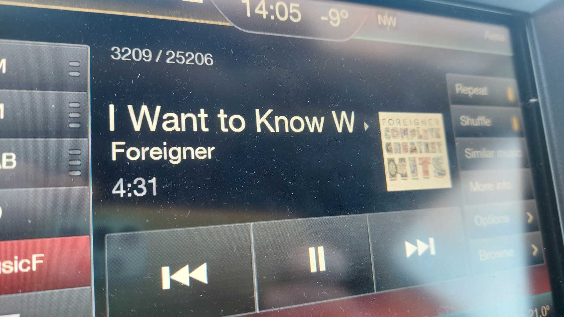

Ill try. Yesterday, i made one weird thing. Looked at smaller GN but did not noticed that i downloaded 3.3 app file not GN file and installed it just changed ver no in autoinstall and also file name. I was surprised when it started to work and all was so strange how it looks like. Then, wow, version 3.3.1xx and no GN. Tht means i downgraded it without any issue.:smiley: . Ill let the system deal with my USB thumb today, it has 33884 songs on it and then try how voice commands will work.
Sync will not index that many songs at once and will need to constant re-index when you insert the USB or try to play a song from the USB. The max item count is like 10,000. I know I’ve gone over this before and the USB would not even show up. Also, use NTFS for audio USB’s, not Exfat or Fat. This is specified by Ford.
Sync2 is pain in *ss. Manual says 30K is limit but if u have more than 10K problems starting. U never know when it will index all or more like about half of them. My unit has magic +/- 13K. Max what i got was 27 xxx thousand but real number was like +500. So probably it counting folders and subfolders too. I tried to make USB thumb where all object were almost 30K together but yeah it was lottery. Sync 3 is easy. about 1-2 min it ewill say how many songs u have. and then it will take time indexing and building voice commands. All time when i change smth sync 3 gives correct amount not like sync2. I have 256gb thumb what is almost full right now tht means 33,8K right now. Maybe i gonan take 512Gb stick and will check how it works when im close to limits 50K for sync3.
Also to note here is that Sync 2 is really about 5000. I have never heard of anyone getting more than 10,000 on Sync at all, but I’m sure someone was successful. On Sync 3.4 you could run the RWData cleaner, the -BB version, and clean out the RWData cache. This seems to help but is probably not the real solution.
