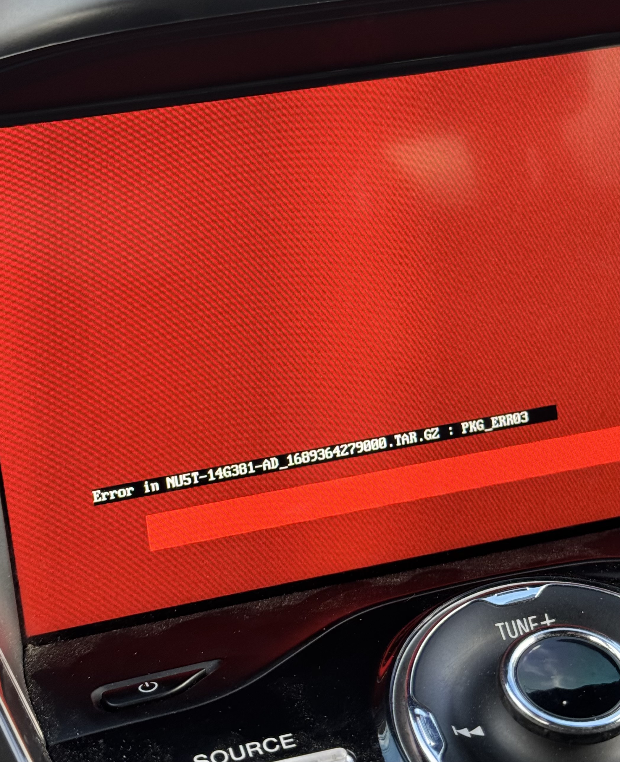

Anyone can help me? I was updating my sync 3 but this error appeared during the update. Can someone help me? My car is a Ford escape 2016 titanium
Please post your installation log from the usb…
here it is log.txt (16.2 KB)
Missing/incorrectly formatted reformat.lst file. Re-create the USB, or check for errors in reformat.lst or try a larger USB flash drive.
You are using a potato USB:
Model: SMI USB DISK USB Device
It’s even failing while being created.
Get a good one, recreate the USB and try again.
