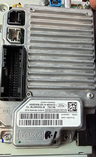

Which tells me you didn’t check if it was a MY20 APIM or not.
So, get the APIM model.
If you unmount the unit, take a picture of the sticker and share it with us.
Here is the back of the apim.
Super old G series APIM.
Has the unit or screen ever been serviced?
Remove these lines from the autoinstall and rename the Item2 lines to Item1. Do not remove the USB till you see the GREEN screen after the reformat.
