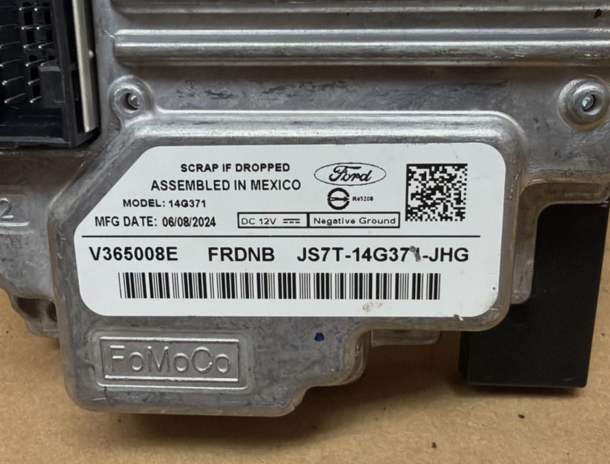

This APIM is MY20, and you just killed it by reformatting it with Syn3updater.

Ok then, it seems you value AI over human knowledge and experience(*), no need to keep this thread open then, you can ask the AI how to fix your issue.

(*) A human that created a tool with a built-in protection check that would have prevented you killing the unit, protection that you just bypassed by the way… You only had to follow the guide written by such human…
Ai is wrong. This is a MY 2020+ Replacment APIM. I did’nt even have to use Ai and I even got a pic of it! The APIM is bricked.
