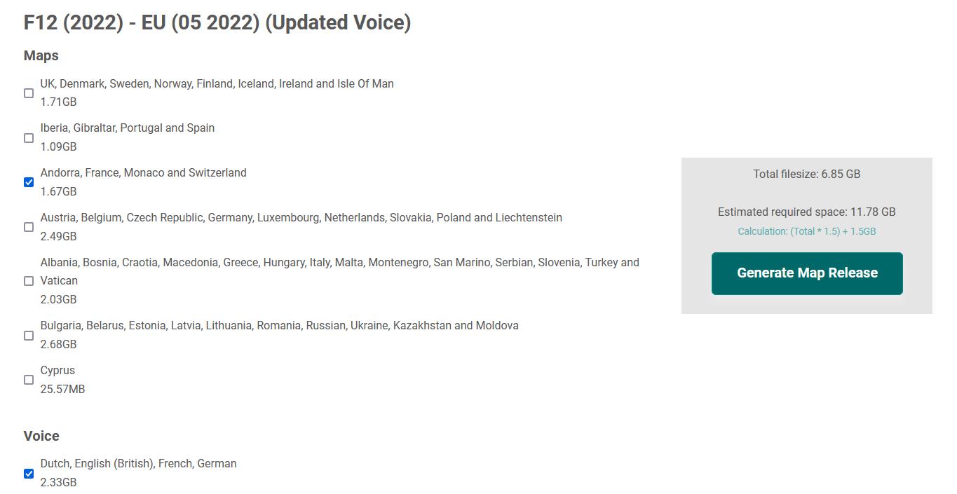

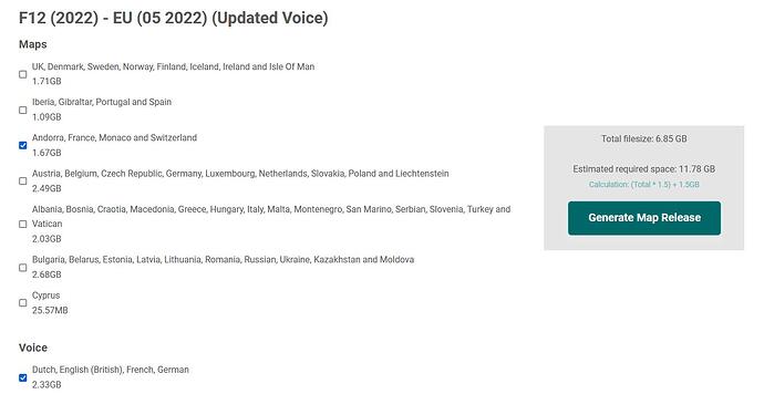

To use the Reduced Card Package Generator, do I have to select a voice package or only a card package?

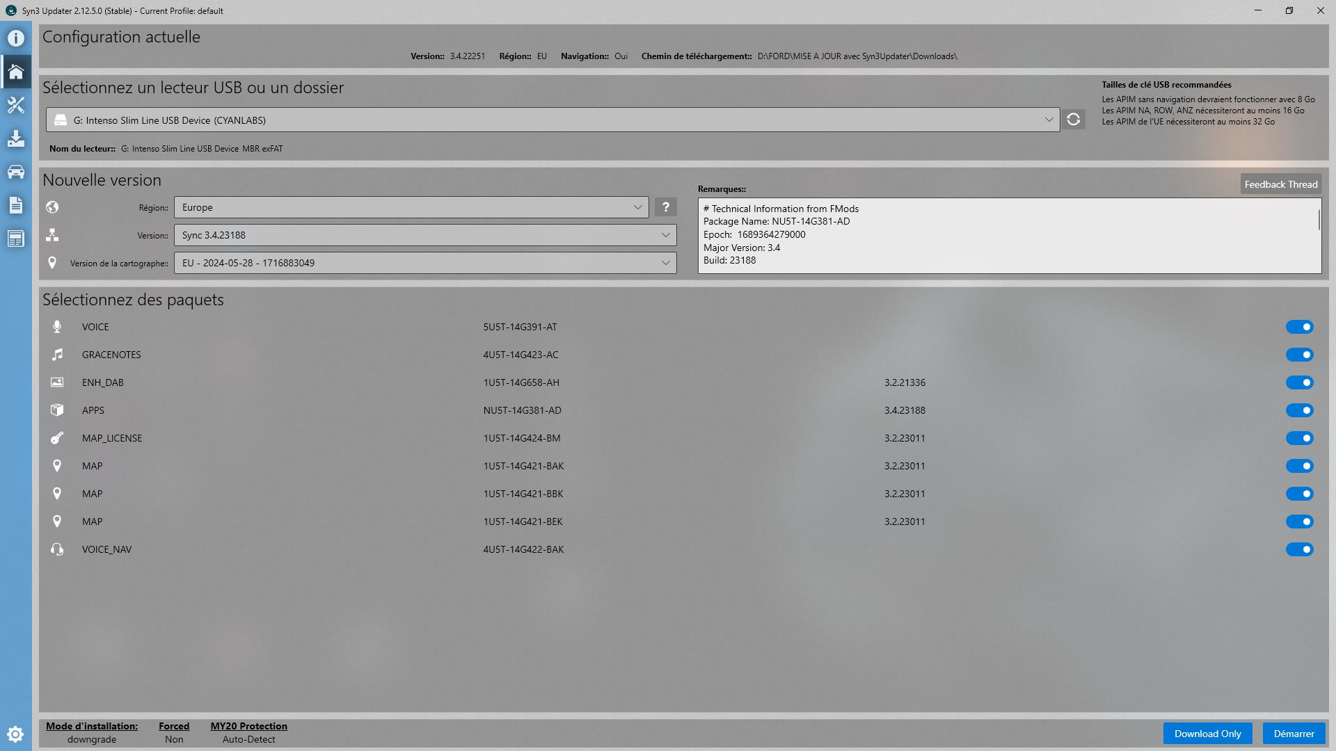

With the Syn3Updater 2.12.5.0 software, the voices are already there, hence my question.
You need all of it or you are going to be missing bits.
Thanks for the answer, so I don’t change anything in the Syn3Updater 2.12.5.0 software but my question is do I have to select a voice pack in the reduced card pack generator?
That depends on if you want Voice or not.
Ok I’ll do the update as on the picture of my post. I’ll be back to tell you if everything went well… or not!
It’s totally depend on you.
So I did the update and everything went fine. With these settings:
I now have the latest version of my Sync in 3.4.23188 and carte de France F12. About 1 hour 30 to make the USB key and 25 minutes to install it in the car.
