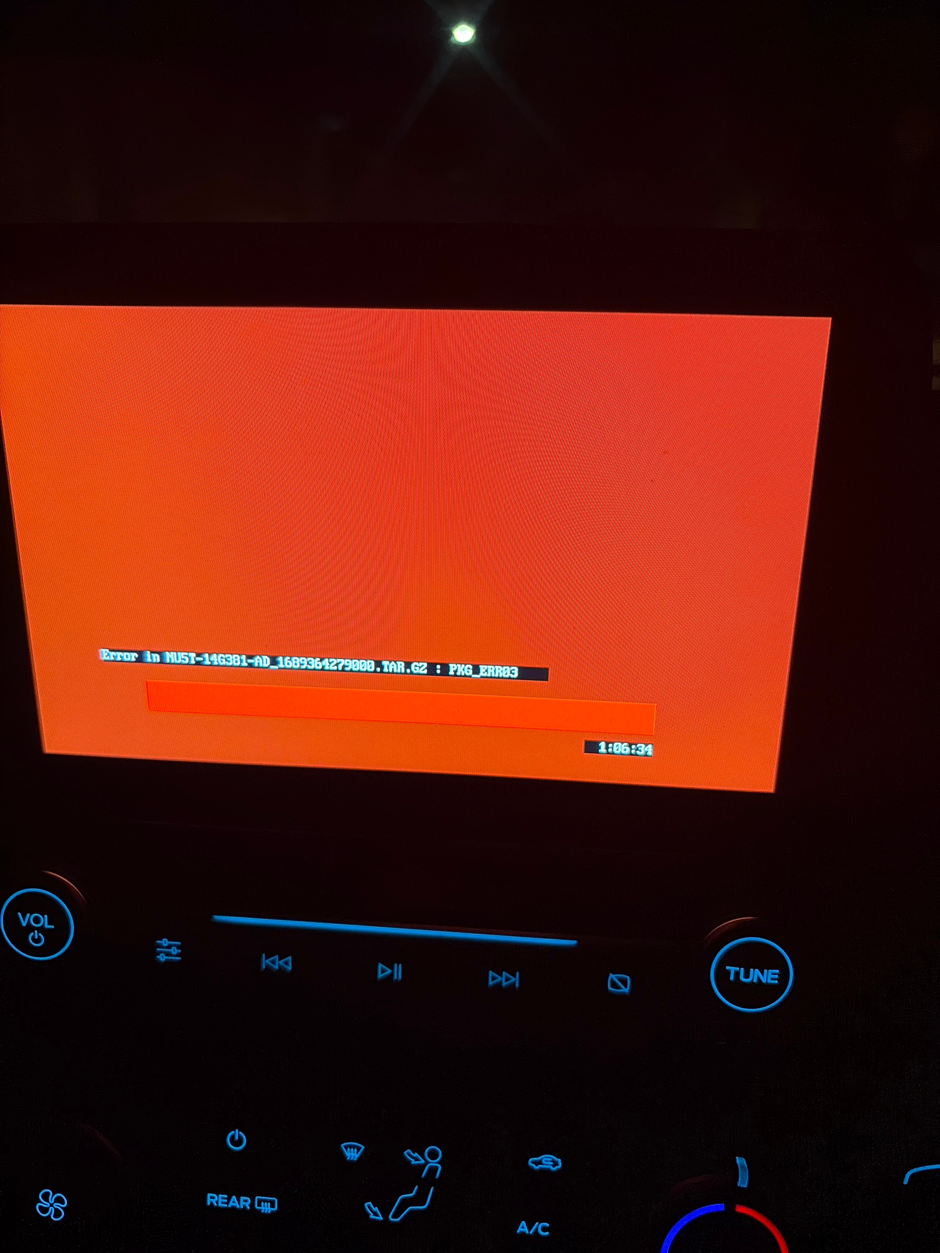

hi I’ve got a red screen with error trying to update head unit. This is a non-Gps version 2018 model Australian version. Can somebody help? Do I remove the USB or do I wait for a green screen and will my radio turn back on?
SYNC Region: ANZ
Old SYNC Version: 2.317109
14g381-ad_1689364279000.tar.gz :PKG_erro3
Syn3 Updater Version: Latest
Qq
At this point the installation has stopped and needs to start over.
I re inserted usb 3 times and it’s not working it comes up with same error

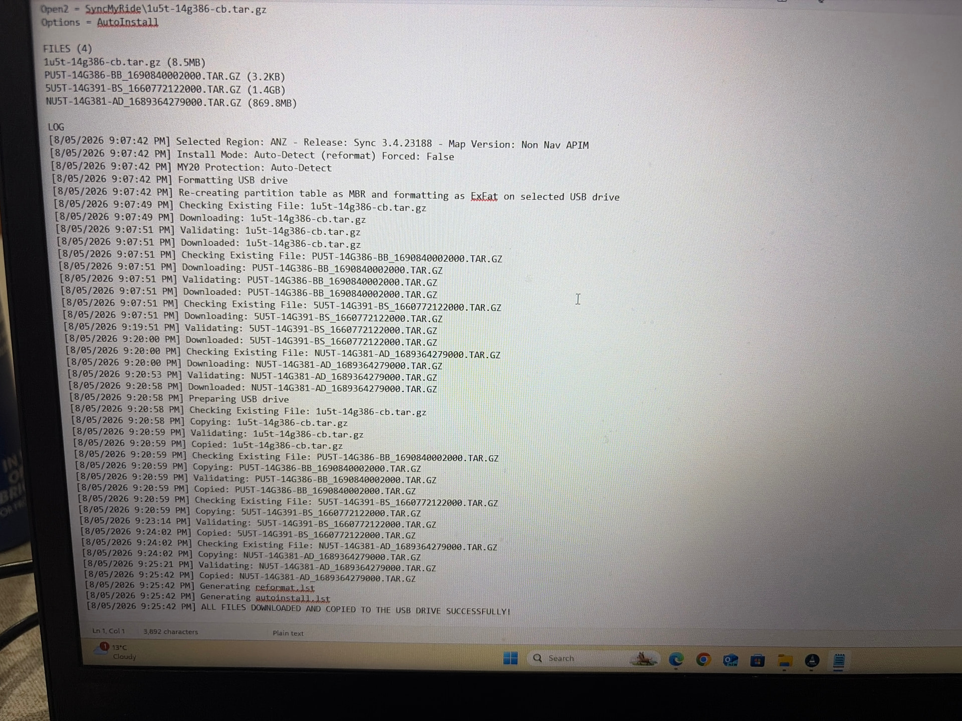

Make a new USB with a different stick.
I have reformatted usb I was reinstalled on usb Device and the same thing has happened. I’ll go out and buy a new usb and hopefully that fixes it
If only we had what the template asks for, a complete text log for the USB you created… but yeah, try a new and decent USB pendrive, like a Sandisk.
