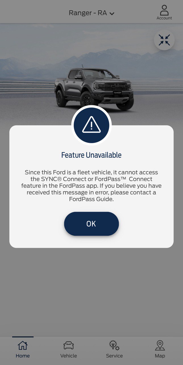

Hello guys I have Ranger Raptor 2023 and fordPass was working fine until I did an update for APIM and now fordPass not working it says that my vehicle in fleet mode.
I checked Forscan TCU status is unprovisioned.

The TCU from the factory and I bought the car from a local dealer. fordpass was working with no issues until I updated the APIM it stopped working (Fleet vehicle).
I use us account for Fordpass not a us TCU.
