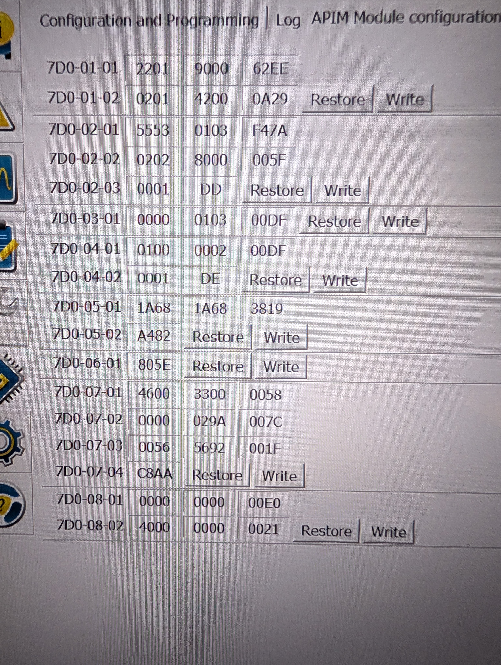

Thanks in advance. I am someone that loves to learn and been trying FORscan to adjust a number based on forums, but always falling back on the original profile I saved if anything changes that is unwanted. The only thing I am trying to learn is the APIM setting. Everything else I am not touching.

Attached is my APIM and ACM values for my 2014 F150 XLT
F150Forum.com, Gen 12 forum has Sync upgrades documented that may help.

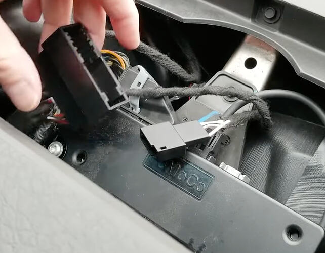

Thanks. I will look into that. I was watching a install video tonight to see if their was anything I missed. I learned the sync harness adapter I got appears to not have plug for this small box on top of the dash which I believe is causing my blue tooth issues. Still trying to figure out how to turn on the climate repeater and the fan repeater option in the APIM or ACM.
That is a Sync 2 GPS module. Has absolutly nothing to do with bluetooth or Sync 3. What it does do is effect your IPC compass or Sync 2 screen compass.
That is good to know. That is the only connection I was missing with the harness adapter trying to learn what it is used for before I call it a night. Thank you! I won’t worry about tracking down a new harness, but back to trying to figure out my bluetooth issues.
I do think you have a wiring issue though with the microphone. Now the box underneather the the GPS module that has the USB plug going into is alo a concern. That reminds me of an old Sync 1 module.
Thanks I will look for another good quality harness to install it to try and rule somethings out. That USB connector went to the old SYNC port plugin under the radio, and I left it unhooked since the sync 3 no longer needed it. That connector with the white wire was what I was missing that goes to the GPS box for older SYNC 1 and Sync 2.
There was simply one connection under the tray on the dash that I hooked up.
