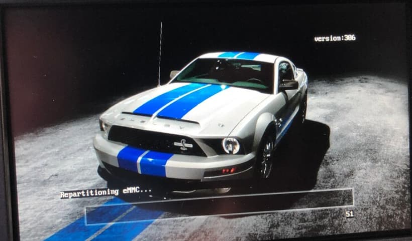

From what your saying, it’s in the reformat phase (mustang displayed)… If so, create a new USB with 3.0 as current and 3.4 as new build . That should create a single USB that will reformat the unit.

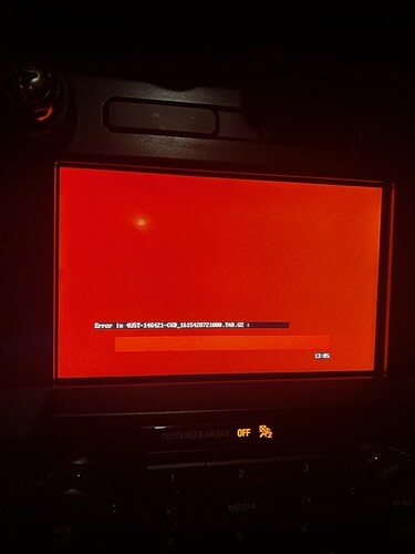

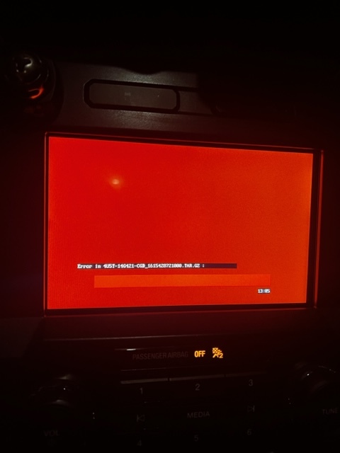

So lets do this: tell your buddy to send you a photo of the screen when the “insert USB” message appears.
I will have him do that and send it to me. I will follow up.

Fast forward to last week. My buddy was in the truck with me and asked " How did you get yours updated". I remembered I had the USB in my console from when I had done my truck 2 years prior. I gave him the USB and he took it home that night and input it into his 2018 F150 with the same radio. He said when he put it in it acted like it was working and then at the end he got an Orange screen. Now when he starts up the truck it says enter USB and then the screen goes black.

Ask your friend if he sees something like this:
This sounds like he is on the reformat phase, which is good…
He should be seeing something like the screen I’ve sent before.
If so, it’s recoverable.
So double check with him what’s the screen he is seeing.

He said he looked up the code and it said it was for trying to install a navigation update on a unit that did not have navigation available.
Thanks, so that confirms he is stuck on the reformat phase, which is an easy fix.
Have him create a new USB with Syn3Updater, with:
  • MY20 protection disabled
  • Any 3.0.xxxx as current build
  • Make sure Syn3Updater is configured as NO-NAV
  • The latest 3.4 as target
That will create a reformat USB, that’s what he needs.
