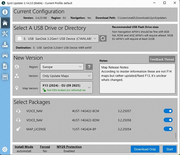

My question is: Can i update my maps using SYN3updater? F11 —> F13/F14

I prepped a 32GB flashdrive with the following settings.
will this work?
Yes, but post the log after the usb is created and I double check.

Thanks, that looks fine, just autoinstall with MY20 protection active and the device seems fine.
Remember it will take multiple reboots, if you check the autoinstall.lst file on the root you will see it has 3 sections, so 3 reboots (or maybe 2, I do not remember)

Thank you SaNdMaN, i updatet the maps today, it took nearly 2,5 hours :slightly_smiling_face: (with 3 reboots).
