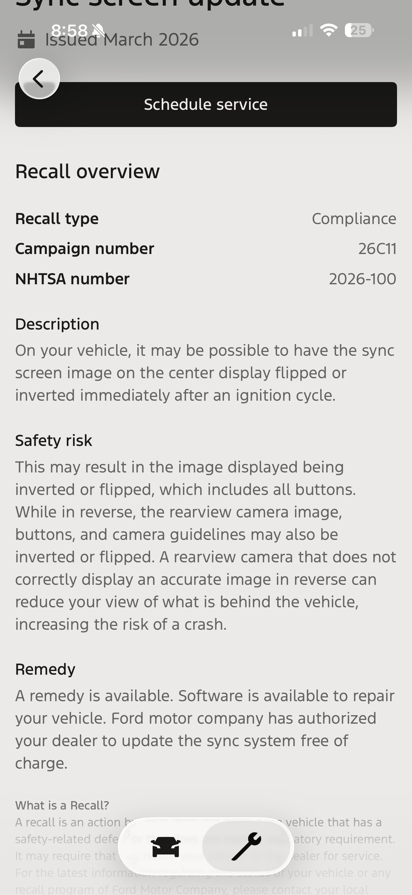

I’ll attach a picture from the Ford app referencing the recall for Sync.

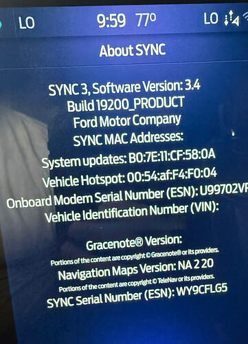

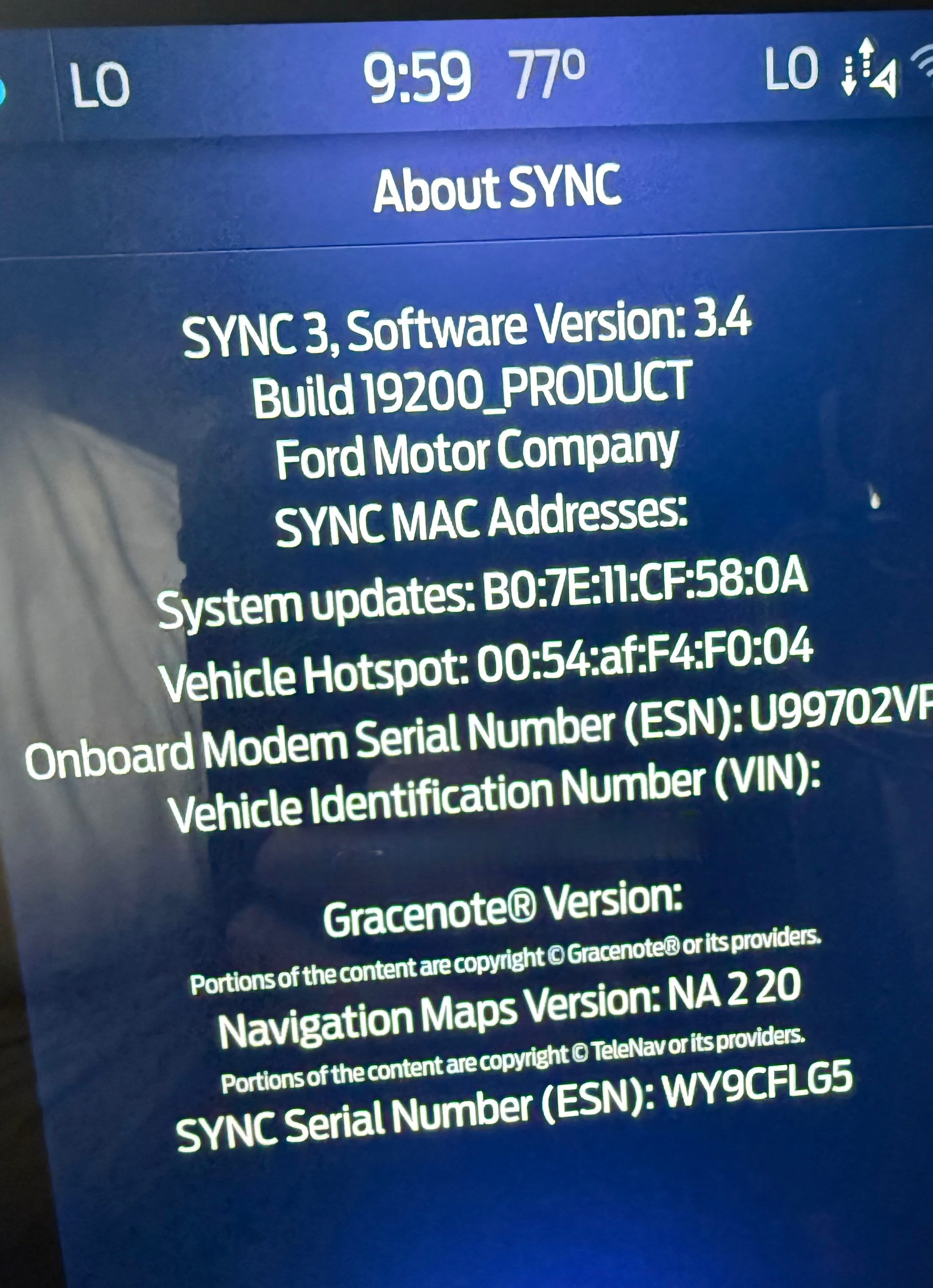

Gotcha, thank you for the detailed breakdown! So the installer now checks to see if you have a MY20+ vehicle and if so skips the reformatting of the system and just installs it instead. So it installed the Nav update, but is failing installing the Sync version.

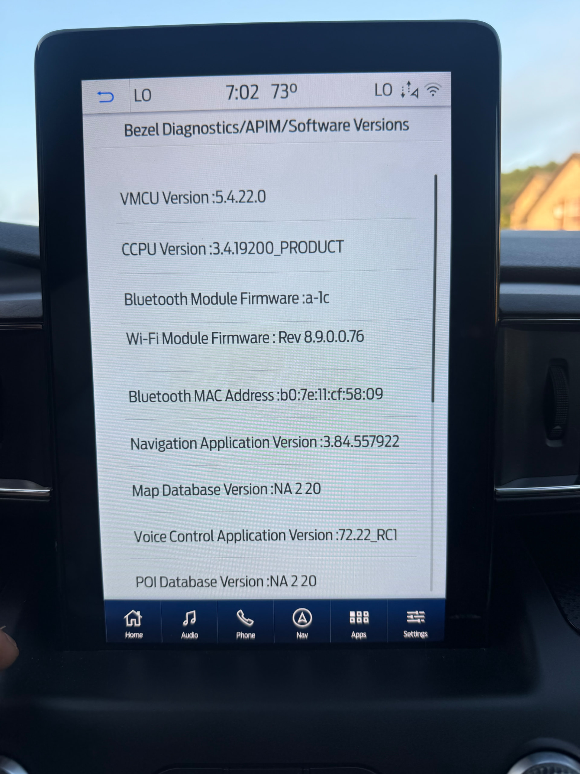

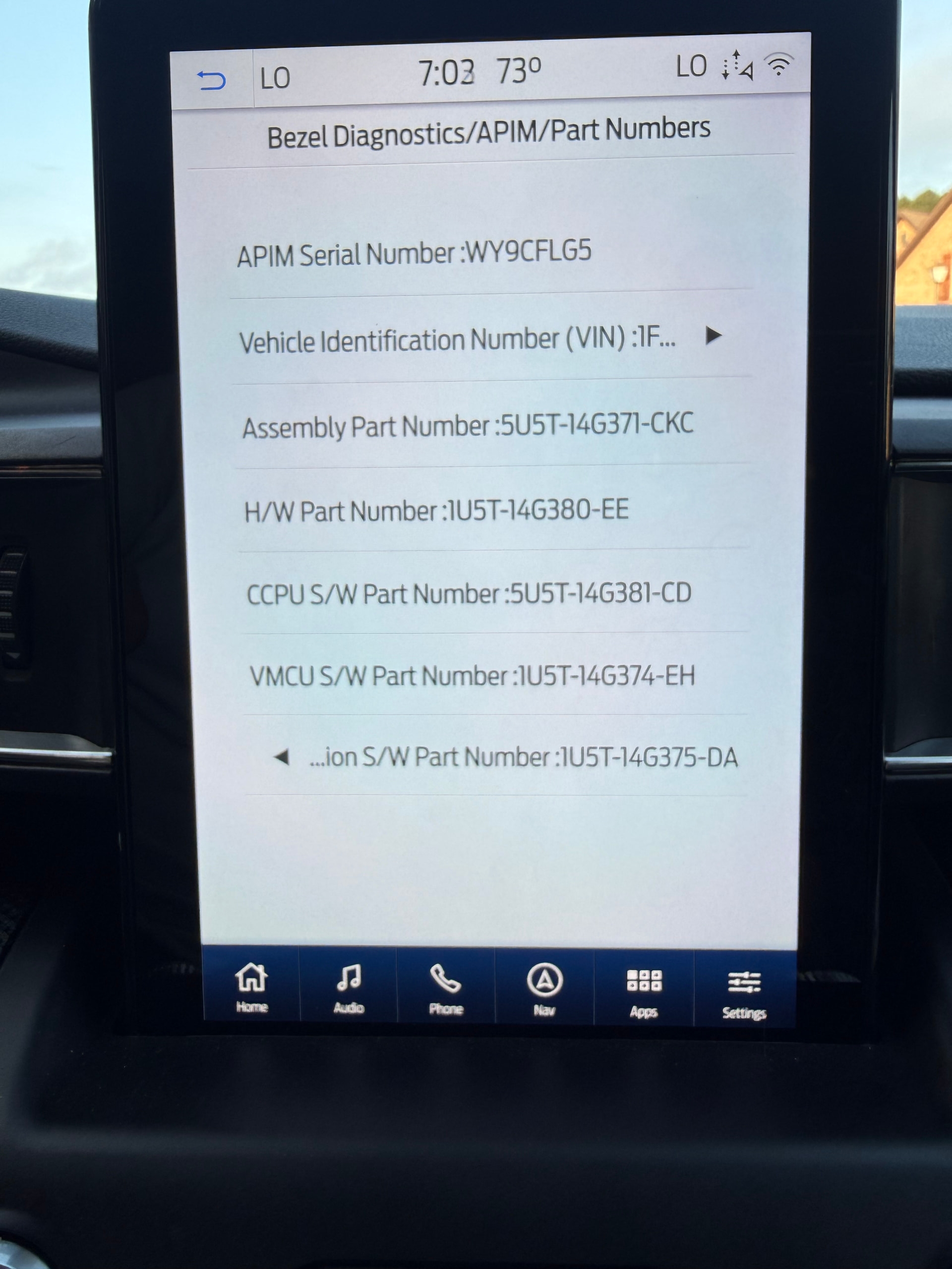

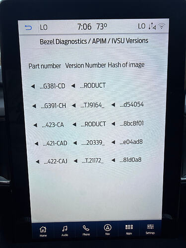

Here are pictures of the Bezel menu. I copied the logs directly from the AsBuild logs after running interrogator. Did I pull the incorrect logs then? The only other thing I had was this site breakdown not sure if the information is useful.
Also, I’d be more than happy to share the install files… where would they be located as I used Syn3 auto install method for NA.
Thank you guys for your input, it’s really appreciated.

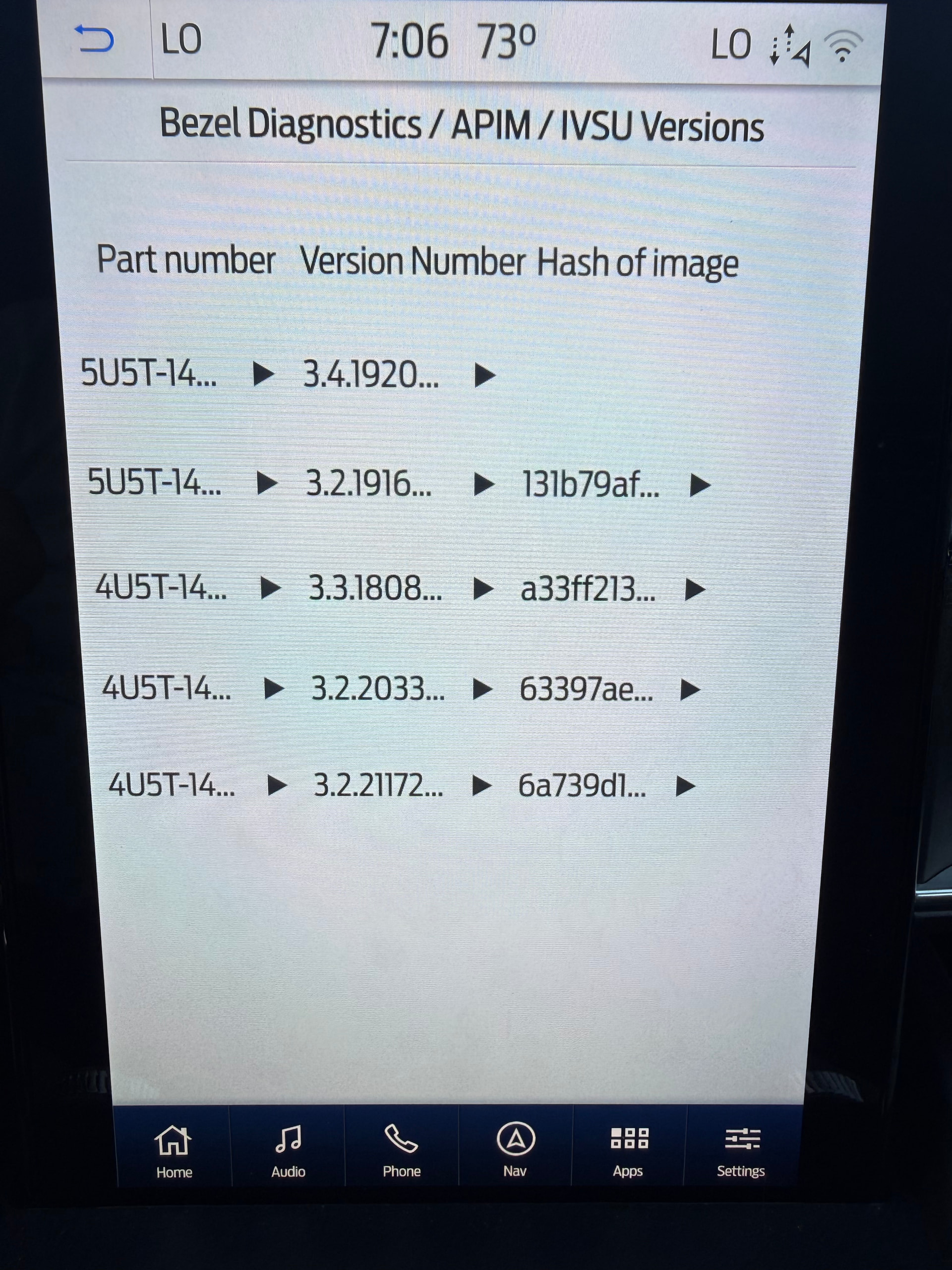

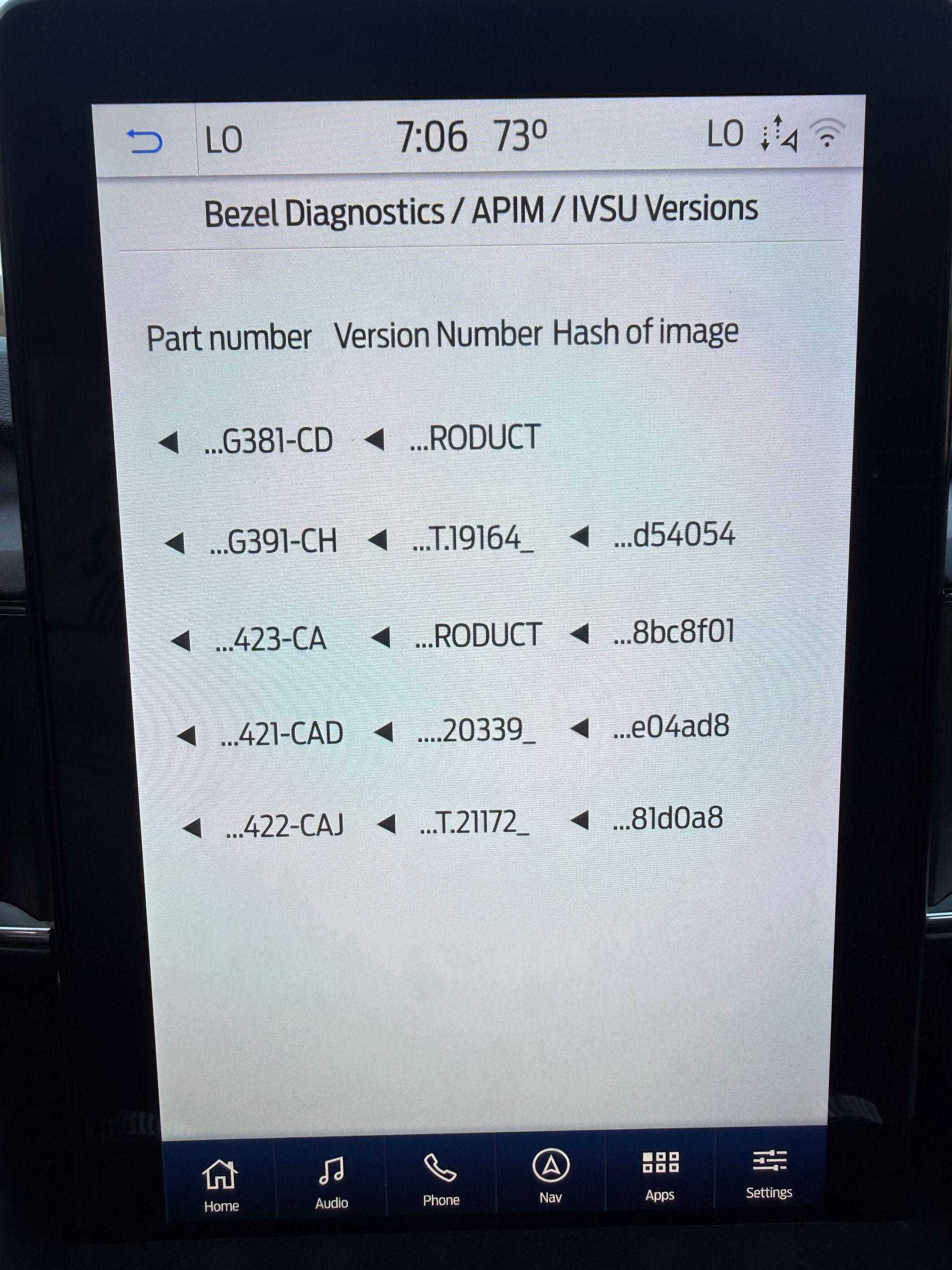

Thanks, but that’s not the pages I’m looking for. There’s one that lists the installed packages on the unit, sometimes the interrogator do not see all of them (like your case), but maybe that one does.
Gotcha is this the one you’re looking for? I snapped a couple of these as well however it only shows partials as it scrolls, I took pics of the first and last parts of the information. I’m not with the vehicle at the moment but if it’s the page your looking for I can write the names down later today.
That’s the one, yes… But you will have to go through each one of them and get the full name…
No picture is needed, just take note.for every one of them
You have the last maps, 2.20 before the ECN was required. You will not be able to proceed beyond that without reformatting or purchasing them from Ford.
That is a 2020+ APIM so dont format it or it will brick.
This is the first and second row complete numbers. I can grab the 3rd one if needed, they are just about 50 letters long and scroll by pretty quick, and a pain to grab lol
