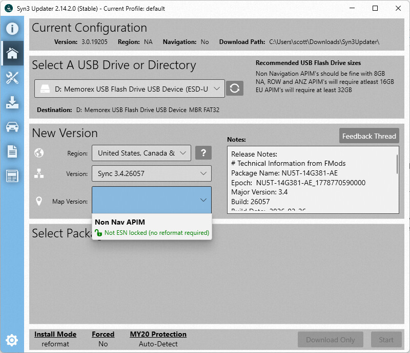

I have a 2018 F150 on version 3.0.19205 with Navigation. I am walking through the set up of the Sync3 updater. Just want to make sure I am doing this correctly. I clicked the Map version and it appears to only offer me the Non Nav APIM option. I selected older versions, thinking maybe version 3.4.26057 doesn’t have NAV (build docs didn’t mention that), but I am still not presented with a NAV version option. Any help is greatly appreciated.
Old SYNC Version: 3.0.19205
New SYNC Version: 3.4.26057
there are no errors

Hey Dude, it seems to be a bug, go to profiles then toggle navigation off and on and click save.
Ah. That fixed it.
Thanks!

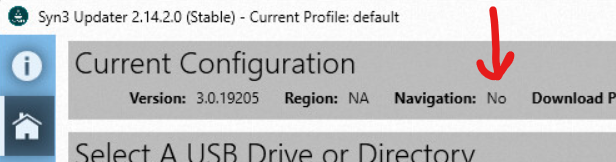

Hello.
Your screenshot states NO NAV:
Hence, it’s showing only no-nav options.
Missed that header. I guess I thought that toggle for Navigaton on the first step was to toggle Navigation off, not that it was current set to NO.
