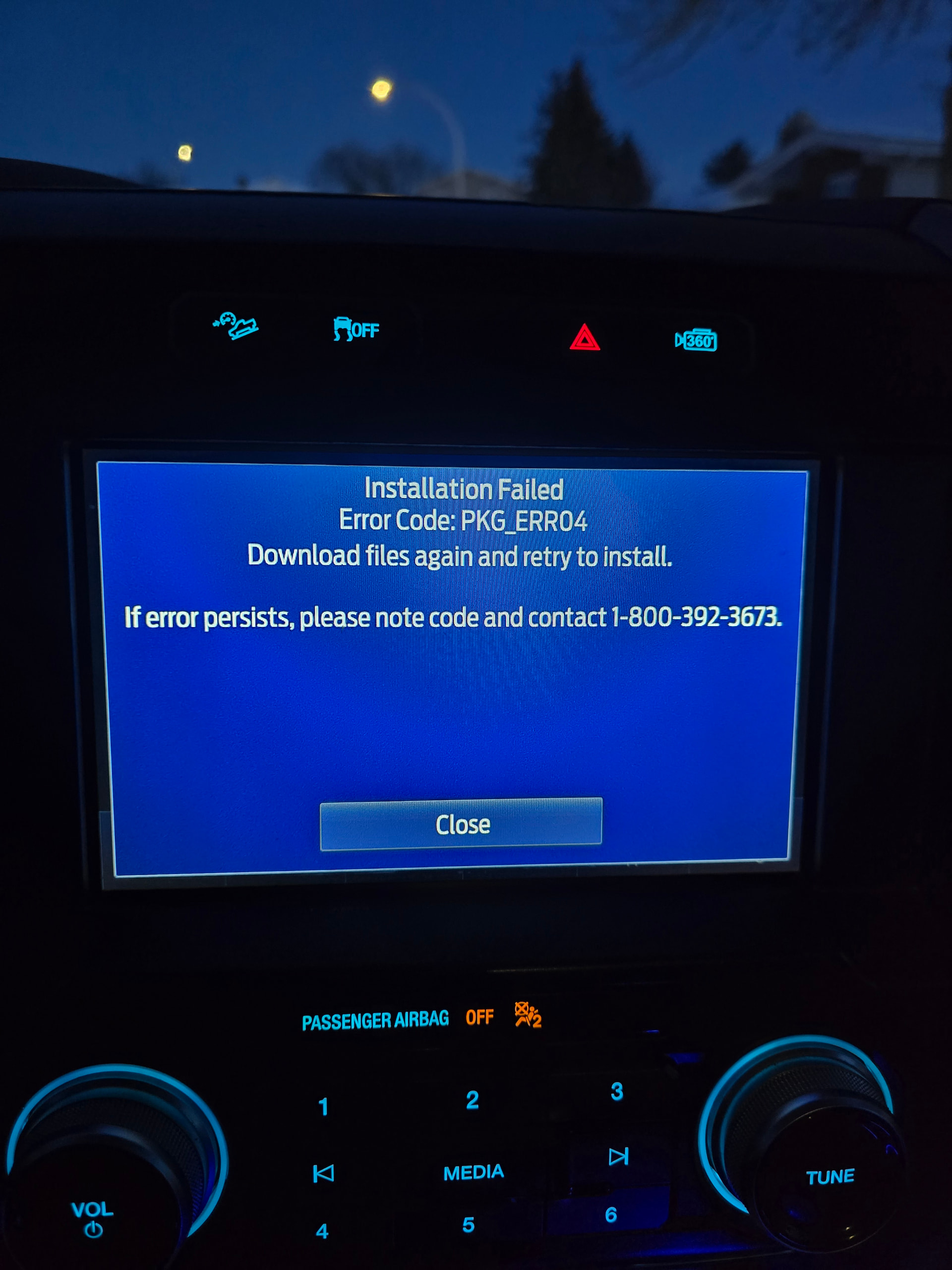

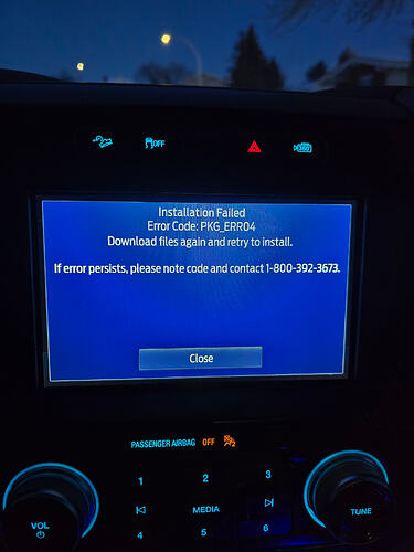

I get pkg_err04 when I plug in interrogator USB
