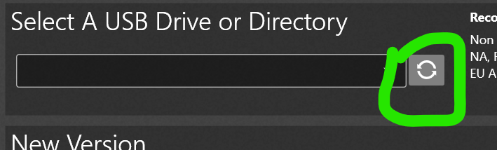

Thank you! When I plug in my usb, it does not recognize it when I go to select a usb drive. But I am manually selecting it when I look through the directory. I’m not sure why it wont recognize it automatically, but I do believe I am selecting it manually correctly.
Just use good quality usb thumb or use another usb hole in ur PC. Sumtimes windows doing whatvit wants not what u want.
After you plug in the USB than click the refresh button. It will only recognize the USB if it is there when you start the updater.
