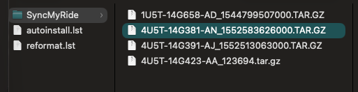

Capture d’écran 2025-11-22 à 10.10.08
autoinstall.lst (152 Bytes)
Packages need to be in the SyncMyRide folder, .lst files in the root (outside the folder).
Read the guide for reference, it tells you how to crate the USB structure. USB structure is always the same when it comes to Sync3.

Double checking your previous image, it seems you uncompressed the file.
It needs to be .TAR.GZ, it only shows .TAR.
This is not hard, your current .lst file is
Item1 = APPS - 4U5T-14G381-AN_1552583626000.TAR.GZ
Open1 = SyncMyRide\4U5T-14G381-AN_1552583626000.TAR.GZ
If the file “SyncMyRide\4U5T-14G381-AN_1552583626000.TAR.GZ” does not exist, it will fail.
