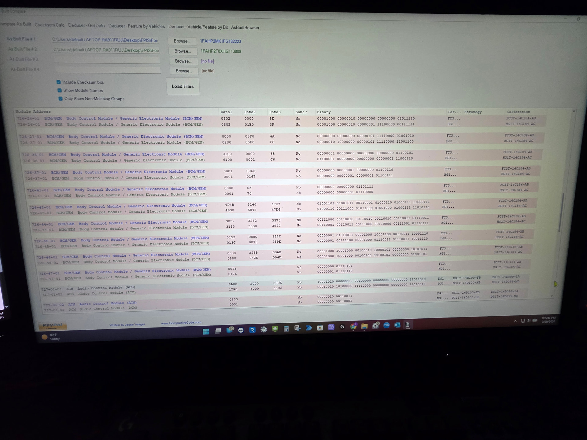

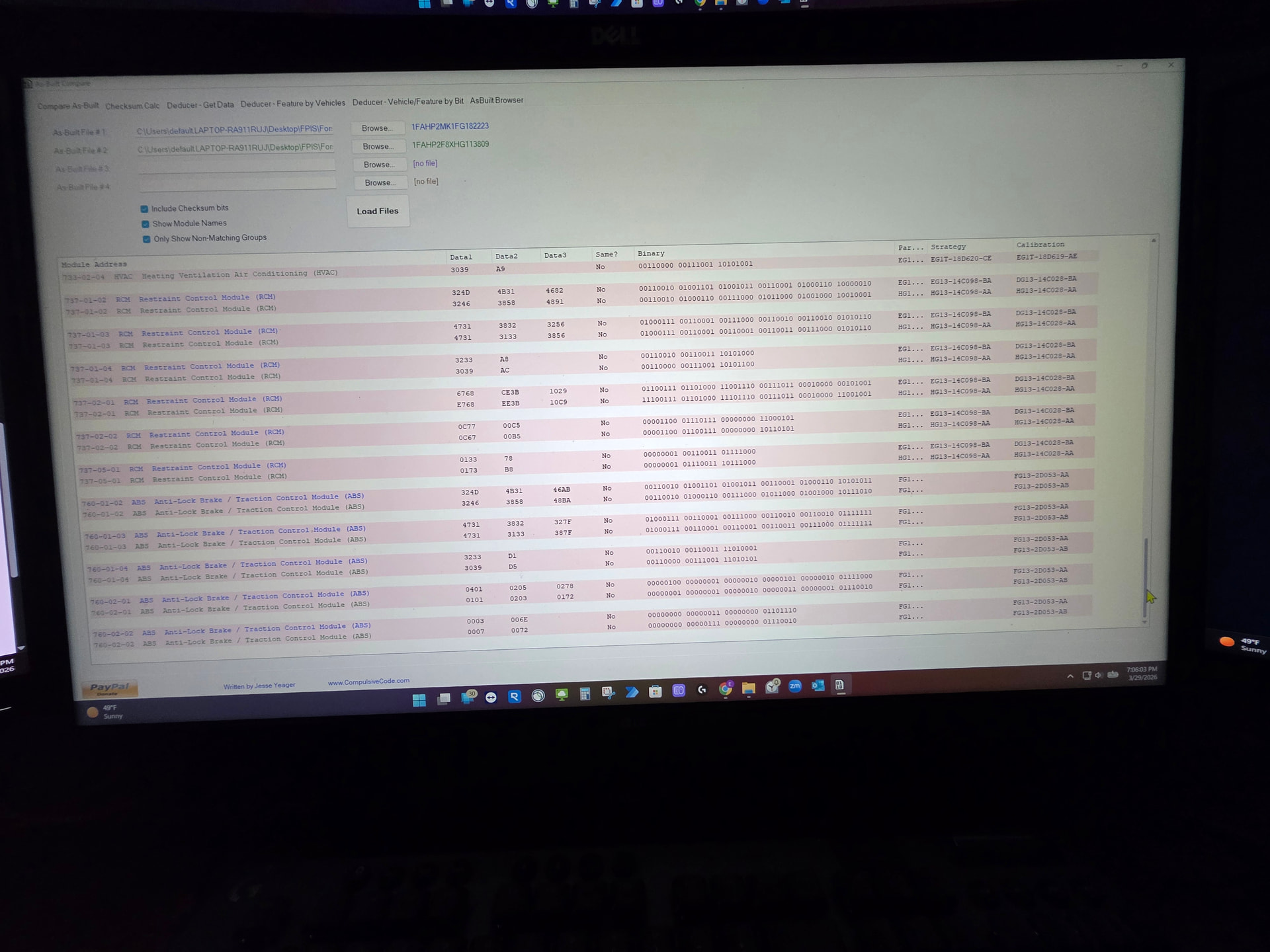

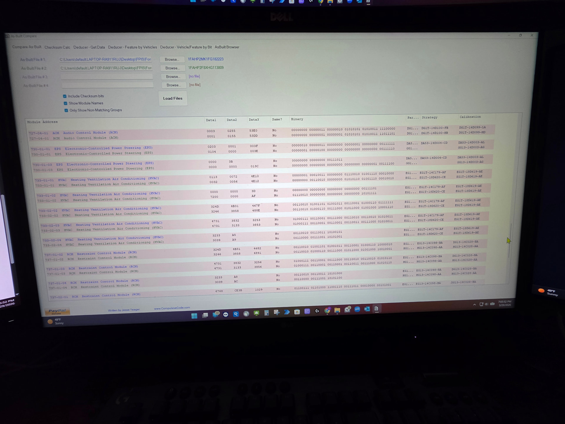

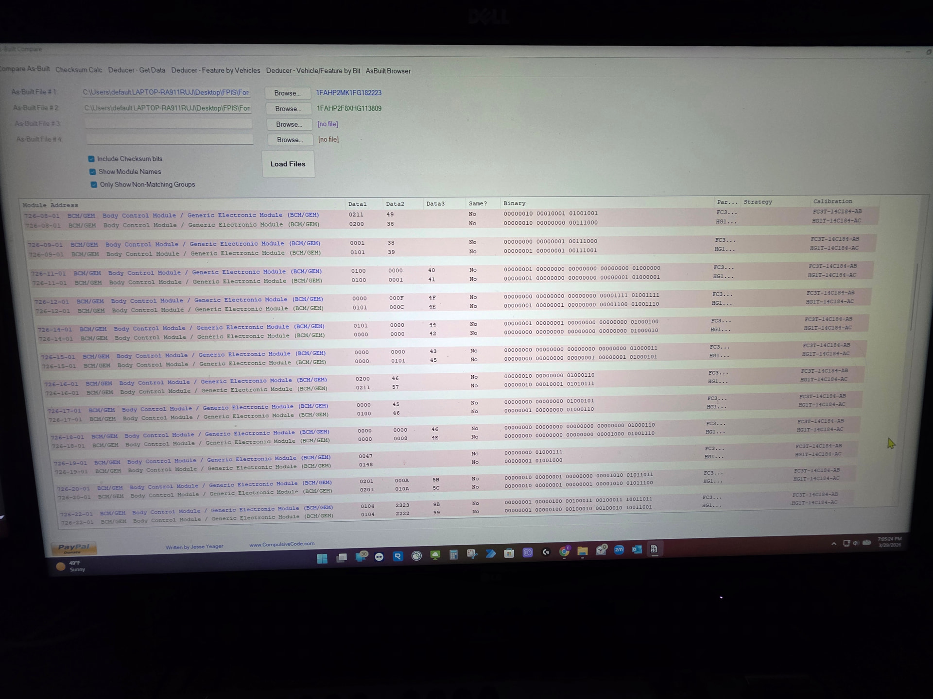

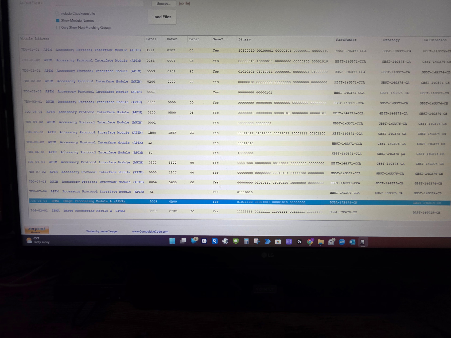

The vins are in the picture. Hopefully they are clear enough.
1FAHP2MK1FG182223 my car 2015 FPIS
1FAHP2F8XHG113809 2017 Taurus Limited

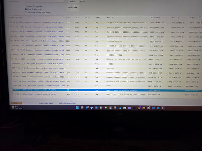

Post you AB from Forscan for the APIM. I dont do the compare tool. I am pretty busy right now so I may not be able to go through it till tomarrow night.

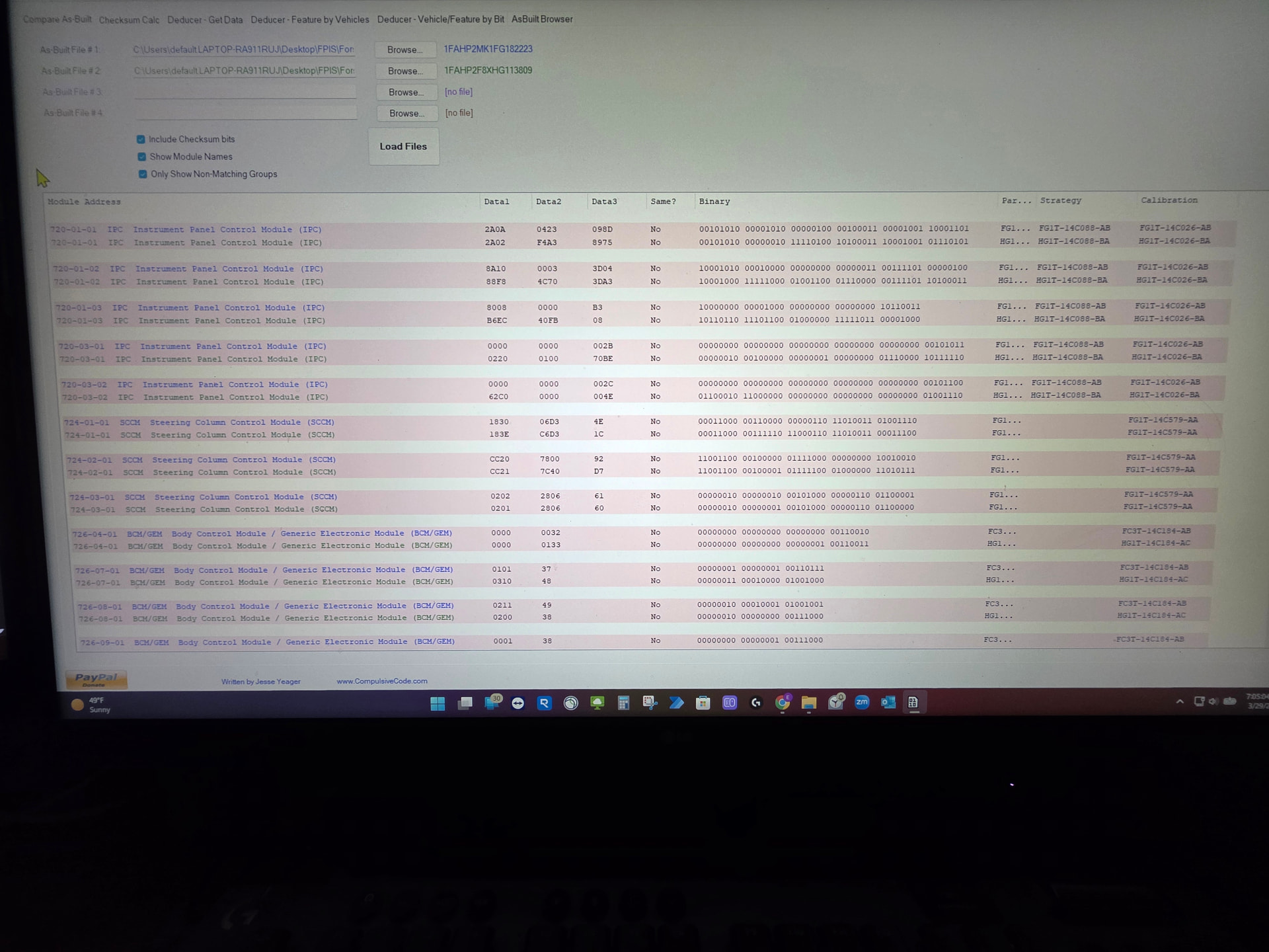

2015_FPIS_1fahp2mk1fg182223.ab (10.8 KB)
2017_Taurus_SYNC3_1fahp2f8xhg113809.ab (21.0 KB)
I appreciate it. Thank you
I am happy to help but whatever you sent is not gonna work. Please just get a snipit picture of the APIM AB in Forscan.
Apologies, pretty new to this. I will connect to my car later today.

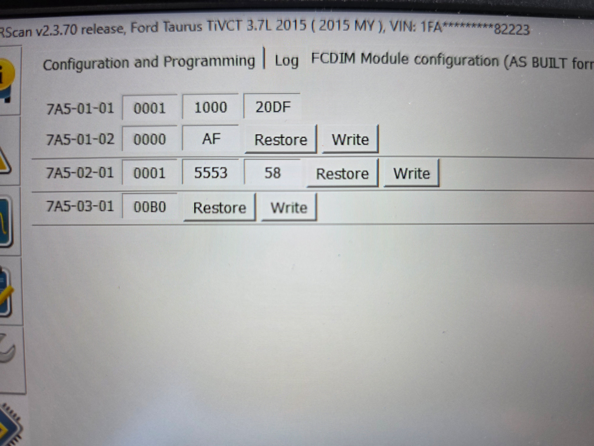

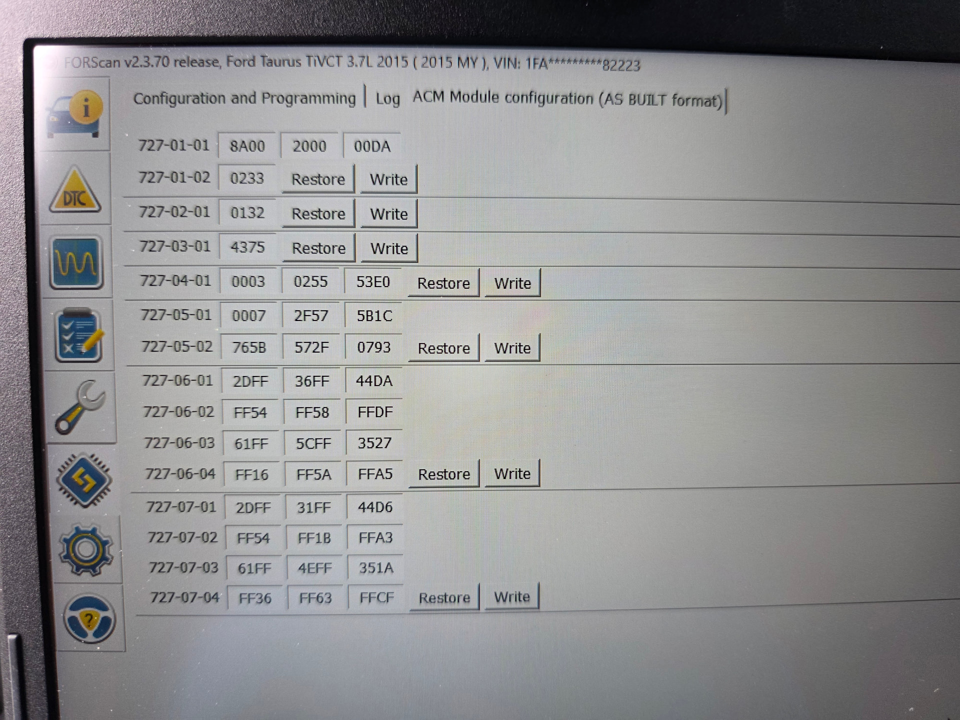

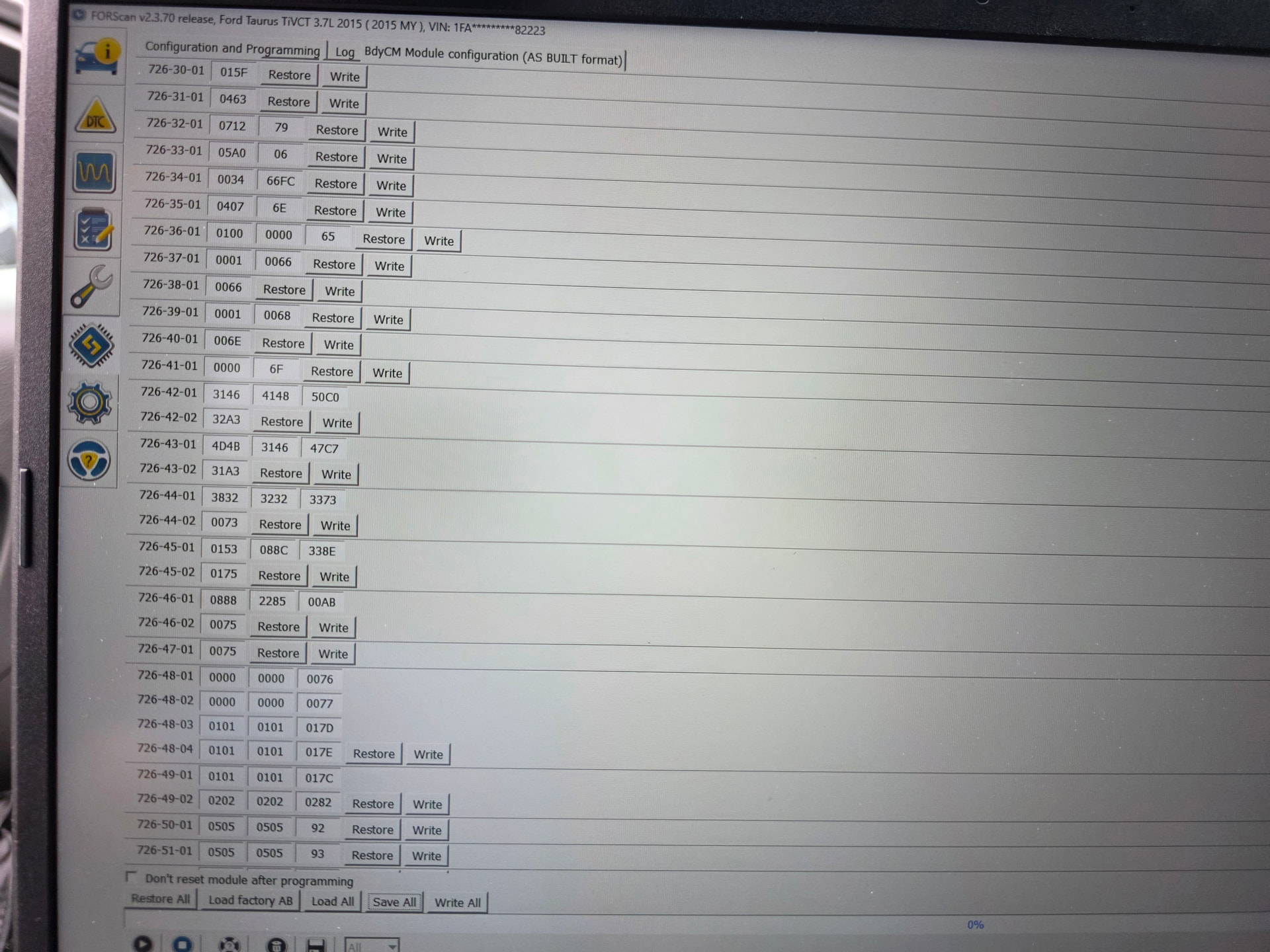

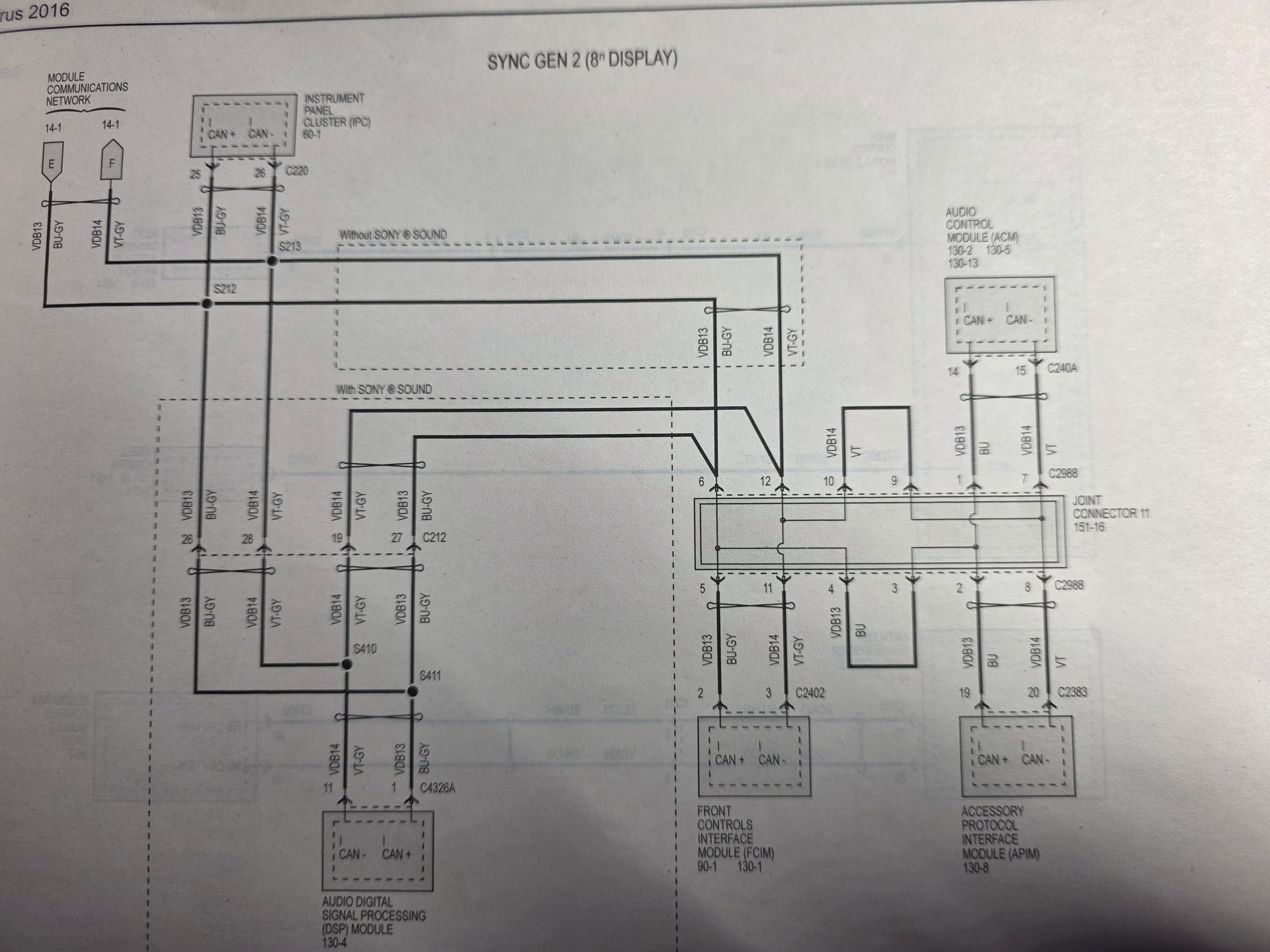

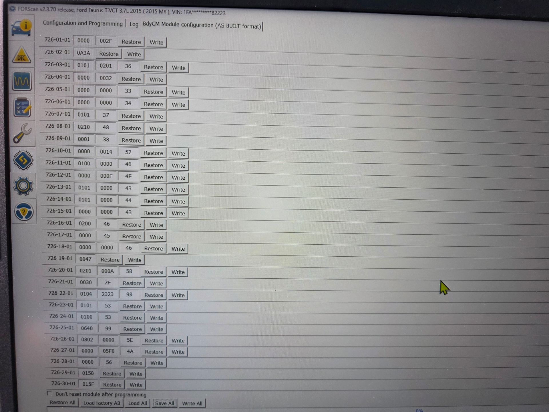

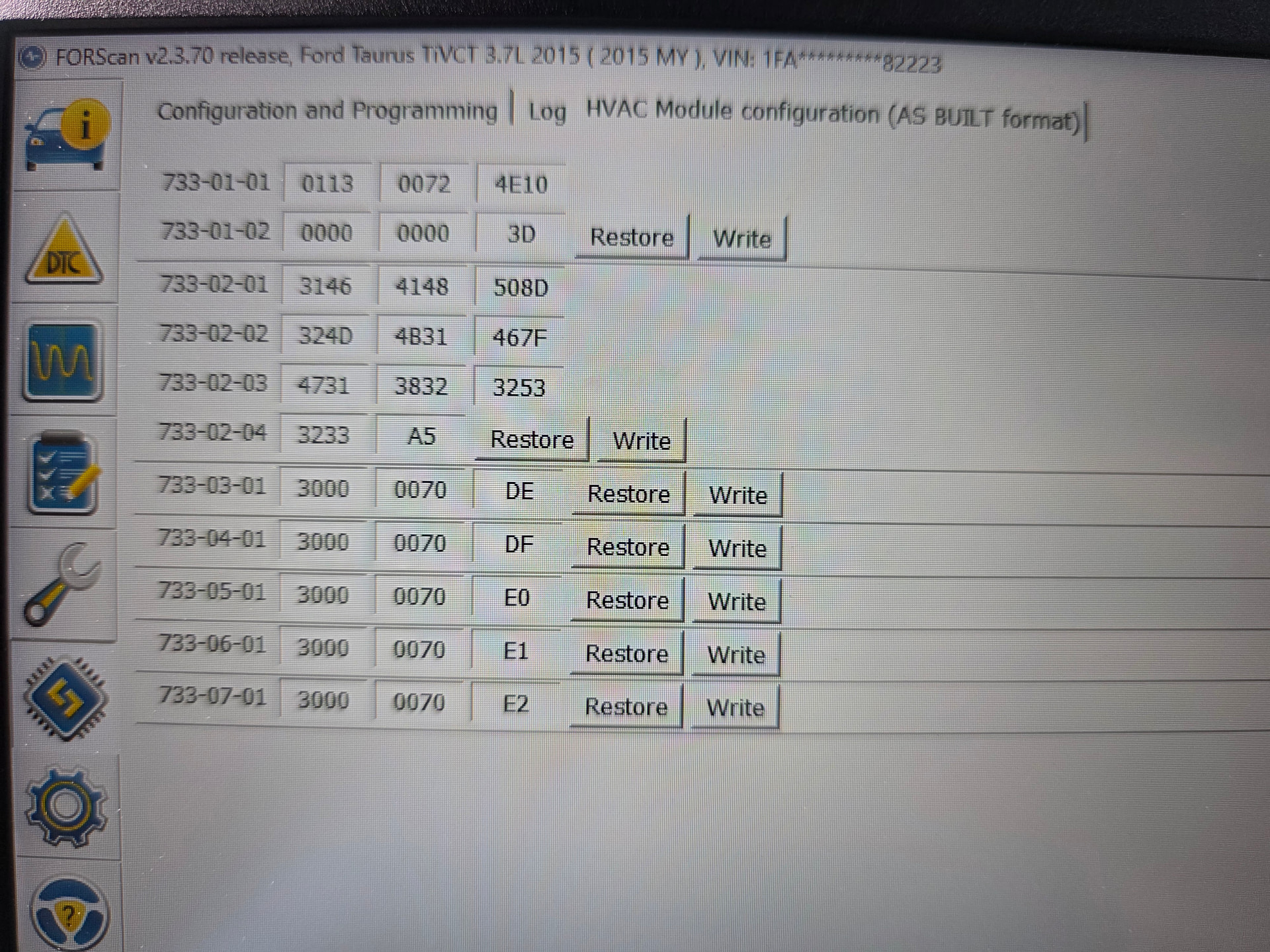

Apologies , been sick last few days. So I dont have an apim in the car currently. Its a no sync/syc 1? I had the sync3 in shortly but my hvac and vol did not work so i switched back. I will post the as built snippet of the apim from the ford download as well as anything i thought might be of interest from my car. 2nd pic is of apim from donor car.
I only need the AB from the APIM that is having the issues you discribed. None of the other settings and modules matter. Nothing should be coming from the Ford website or anywhere else.
Ok, understood. I will have to do it when I install it in again. Probably this week. Thank you.

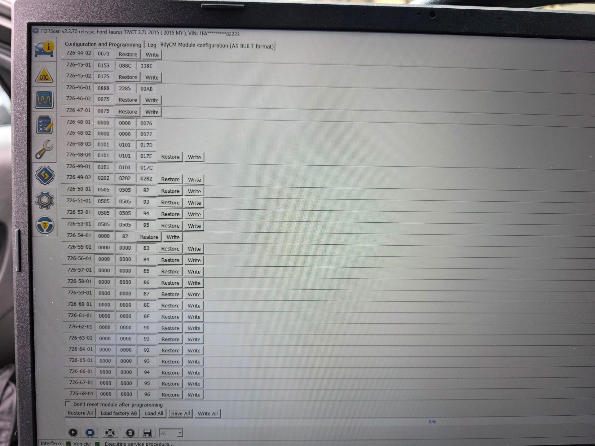

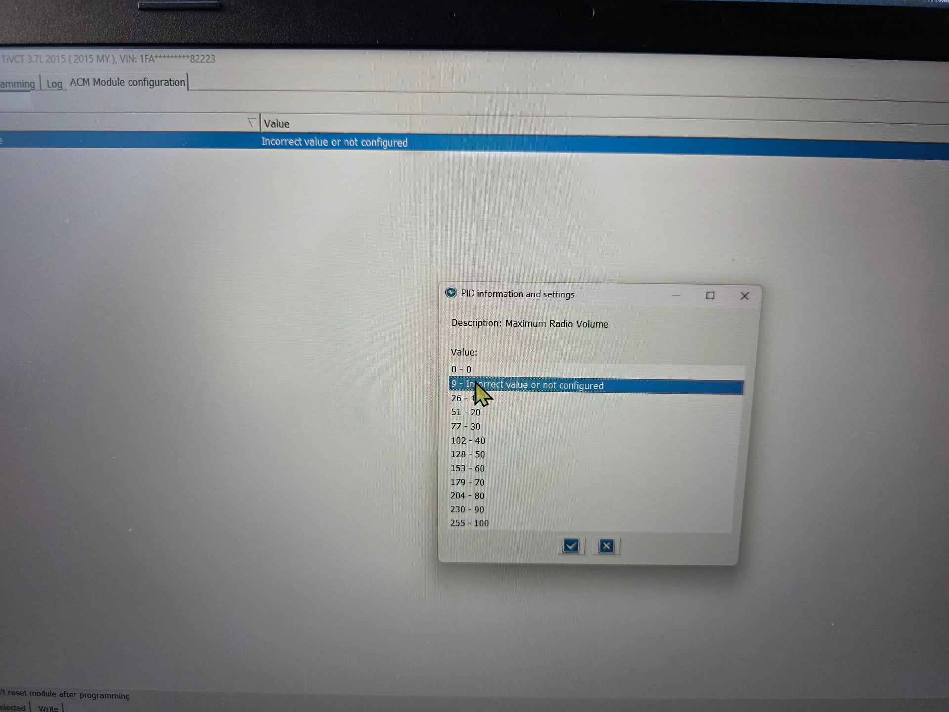

So I have installed everything again but scanning with forscan does not bring up the installed apim. I guess something else needs to be changed in another module first? I am confused since every video ive seen does not mention this. I did find an error in the acm regarding volume but no other selection makes a difference.

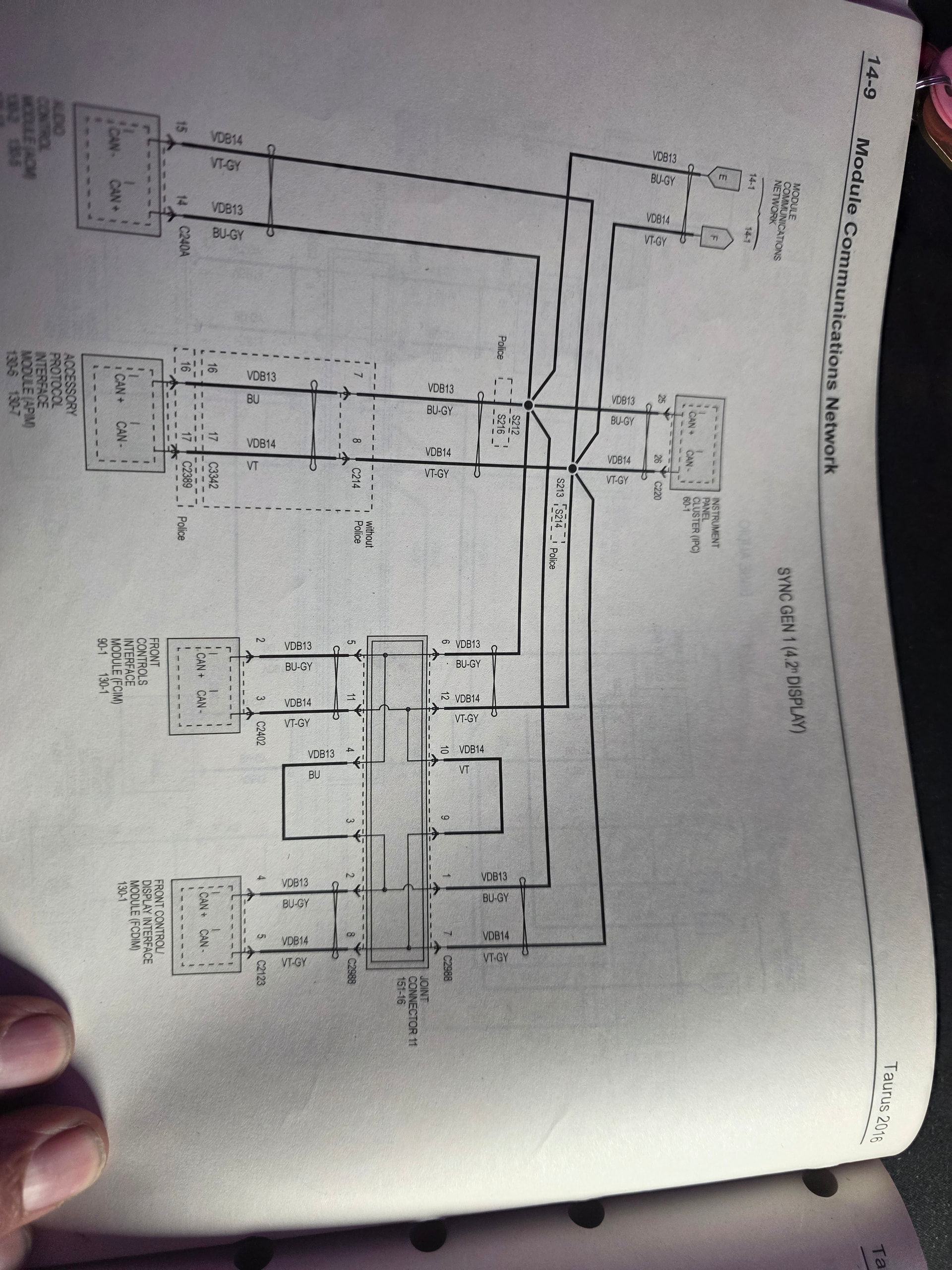

So doing a little research it would seem that I only have I-CAN lines going to the apim. Unless i am mistaken you need MS-CAN lines for sync3. Can I add those somehow?
Yes, The MS can is what the HVAC unit should be on also. That could be your issue for sure.
