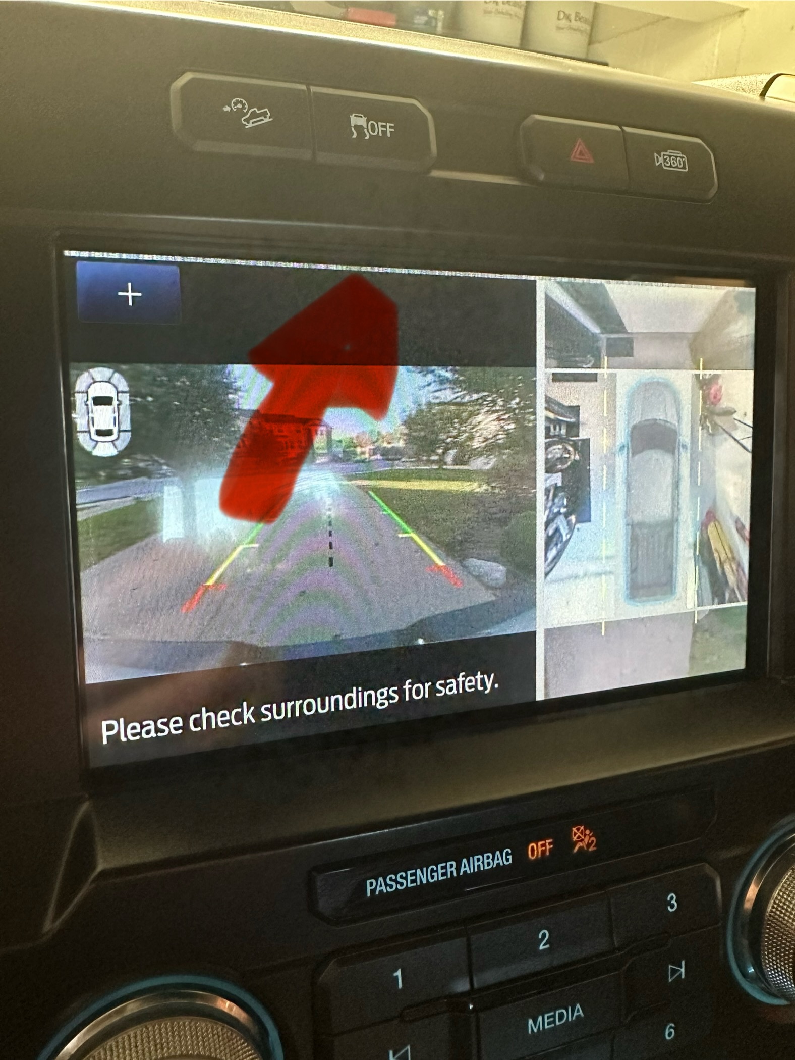

Hi - long time listener, first time caller. Recently converted to Sync 3 from Sync 2 in my 2015 F150 Lariat. Used an asbuilt from a similarly equipped 2016 model year variant as a baseline and everything seems to be working as expected. Only issue I’ve noticed is when the camera screen is active there is a thin line at the top of the screen and appears distorted/corrupted. Line/Distortion was not present with the Sync2 APIM. Thoughts on why this line might be present, possible as built error or conflict? Thanks in advance!

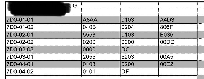

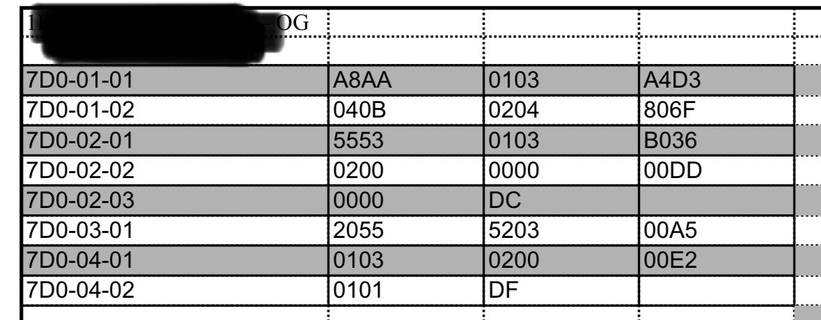

Sync 2 as built:

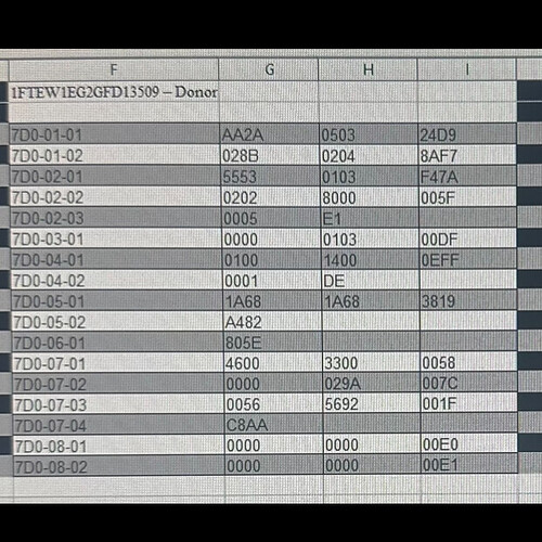

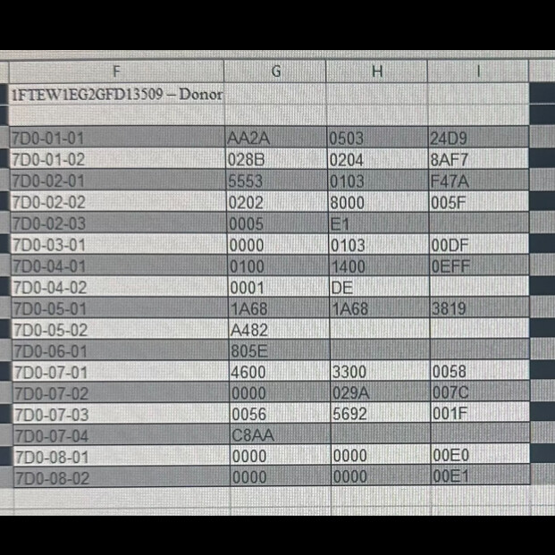

Current Sync 3 as built from donor VIN:

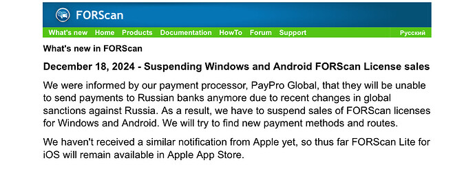

Bummer timing, appears paid licensing is suspended unfortunately. Hopefully resolved soon.
