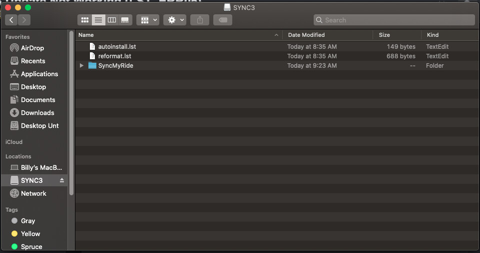

Put the autoinstall.lst in usb root

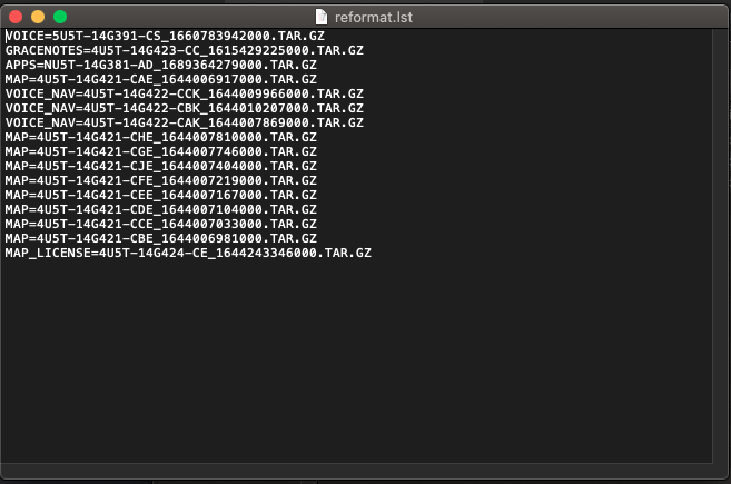

Put the reformat.lst in the usb root
Made SyncMyRide folder

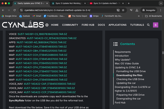

Downloaded newest updates

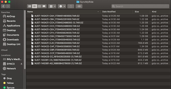

Drug them individually over to SyncMyRide folder

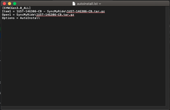

Can you share the autoinstall.lst and reformat.lst files?
I see a lot of (1) in the file name under SyncMyRide, that’s not good.
Double check autoinstall and reformat lst files point exactly to the correct files, correct the file names under SyncMyRide folder if needed.
I’m not a Mac user, but if the files end with .ext.ext, there are no other extensions hidden regardless of what the “kind” column says?.
I see the 3 (1) in the file now. I am going to rename those and try it again
That will solve part of the issue, but it still wont work because you are missing the 14G386-CB file referenced by the autoinstall.lst file… it’s not in the SyncMyRide folder, so please review the guide and make sure all files have been properly copied. All files referenced by both .lst files must be correctly placed and named.
I do not see the 14G386-CB file on the list of Tar.Gz files. This is after clicking NA (North America), Sync 3.4.23188 (newest) , and then 2.24 maps.
Found the link for the 1u5t-14g386-cb.tar.gz.
I downloaded it and put in the the folder titled SyncMyRide. Not in the root of the USB

Cleaned up all the (1)
