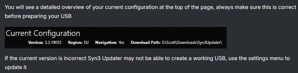

Hello There:
Configure the tool correctly as NAV and redo the USB → Basic Usage - CyanLabs

Hello There:
i think i did
You didn’t, the log specifically says “navigation: false”, you didn’t include maps.
Your current build. Again, please read the basic guide, it’s pretty well documented:

I do not want to sound like a broken record but you need to read the instructions, you are making this harder than it should.
These are the downgrade instructions → Downgrade Mode Instructions - CyanLabs
You interrupted the process between points 2 and 3.
Insert the USB again and let the process end, READ AND FOLLOW THE INSTRUCTIONS.

shoot ok. now ill set it to the version it shows which is now 3.3.19052 and load the foles to the dongle and redo. Im sorry for this. Thanks much for all the help!
