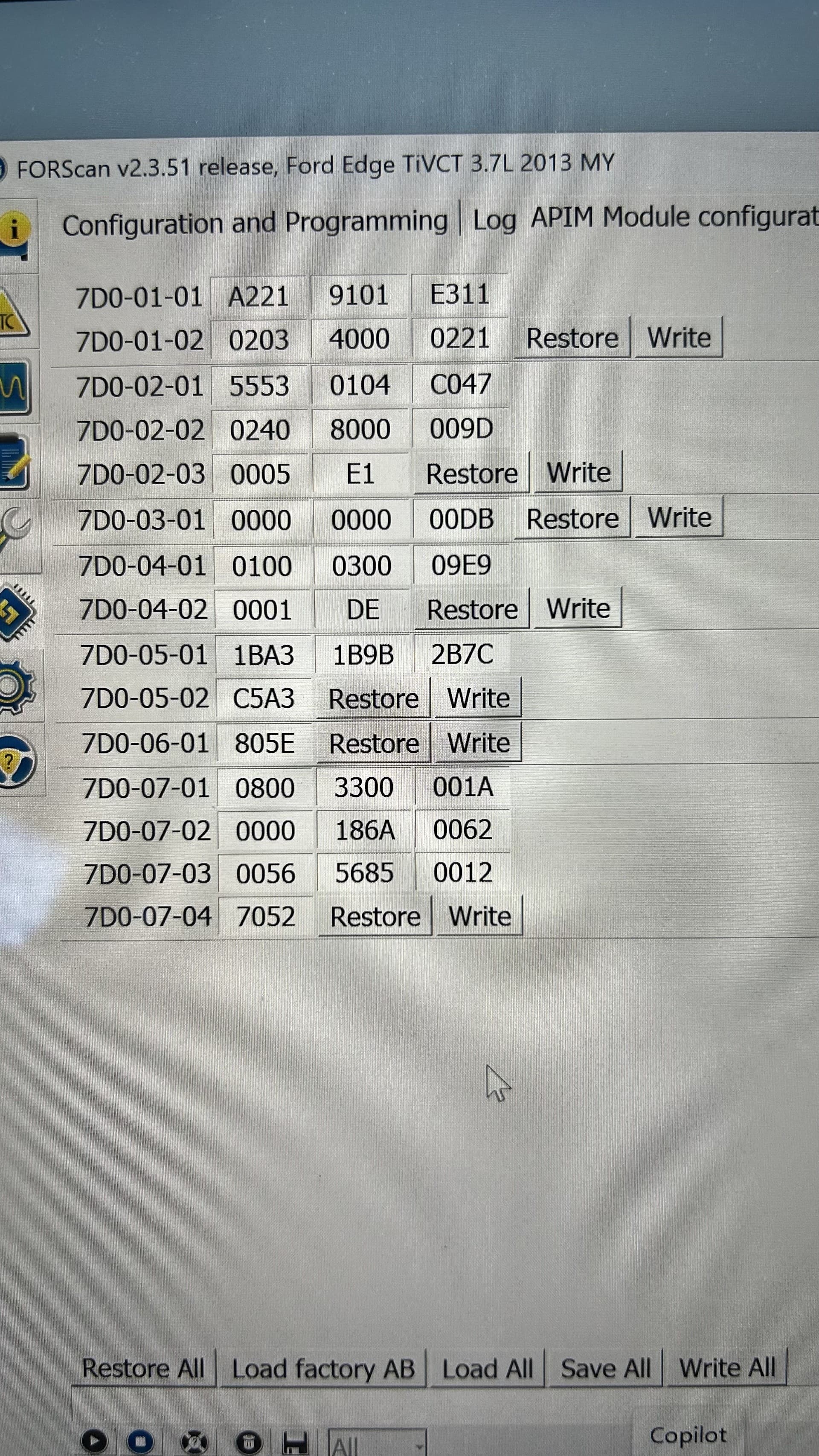

I have a 2013 Ford Edge Sport. I purchased a Sync 3 upgrade kit (SYNC 2 to SYNC 3 3.4 Upgrade Wireless Carplay Kit Fit for Ford Sync3 APIM NA223 | eBay). Everything works (sensors, etc.) aside from the OEM rear camera. I get a blue screen for a few seconds and then it goes black - and says the camera is not available and to contact the dealership.
Install Type: Replica
Old SYNC Version: 2.0
