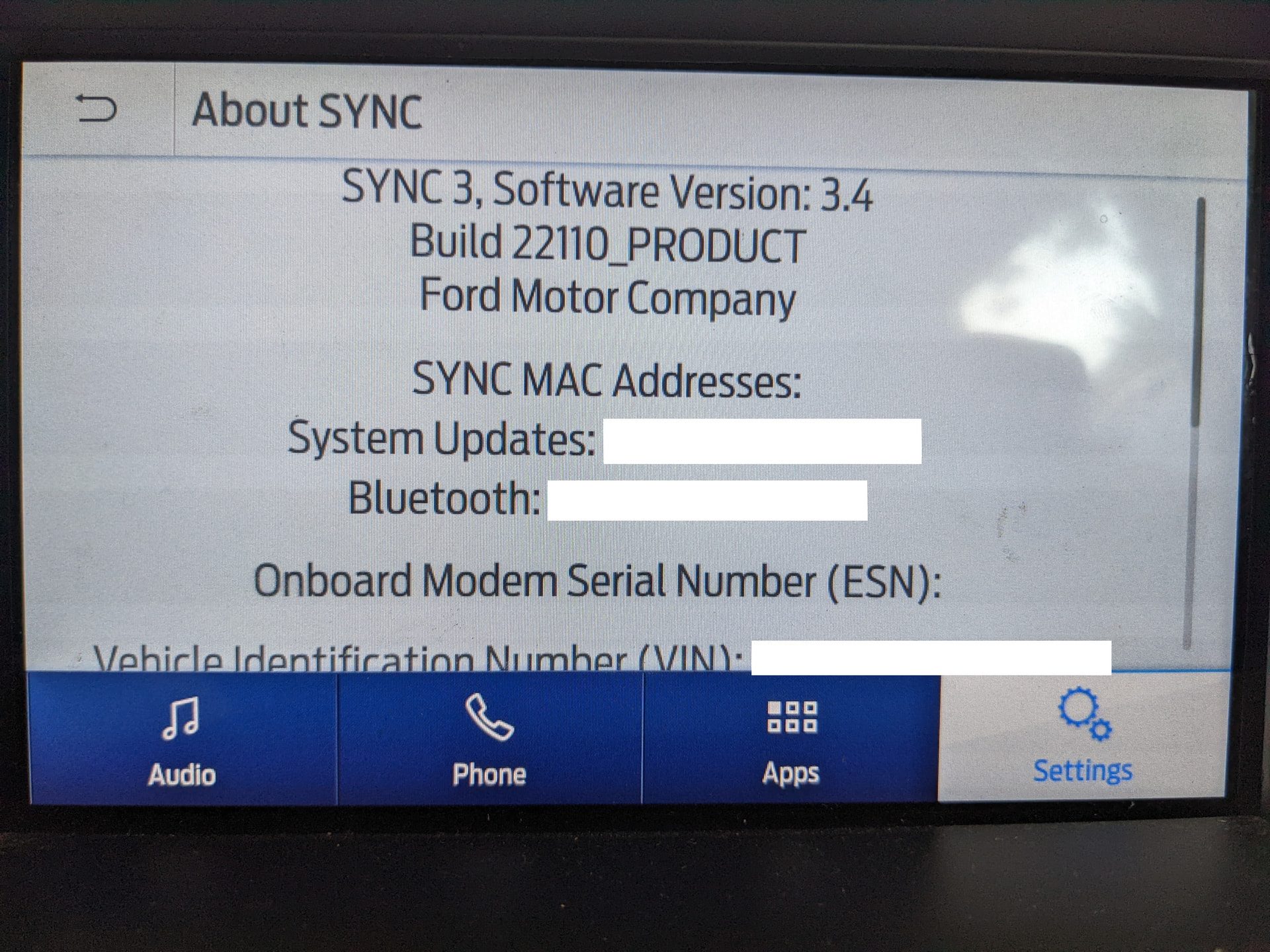

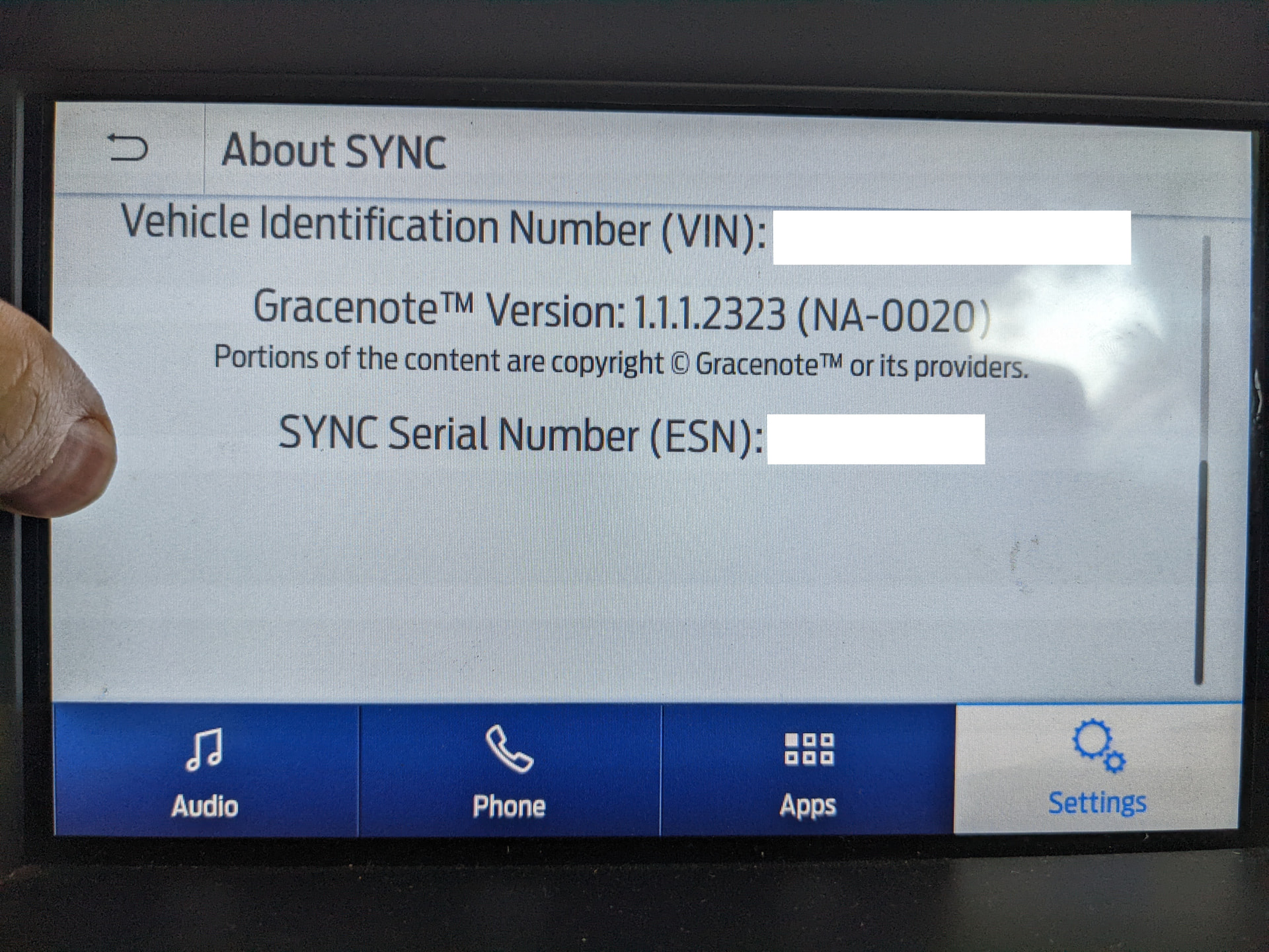

Hi, I’d like to add a CarPlay-compatible hub to a 2016 Ford Cmax Energi. Last year I updated the software from 3.0 to 3.4 and now have that annoying “Unsupported Hub” error.
The PN on my current hub is GC3T-14F014-BB.
From what I’ve read on this forum and elsewhere, the HC3Z-19A387-D/E/F would all be suitable replacements, with the E variant being the favorite.
Is this correct? I want to be absolutely certain before buying something I can’t return.
Also the form asks how I updated but it was over a year ago and I don’t remember.
Screenshots attached.
Old SYNC Version: 3.0.18093
New SYNC Version: 3.4.2210
“USB Hubs are not supported. Please Remove”
