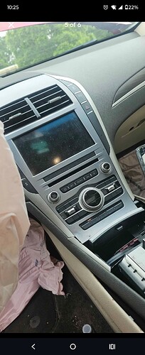

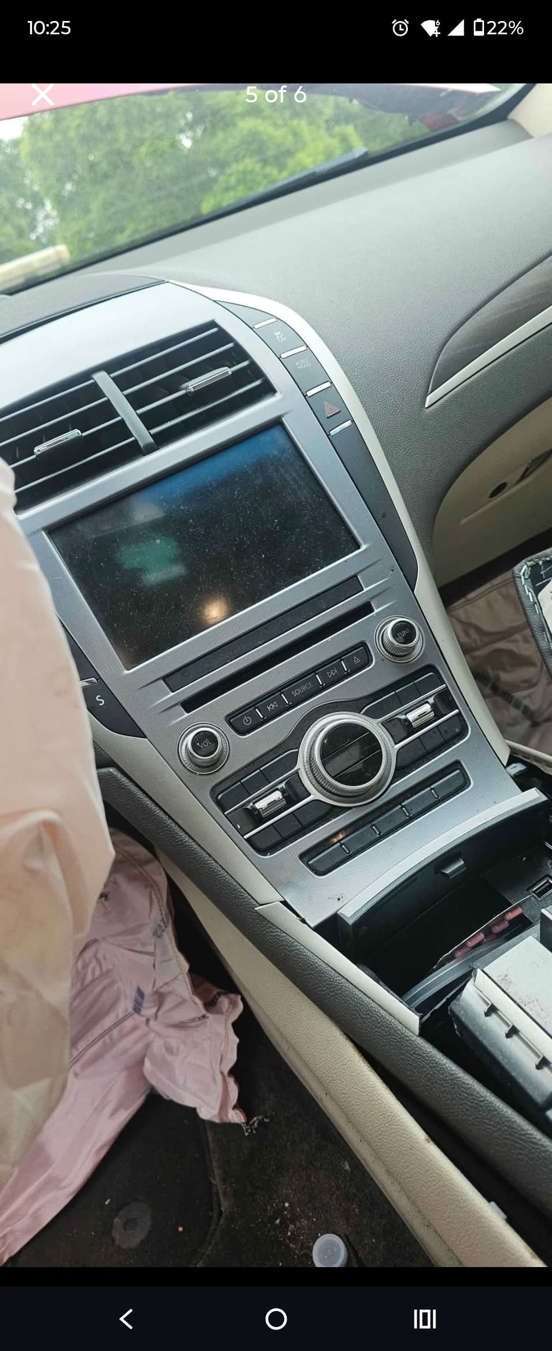

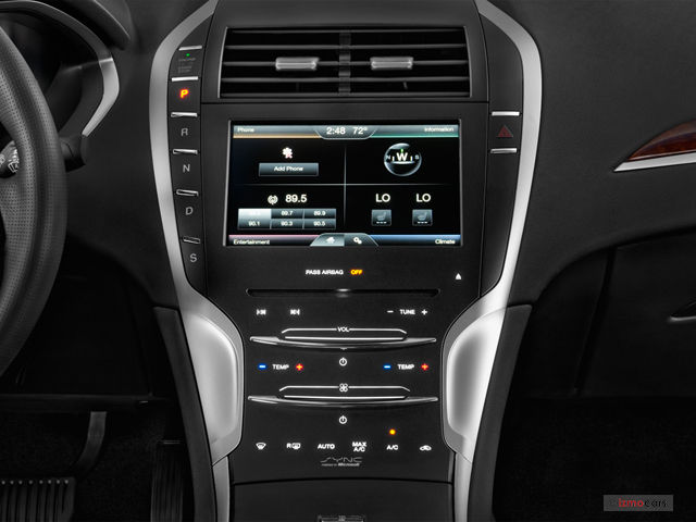

Sorry if this has been asked before, but I couldn’t find anything on it. I’d like to swap my center climate controls/radio controls with one from a 2017+ MKZ. The touch controls are neat but I’d rather just have buttons/knobs. Has anyone tried doing this?
Pics below of what I want to switch the above to, I realize I might need to do some cutting but I think it would be worth it if it’s all plug in play in the back.
Its just like doing a 2013-2015 Fusion to get rid of the cap touch buttons.
You would drop the 2017 unit in and them load your vehicles factory AsBuilt into the unit.
