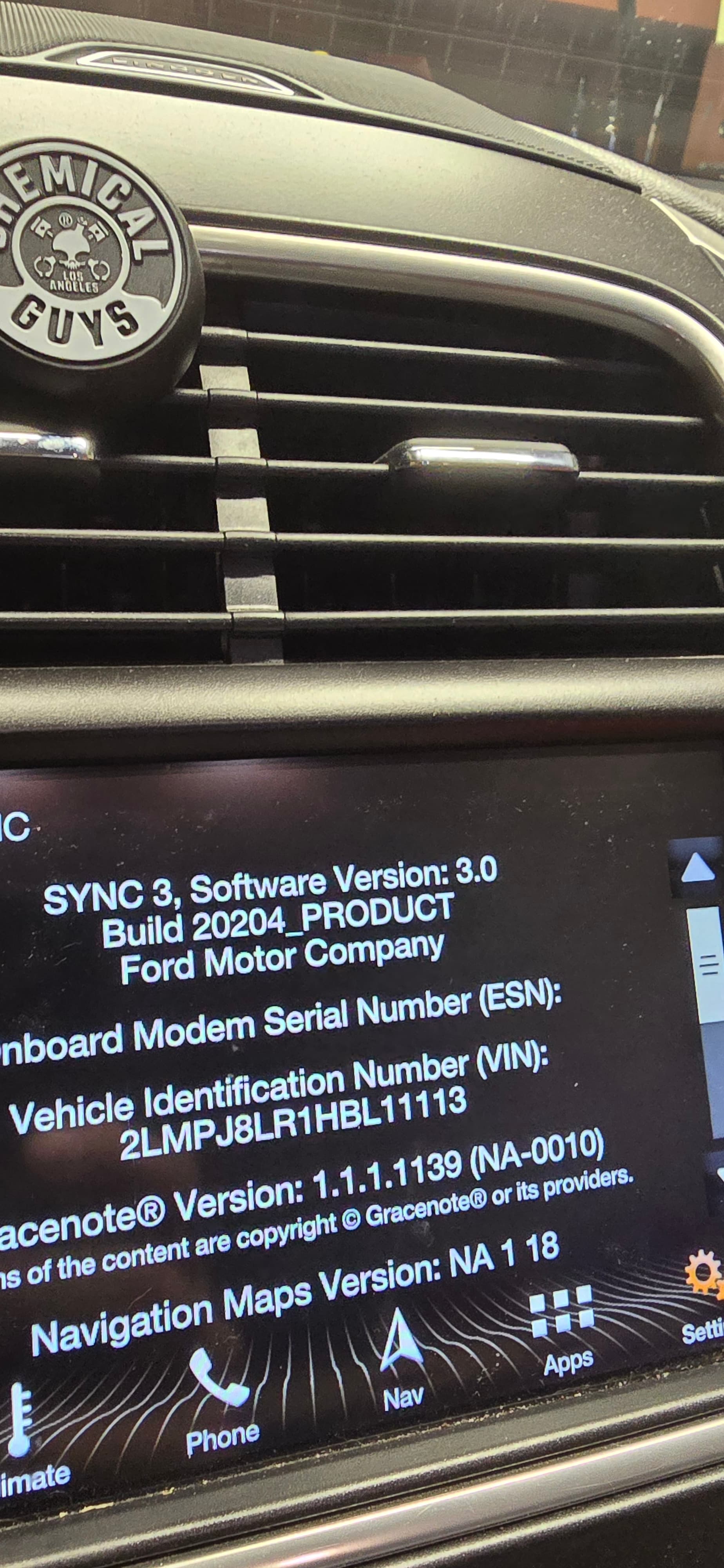

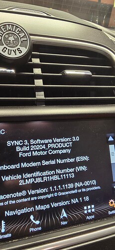

3.3 or 3.4 will work. If you are on Sync 3.0 this may not work, as that does not support HS4 CAN.

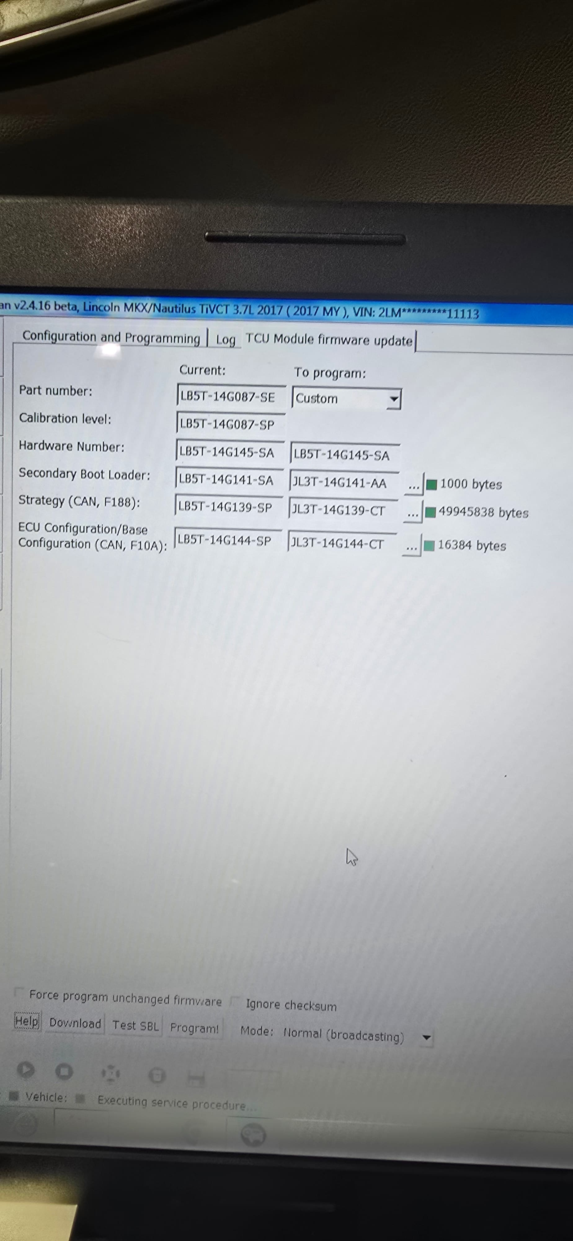

Right column are the files required to get that L series downgraded to a J series.
I did this with an L series last week that I dropped in a 2017 Fusion Ti.
You have to do this as a custom, it took 57 minutes with an OBDLink EX.

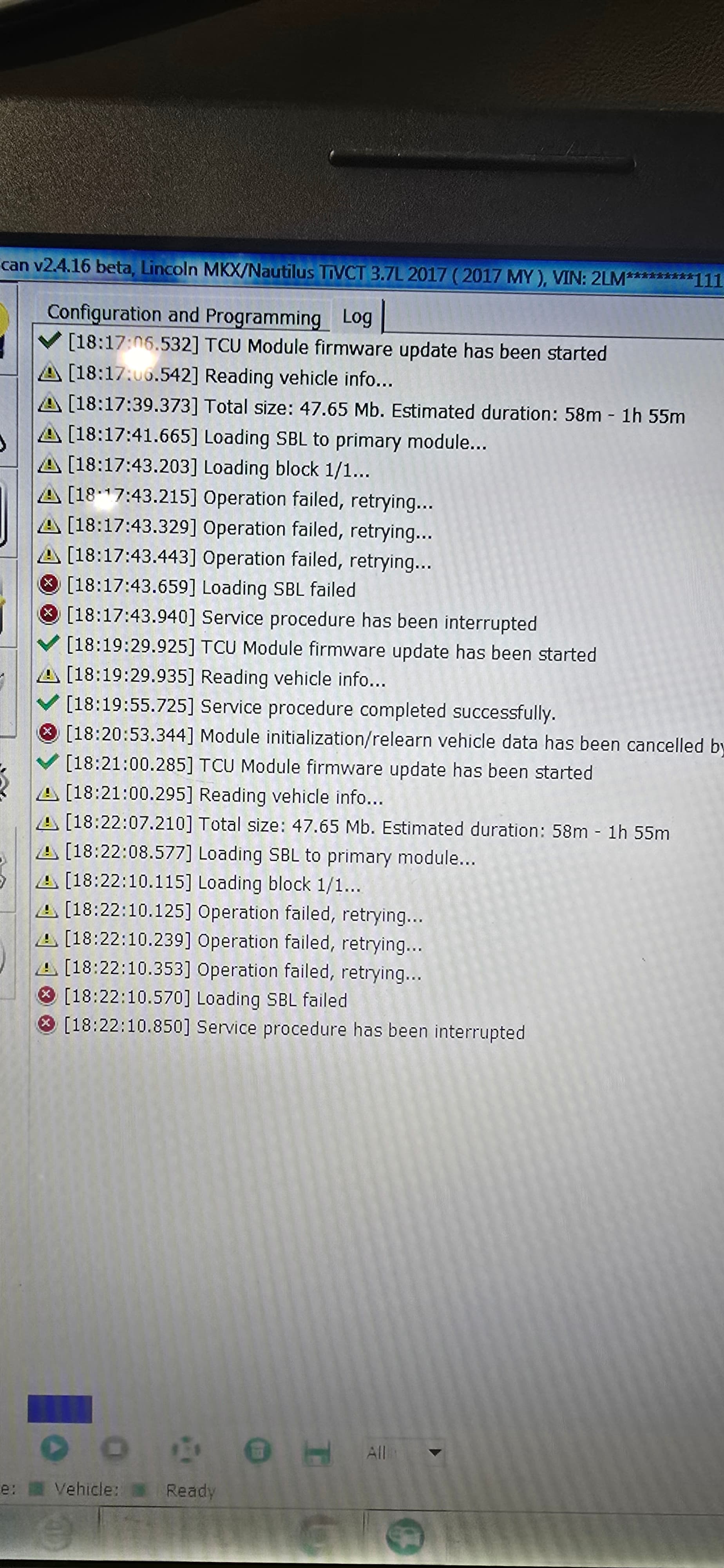

I can give that a try tonight when i get home, but the big issue i ran into was loading the SBL, it was a prompt failure at that point, and if i remember correctly the calibration level is not there im custom correct?
Correct and when you start ForScan you do this without a saved profile.

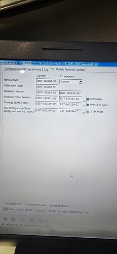

What options on the bottom are you checking before you start?
Does is pass or fail the SBL test?
Options we tried as seen in picture above, and with the force program and ignore checksum on all options ended in SBL load failure
I also tried it with jx7t firmware and again had an sbl load failure
