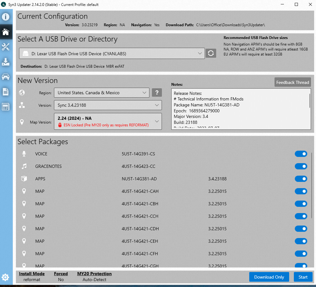

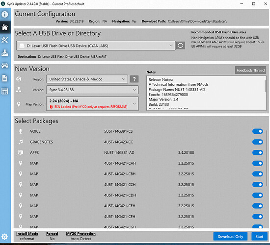

and here is my USB log you asked for. Ill wait to hear, and then go install.
Version: 3.0.23219
Model: SanDisk Cruzer Glide USB Device
FileSystem: FAT32
Partition Type: GPT
FILES (17)
[1/24/2026 1:18:48 PM] Selected Region: NA - Release: Sync 3.4.23188 - Map Version: 2.24 (2024) - NA
[1/24/2026 1:18:48 PM] Install Mode: Auto-Detect (reformat) Forced: False
[1/24/2026 1:18:48 PM] MY20 Protection: Auto-Detect
[1/24/2026 1:18:48 PM] Formatting USB drive
[1/24/2026 1:18:48 PM] Re-creating partition table as MBR and formatting as ExFat on selected USB drive

That looks good, give it a go.
SUCCESS!!! Thanks so much.. beautiful new layout, new maps, everything seems to work. I really appreciate all the work everyone has put in.
You are welcome, enjoy it.
I’m closing the thread.
