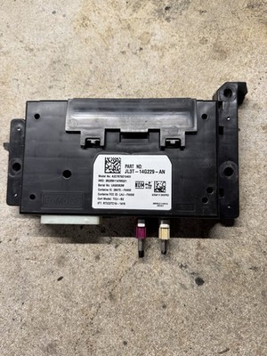

You can use a 14G229
The last 3 are the vendor that made the part, the last 2 after that are the mount style the unit was screwed on to at the factory.

Reading, reading, reading.. I don’t believe my 2017 has hot spot, and this looks like it has the 2 antennas. Does this mean I either need to get another antenna or deal with a DTC?
Very much appreciate your time.
The cream color isn’t for the hotspot, its for a 2nd cell antenna.
It will work without it, you’ll just have a DTC for an open secondary antenna. The cheap Bing Fu units won’t clear the DTC because the resistance is less than a Ford PIFA unit.
