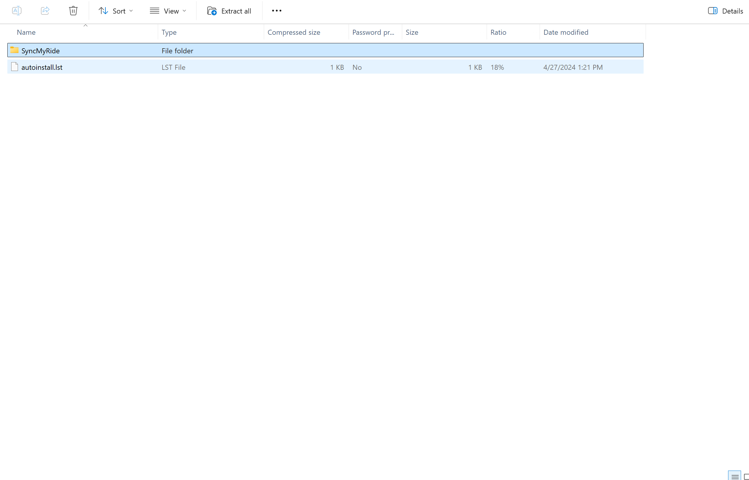

Share the autoinstall.lst file Ford sent your way.
I’ve tried master reset and it did nothing. I also pulled the fuse for 1/2 hour and that did nothing. I only used Syn3updater to pull the information, i know i have to do a manual install.
Here is the install file
; SYNC3 CD Assembly Upgrade - Release 2.3.13 - Only for NonNav/NonEU assemblies.
Item1 = JL7T-14G381-AL
Open1 = SyncMyRide\JL7T-14G381-AL.tar.gz
Options = AutoInstall,Delay,Transaction
I know its not a big leap in the system but i figured it would do it in steps.
Thanks

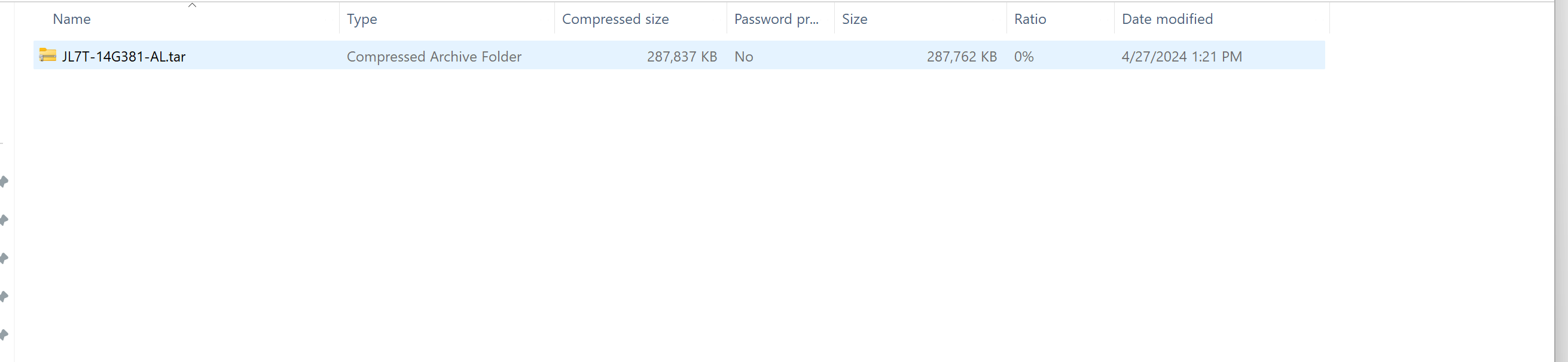

How big is the file that you are trying to autoinstall?. An apps only upgrade should take a couple of minutes, so it’s not doing anything …
I will have to get back to you on that, I’m away from my laptop. Maybe tomorrow or Sunday.
Sorry for the delay, here is an image of the file.
Would having MYKEY turned on stop any update from downloading?
Thank you, so it’s about 300MB.
About your question, no, as long as the unit is powered on, it should update without issues.
I’ve trying to find an alternate version for you to try for an 4 inch, but I’ve not been able to. We have JL7T-14G381-AJ listed in our db, but that’s the last one we have. Based on the naming convention I would think that’s also for 4 inch screens (size is similar). It’s also newer than the one you are currently running on the unit, but older than the one Ford pushed your way.
