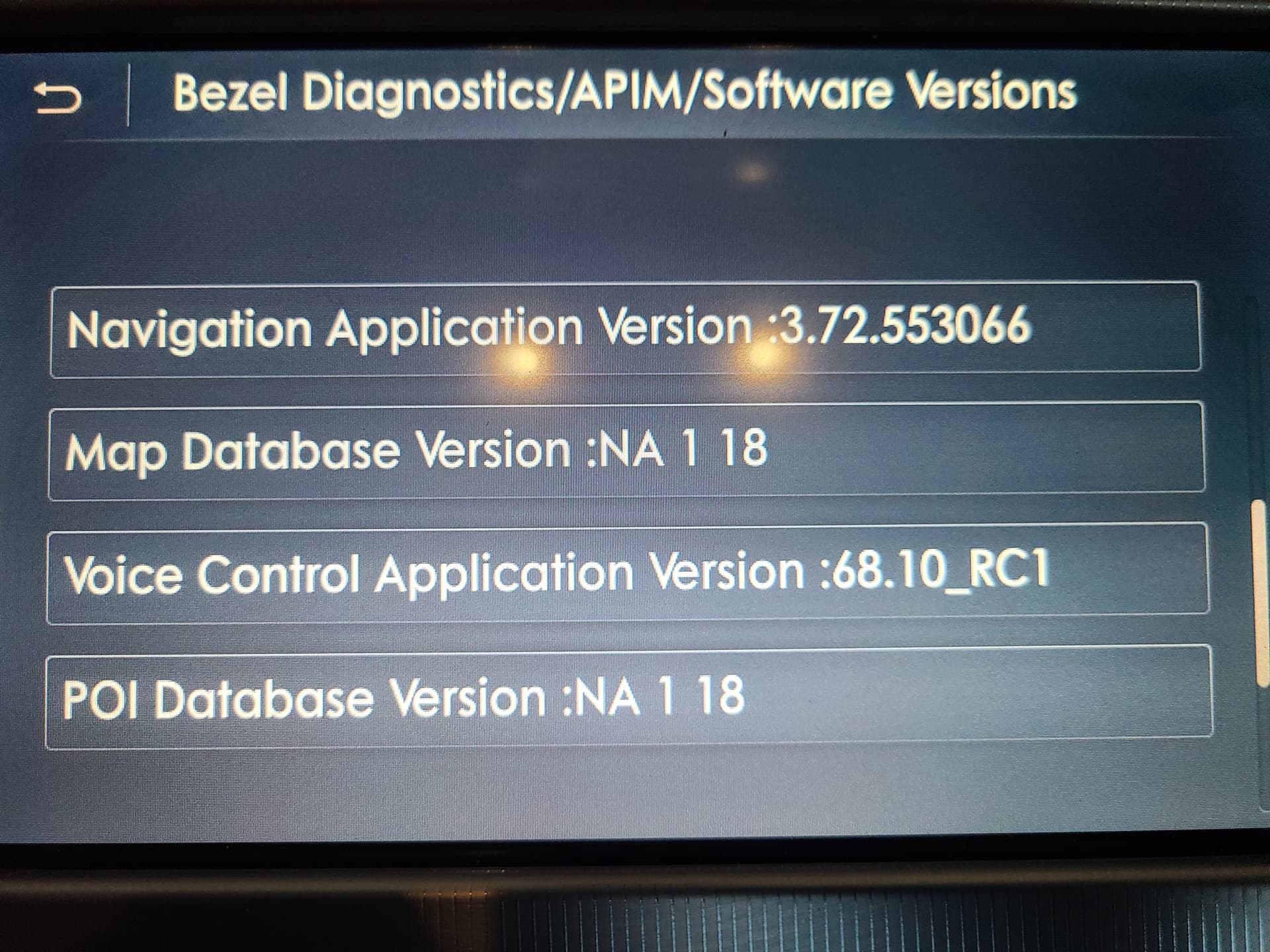

So I want to update the maps and Sync 3 in my 2020 Lincoln MKZ. I’ve read about the different install procedure only updating a 2020 APIM. It makes me kind of nervous to do. Don’t want to brick it.
BUT. Is it safe to assume this car doesn’t have a 2020 APIM since my latest maps are 2018?

I just thought it would have later year maps being it’s a 2020 car.

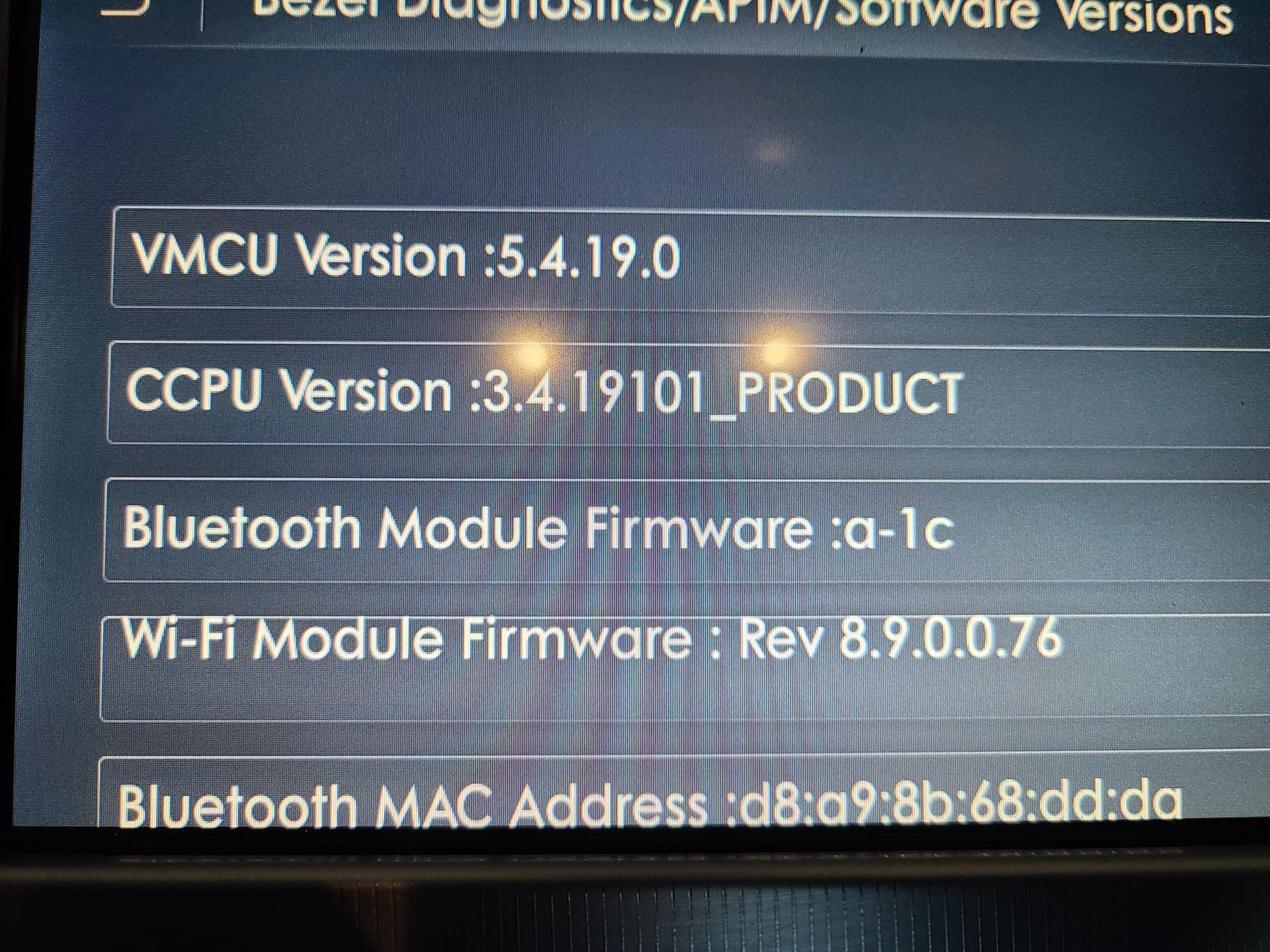

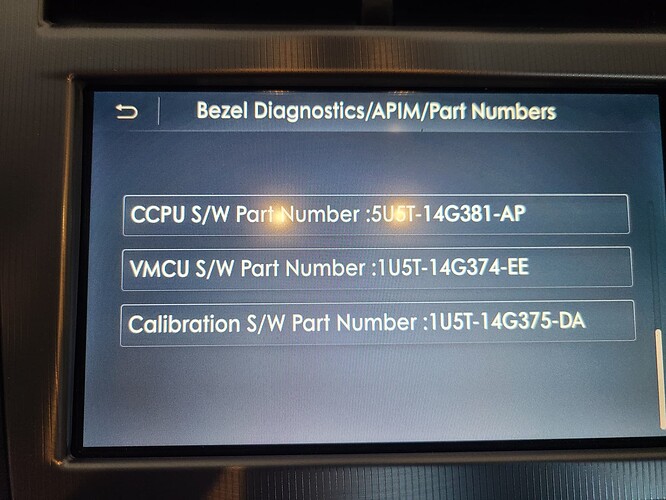

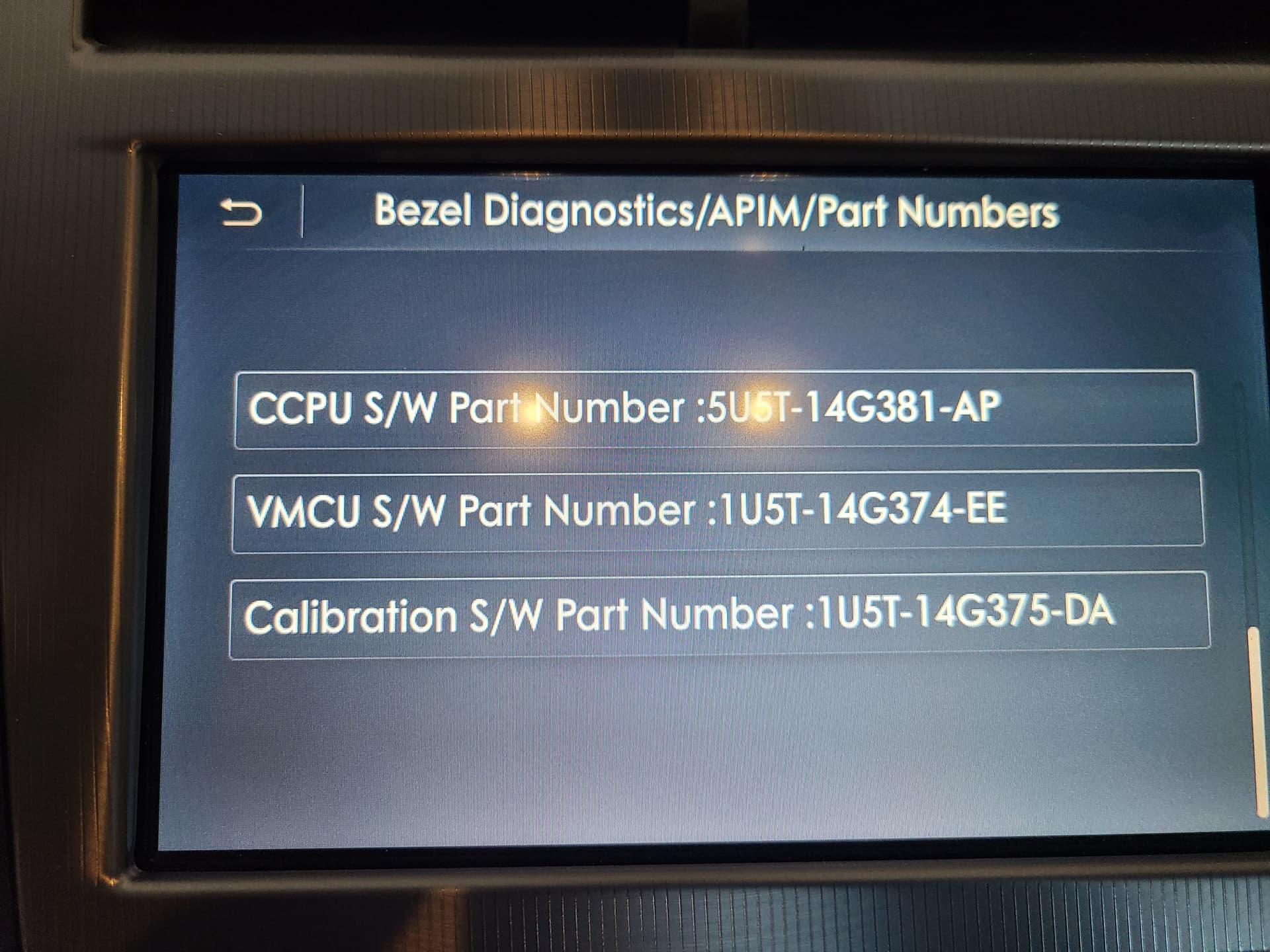

So, got in the diagnostics menu. Thanks for letting me know about it.

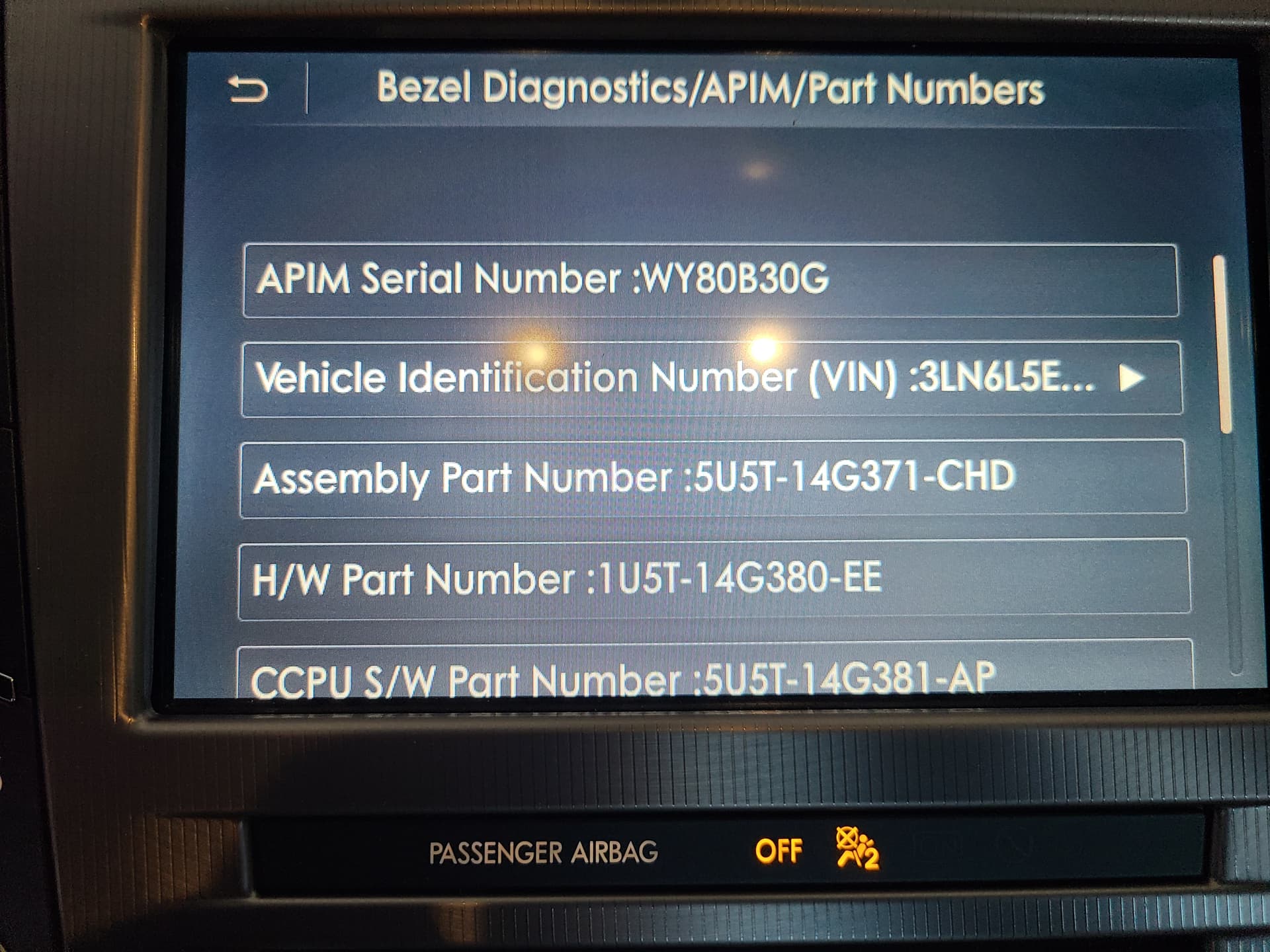

These are the specs on the APIM. Is this a 2020

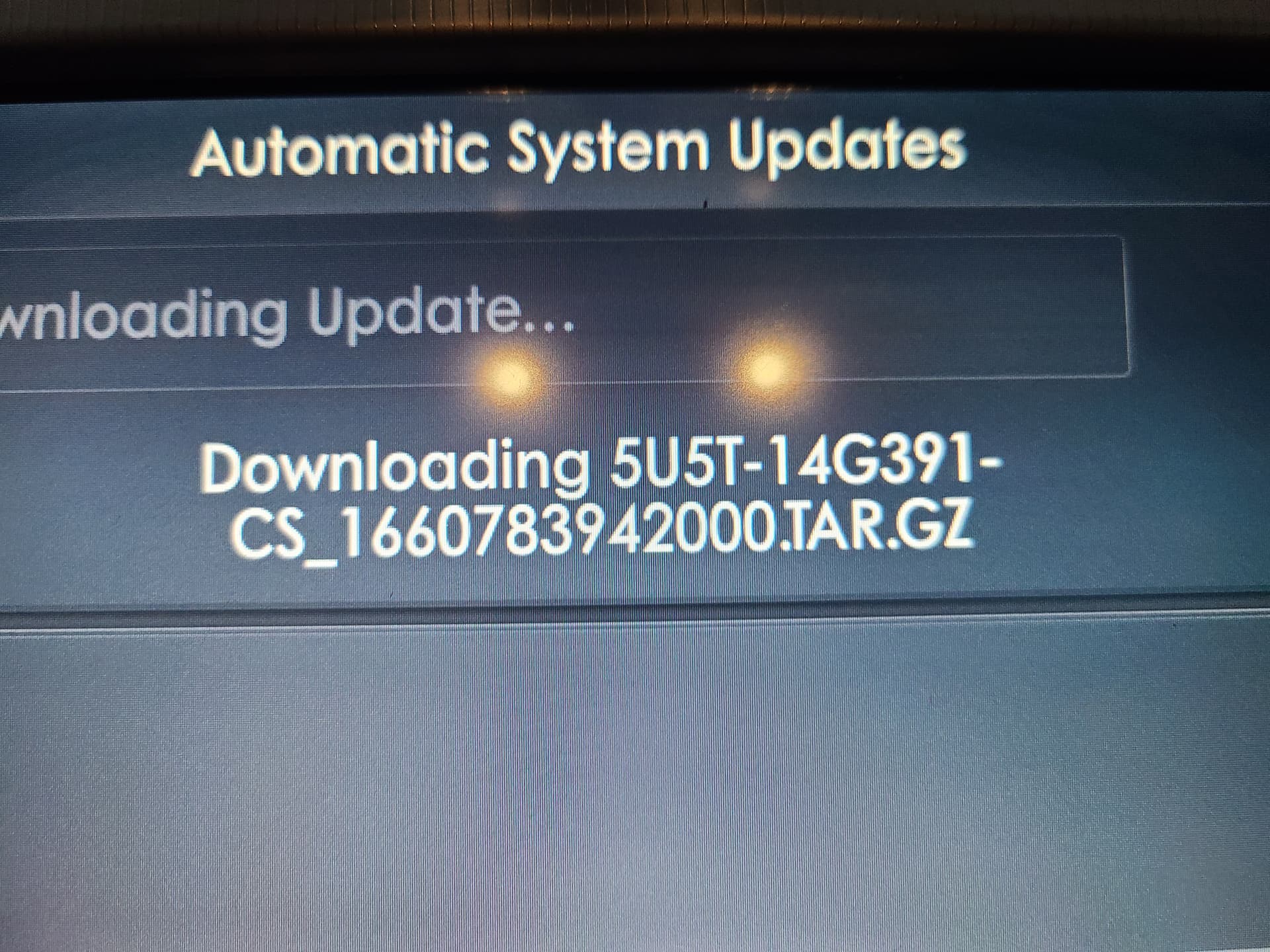

Looks like it wanted to download the latest sync over wifi too.
Yes, it is: 5U5T-14G371-CHD.

So I guess I should let the it update the Sync software over wifi and try updating the maps using Syn3 Updater?
I recommend reading the basic instructions → Basic Usage - CyanLabs
You can install whatever you feel like with syn3updater as long as it’s only autoinstalls. Keep MY20 protection active at all times., do not run other installations that are not autoinstall.
You won’t be able to update to the latest maps.
