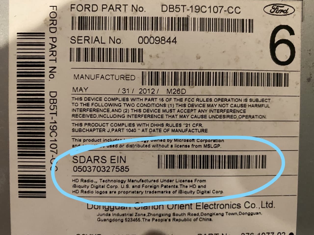

Part number is going to be xS7T-19C107-CC thru CM the first character will be D, E or F, any of these will work. The last character is the firmware/calibration revision, levels below E had a volume bug, you can update the calibration to M with ForScan once you have the ACM installed.
Actually with the right ACM, APIM and wiring you can.
you mean i just bought a DS7T-19C107-CB ACM and i was off by one freaken letter… grrrr argh…
In addition to the ESN an HD ACM will usually says it has HD on it…..

When you go to enable XM, you’ll need to give them the ESN of the donor ACM not your VIN. If you already have service in the car they usually charge $30 to flip it to a different ESN.
