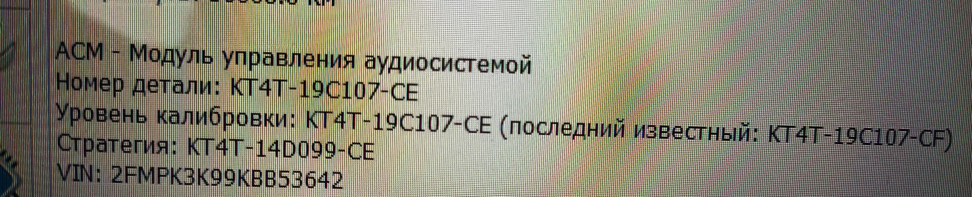

The best way to determine the if you have the right ACM for ANC is to first get the VIN for the ACM you want. Then run the AB with Fords AB database to see if it has ANC turned on in the AB settings.

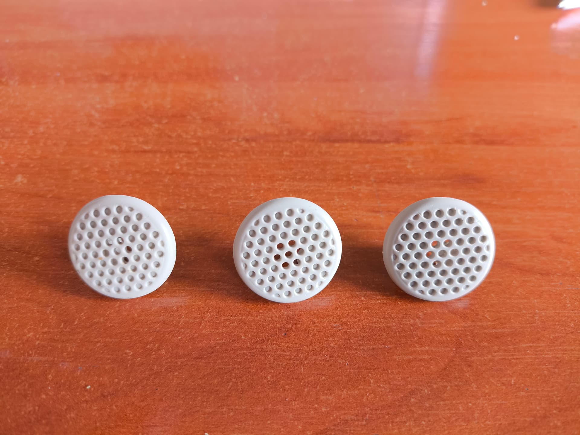

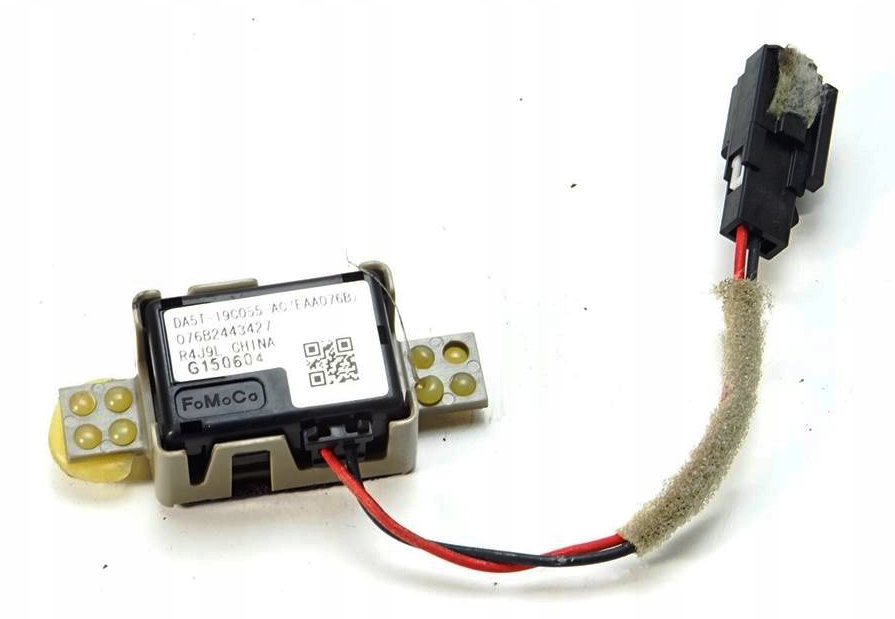

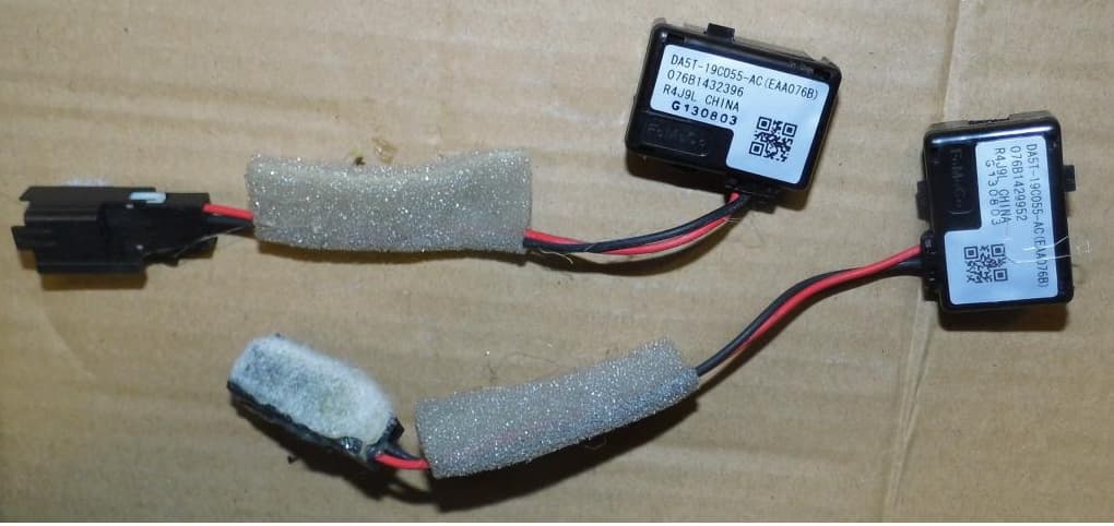

I understand that. That’s why the microphones were purchased and they will be added to the ceiling. I thought there was a list of ACMs somewhere that support this feature.

Do you have the VIN for that ACM?

I am not looking at the ACM Warlock so stop over complicating this. I asked for the VIN for a reason. You look in the AB to see if it contains the 7D5 lines and if it does then you know the ACM has a DACMC chip.
Not everything in this world revolves around a Fusion either. No one mentioned an external DACMC so why even bring it up? I know what this guy is doing because I have done it. So unless you can help him find an ACM that contains the DACMC chip than stay out it. He is not asking how the birds and the bee’s work.

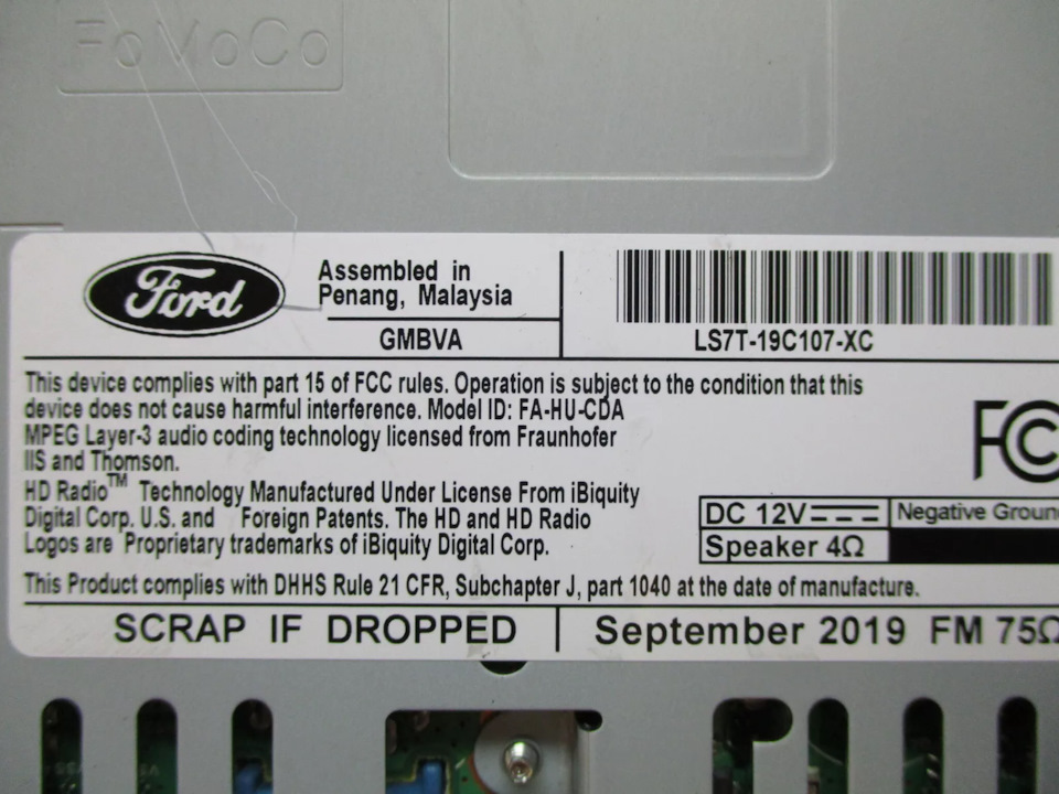

KT4T-19C107-CE does not have active noise control. Meaning interior sound level feedback.
You need the KT4T-19C107-DE.
Thank you very much, this was the main question. It has been fully answered. So I will change mine to this one.

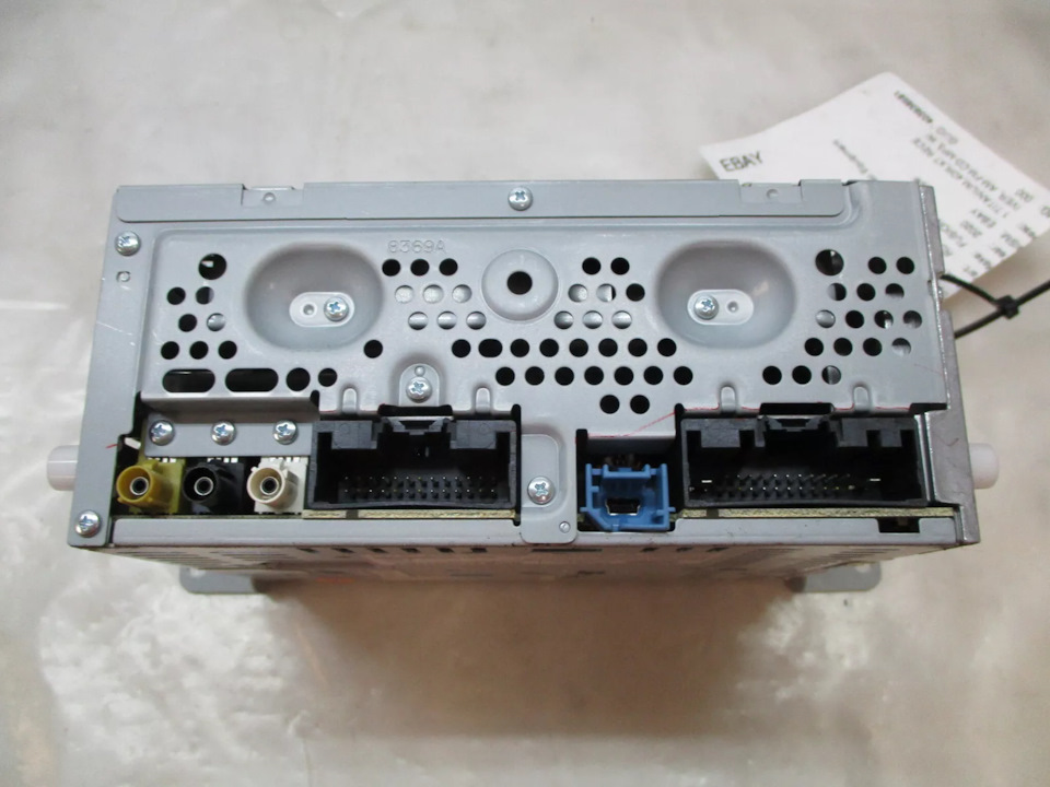

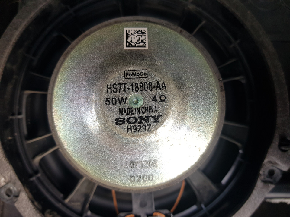

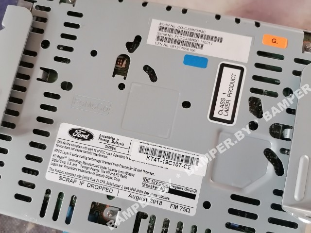

Keep in mind that unit has an A2B connector on it since the 2020 FusionTi /MKZ HEV/PHEV used the Sony or Revel.
That unit also has an X40 Sirius XM IC in it.
The back side is the same as mine.
Would have been a lot easier if you had told us the ACM or the model/year of the car.
If you don’t need the X40, you can also use HS7T-19C107-XB & KS7T-19C107-XB

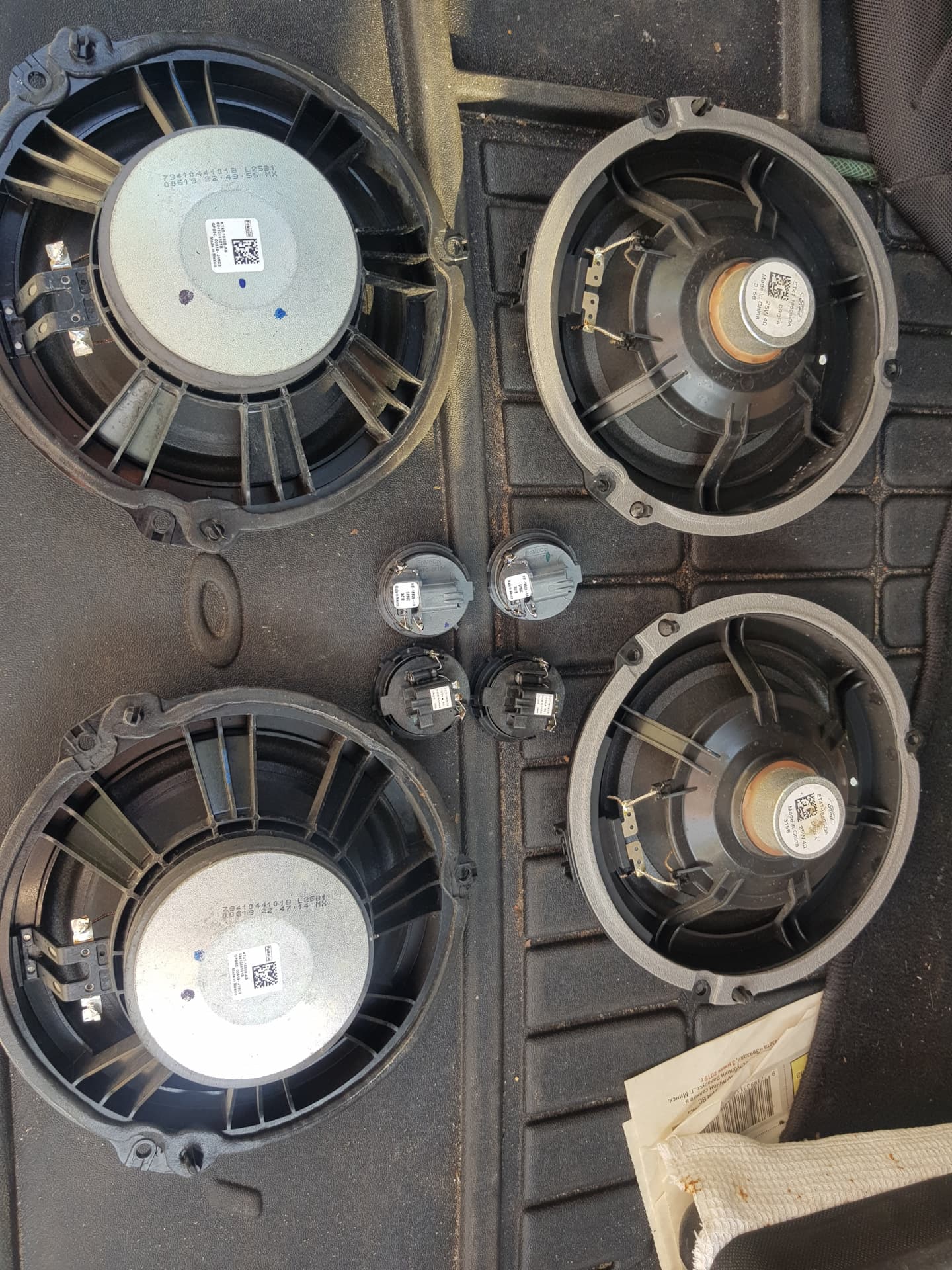

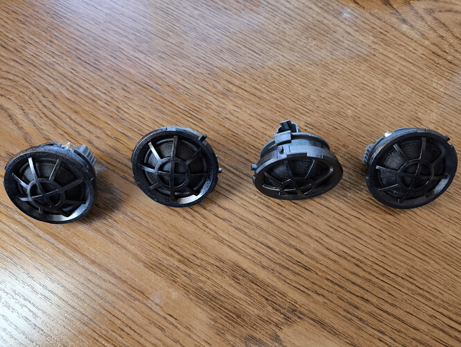

I have BANG & OLUFSEN, which is the most complete. 12 speakers. The rear ones have been replaced with good ones. If anyone is interested, I’ll show you.
I didn’t know until a certain point that B&O was just a beautiful inscription. If the front ones are still tolerable, then the back ones are no good.
Each door was equipped with
I didn’t change the other speakers or the subwoofer.
As a person who is not particularly demanding of sound, I immediately felt the difference in the sound of some compositions.
I am satisfied. The money was not spent in vain.
