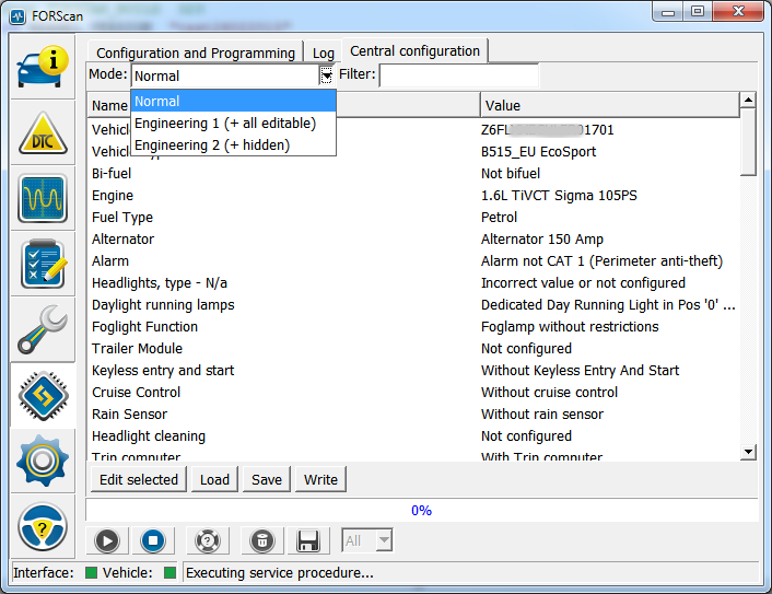

To solve the issue, you need to use forscan and access the ‘central configuration module’. Remember to enable the ‘engineering 2’ mode to be able to modify all values.
Then you need to modify the following data:
[Name]: OLD value → NEW value
Bluetooth handsfree: 08 - SYNC G1 BT-Phone BT-Audio → 09 - G2 Sync 2/Sync 3
Touchscreen: 06 - Dispay with no Touchscreen, Colout-TFT MFD 5 → 09 - Front Display DM8 with nav
Then write the file and issue solved!
