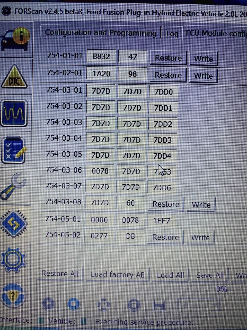

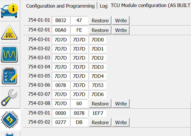

Looks like the deltas between the updates Energi and the Hybrid are:
754-02-01 1A20 Hybrid 00A0
754-03-02 7D7D 7D7D 7D Hybrid 7D7D 7C7C 7C
754-03-03 7D7D 7D7D 7D Hybrid 7C7C 7C7C 7C
754-03-04 7D7D 7D7D 7D Hybrid 7C7C 7C7C 7C
754-03-05 7D7D 7D7D 7D Hybrid 7C7D 7D7C 7C
754-03-06 0078 7D7D 7D Hybrid 7800 7D7D 7D
The 754-05-01 & 754-05-02 are missing entirely from a factory H TCU with -xM calibration
If I remember right this was the difference between the Canadian and US TCU’s on the Plugin. Been along time since that came up.

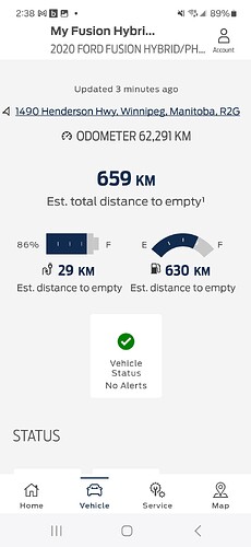

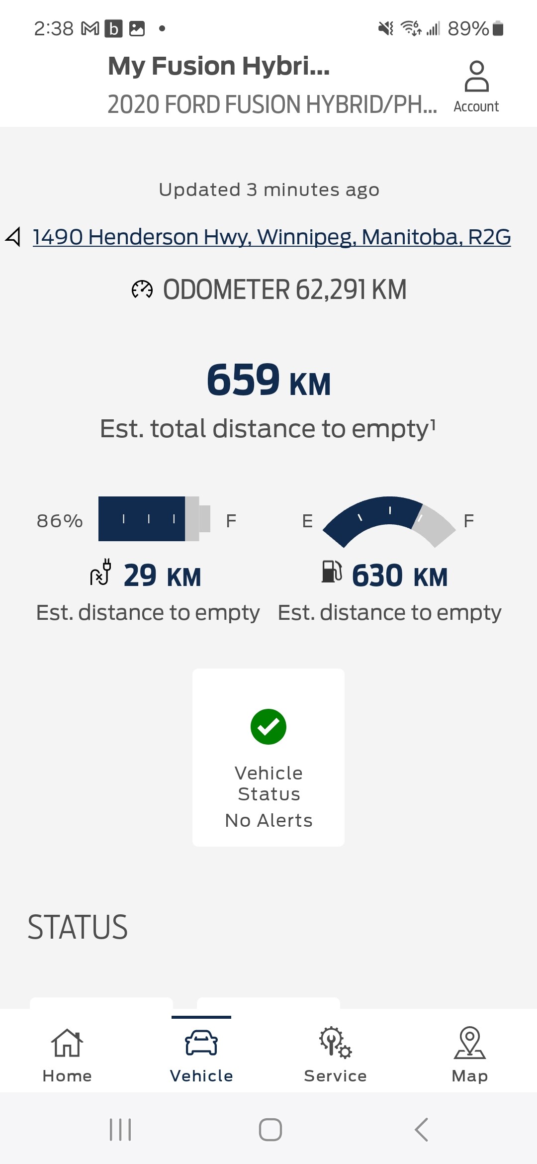

The one thing I don’t get for some reason is Tire pressure in Fordpass. I used to get it before the upgrade.
Referring to the new dark grey build?
On mine I go into service, vehicle health and it take 2-3 minutes to populate if I haven’t driven the car that day.
I have a friend that had his 2017 Fusion plug in hybrid’s modem upgraded to 4g at ford. He just sent me his as built info. He’s in Canada also, so Im guessing thats why we see 754-05- at the bottom.
754-02-01 is set to hybrid as expected.
Only for the J and K series (and onward), the H series are generic.

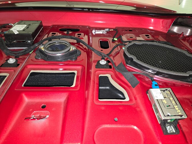

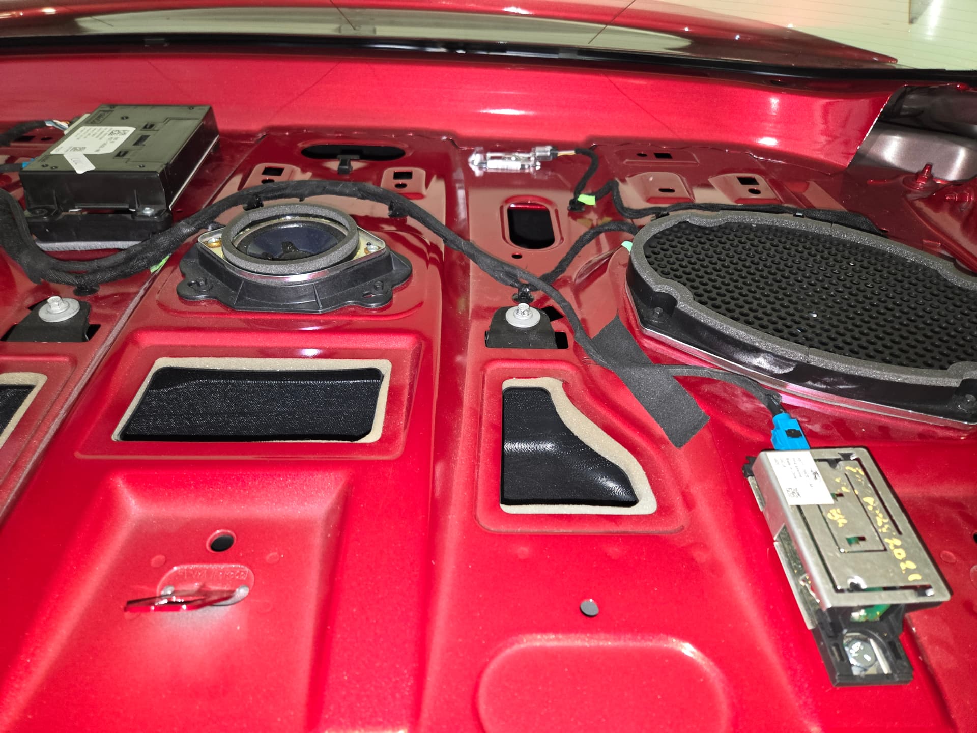

Make sure the antenna is properly grounded by using the proper bolt the vehicle frame or it will not function correctly.
That was what had confused me with seeing that since the replacement part shown in the Ford kit is an H series.
As they come pre-loaded by VIN from Ford when the dealer orders the kit I’m guessing the block isn’t populated for one shipping to the US.
It could also explain some of the problems the dealer service department guys were having getting the kits activated.
Yep. You can reload the firmware to get the blocks back, I think you have to go back 1 version. I haven’t kept track of the firmware versions lately.
There’s a specific area to mount the 4g antenna - I don’t think it is the same as the 3g. I bought the 6ft and I have some coiled, but I don’t know for sure that 3’ would be enough.
These things are mounted all over in the different models. I have seen the Dash, Tailgate, Rear Deck and the D pillar. Any of those will work but the one thing they all have in common is they are near a window.
Fusions usually use the rear deck for these antennas.
Yeah - I was referencing warlock’s picture - the Ford PIFA antenna slots right in to that location without all the hassle of velcro or whatever other - non Ford antenna might need to secure it in place.
The one for the actual Energi kit uses a 6’ extension so that you can connect it it to the TCU since it mounts with tape to the shelf.
The 2013-2016 Fusions didn’t have the bolt hole, that got added because all of the 2017-2018 Platinums came with 4G TCUs as standard with the Ti getting it as an option in 2018.
