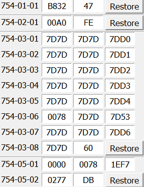

You might be on to something, as I did not use a source, I just changed the existing values to these:
Where do I get the correct ā€˜As Built’ to upload?
In ForScan go into the TCU as built and one of the options is to Save All.
This writes out the current AB to a file that can be uploaded.

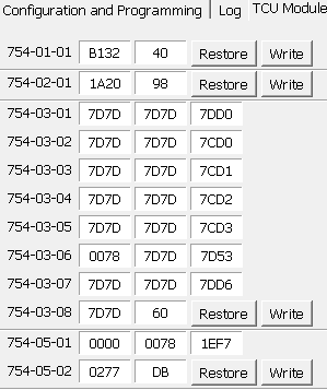

My notes shows 754-02-01 1A20 for the Energi based on Bill’s Ford official upgrade that was done on his car. The value for the Hybrid is 00A0.
Thank you for putting the time in to this and sticking with me. I’ll try this tonight.
Ok, I just tried updating 754-02-01 to 1A20.

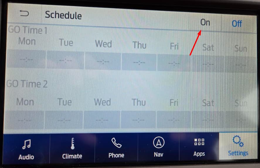

Hi Bill, the options for go times are under charge settings on the Sync3 screen. Somehow they are tied in to the TCU, so I was hopeful there would be the ability to turn them on with the modem upgrade.

It just seems very strange that I can’t turn mine on.
Here’s a pic of exactly what I’m talking about to avoid confusion.
This is under settings - charge in sync.
