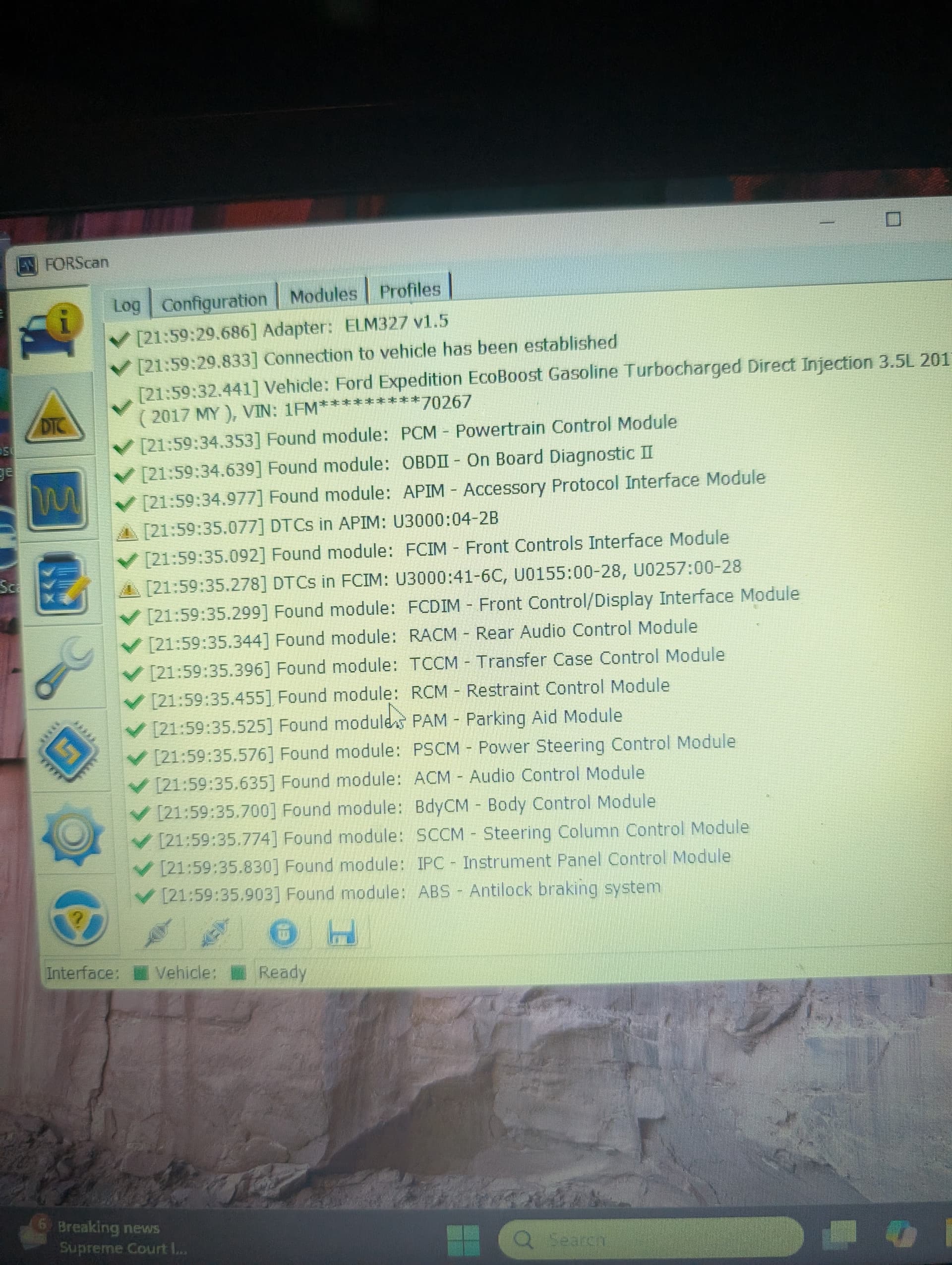

Hi everyone! I’ve been having issues with my truck. Recently my HVAC controls and radio stopped working. Couple of days later radio came back, and rear HVAC controls can be controlled but not via the rear control module. My front HVAC still does not work. Could it be a dead apim? Thank you! Also it’s a Sync 1 4" screen. If it’s a bad apim can someone guide me where to find one?

I have the Tesla screen for it. I put the sync back on when I saw it stopped working. Then it was doing the same thing with the 4" sync. Also my apologies. It’s a 2017 Ford expedition XLT with 4" screen
How is the battery health? How old is the battery?
