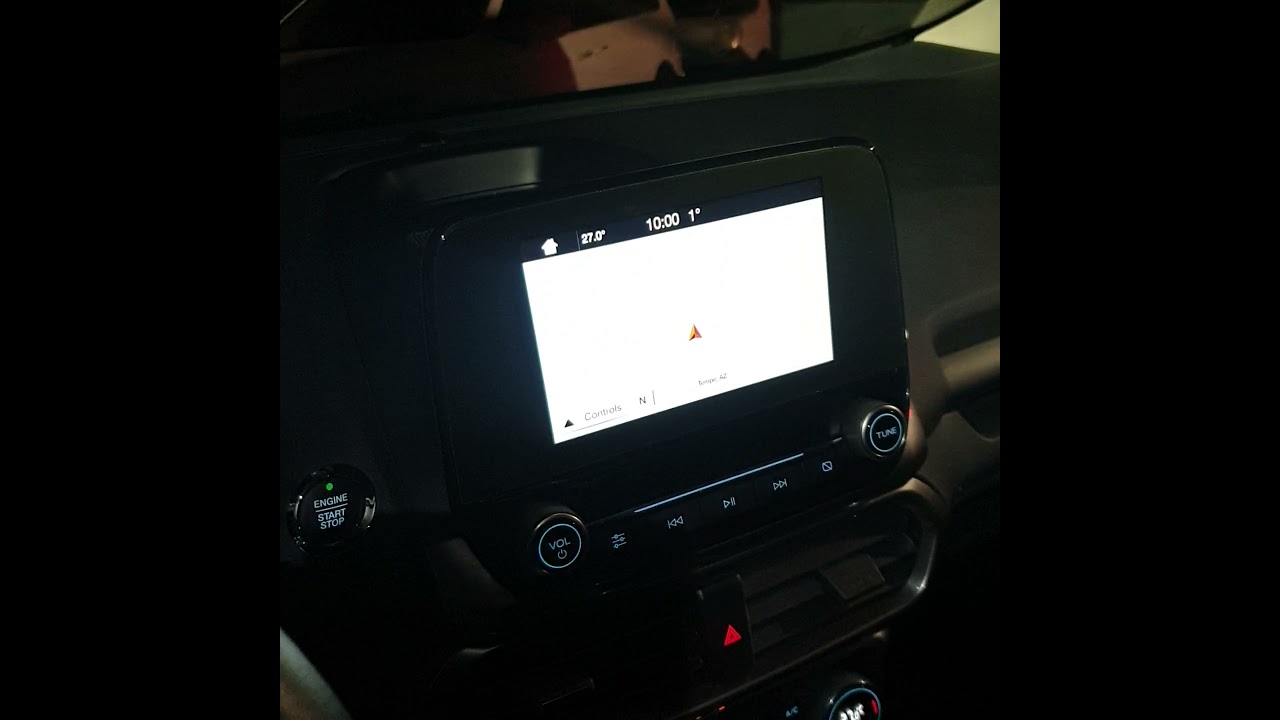

Hi F150Chief here is photo
That is Sync 2.5, not 3.x.

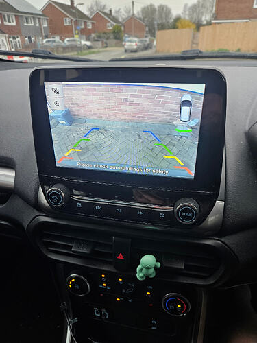

Hi F150Chief i have successfully locatedsync module it’s integrated with my stereo box behind lcd display.

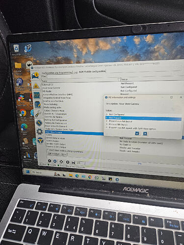

I fitted an aftermarket reverse camera and enabled it with forscan option 2 of the ACM module thank you for your help.
