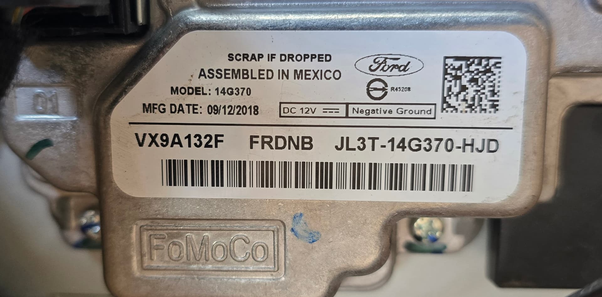

Purchased a Sync 3 screen to upgrade from MFT. Pics showed it came with an APIM, so ordered it quick. Just arrived here at work, but couldn’t find any info on it in the APIM database. Won’t be able to mess with it till tonight, but wanted to know if I got a Nav or non-nav. Google searched had no info on it.
JL3T-14G370-HJD
Mfg Date: 09/12/2018

So, unless you check the date on it (there’s a sticker on its back with information), I would treat it as MY20.

Apologies, I missed that you already posted the date on your opening message. Can you share a photo of that sticker?.

At least to me, that sticker does not scream “fake”.
So lets see what other have to say, because if it’s OEM it may not be MY20 (as the sticker says).
But wait for confirmation/feedback from F150Chief
Sticker matches all the referances I have so I agree with Sandman that it is legit.

The sticker looks OEM. The info in the file will tell us if the EMMC is MY20+ or not.

I purchased online from a wrecked F150, so Im assuming its OEM.
