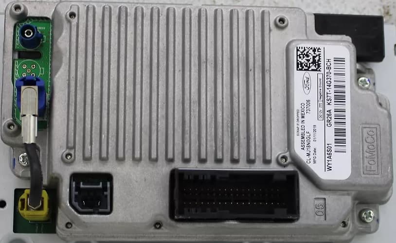

How’s this one? MFG Date is 1/11/2019 if its not clear.
Only thing I’m not sure about is it seems to be a Gen 4 based on the images here: https://naviupgrade.com/all/resources/sync-2-vs-sync-3-whats-the-difference/
So, does this make it a MY20 and will it work in my 2015? Thanks!
Looks fine to me. I have the same one in my 2015 Explorer.
That’s a NAV unit pulled from a 2019 Fusion.
If the seller has the VIN of the car it was pulled from you can validate it if you like by going to go to owner.ford.com with that VIN.
The ESN shown on the page should match what’s in the picture. (the WY number at the start of the part number line)

Found it through the map updates page. The ESN matches the sticker on the APIM. I guess I’ll go ahead and pull the trigger on this. It’s a screen and APIM. Seems like a good price from what I can tell. Thanks for the help.
