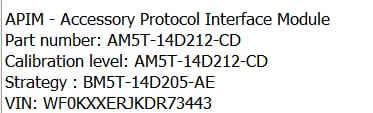

(are the modules compatible in the pictures down below)

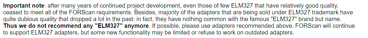

What adapter are you using and what version of Forscan?
for the adapter im using elm327 HS MS Switch and the Forscan version is 2.3.65
im using the free extended license for it
From the Forscan website….
I would get a OBDLink EX adapter.

WF0KXXERJKDR73443_APIM_20260301_114519.abt (75 Bytes)
