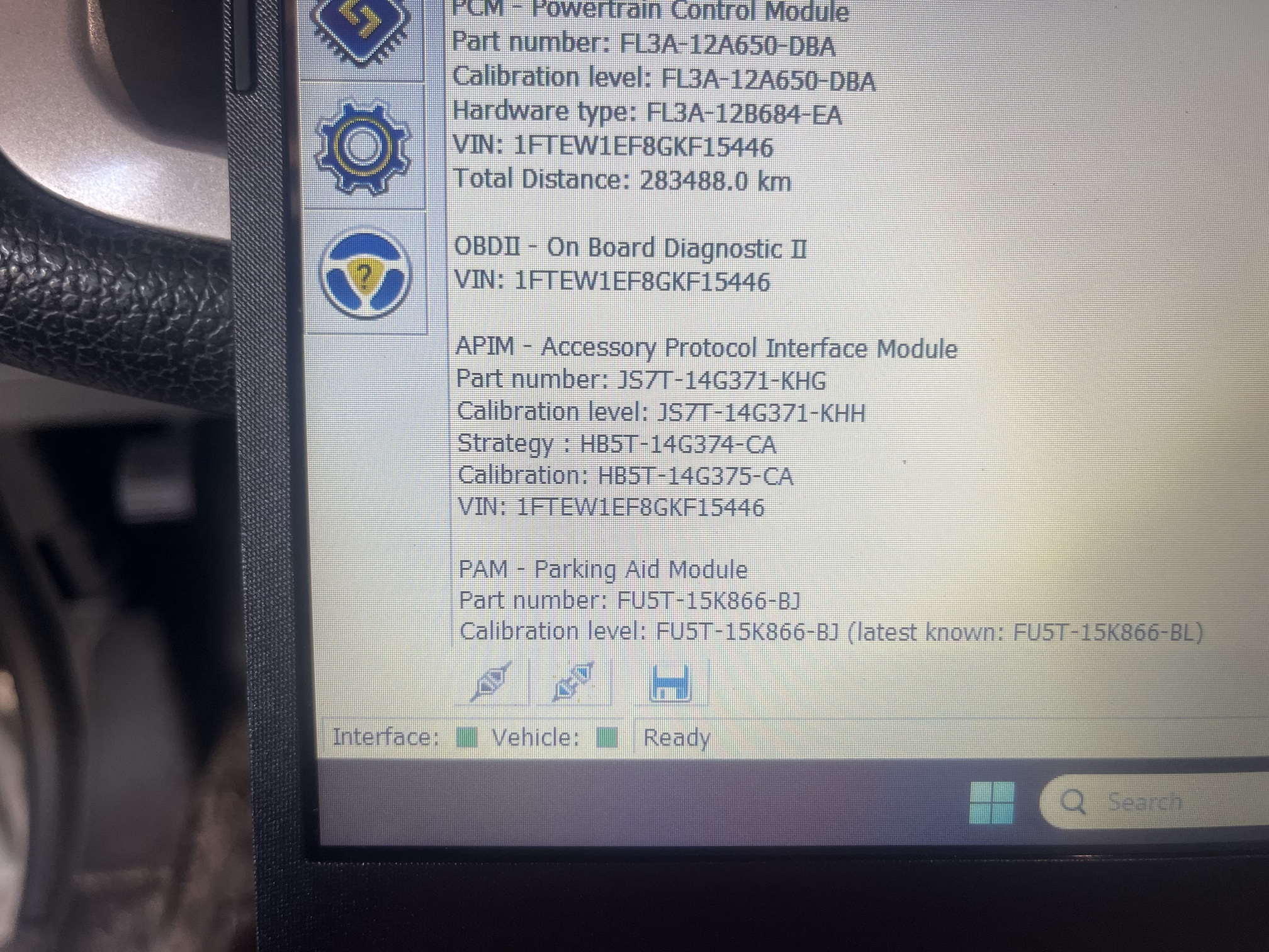

Check apim asbuilt with forscan
Ok will do that today and let you know
That is not the Asbuilt info that has been requested. But now we know you have a J series APIM which is not a bad thing.

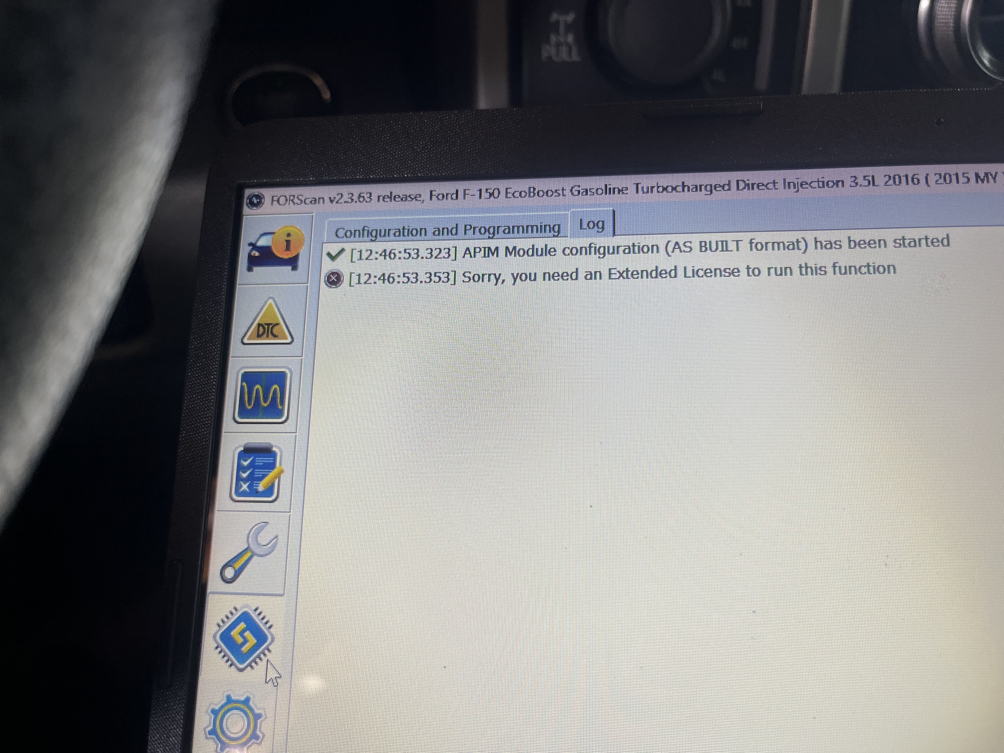

Ok I’m waiting on a new license key to use forscan
You only need a license for the paid version. Retriving AB info does not require a paid version.
