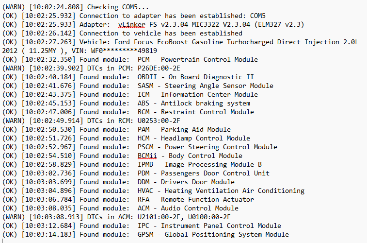

We don’t get a pull down menu after the initial scan, we only get a popup asking if I want to save the profile (with the vehicle details). See the log attached.
The log shows the 2012 vehicle. Did you make a new profile?
This is the new profile. With the laptop disconnected from the car I deleted all existing profiles from Forscan. I checked to make sure auto connect was not selected in the settings. Connected the laptop to the the car using the Vlinker, turned the ignition on, and selected the connect / scan icon from the bottom left of Forscan. It takes a minute to scan the car, found all the modules above, then asked if I would like to save the profile.
