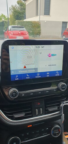

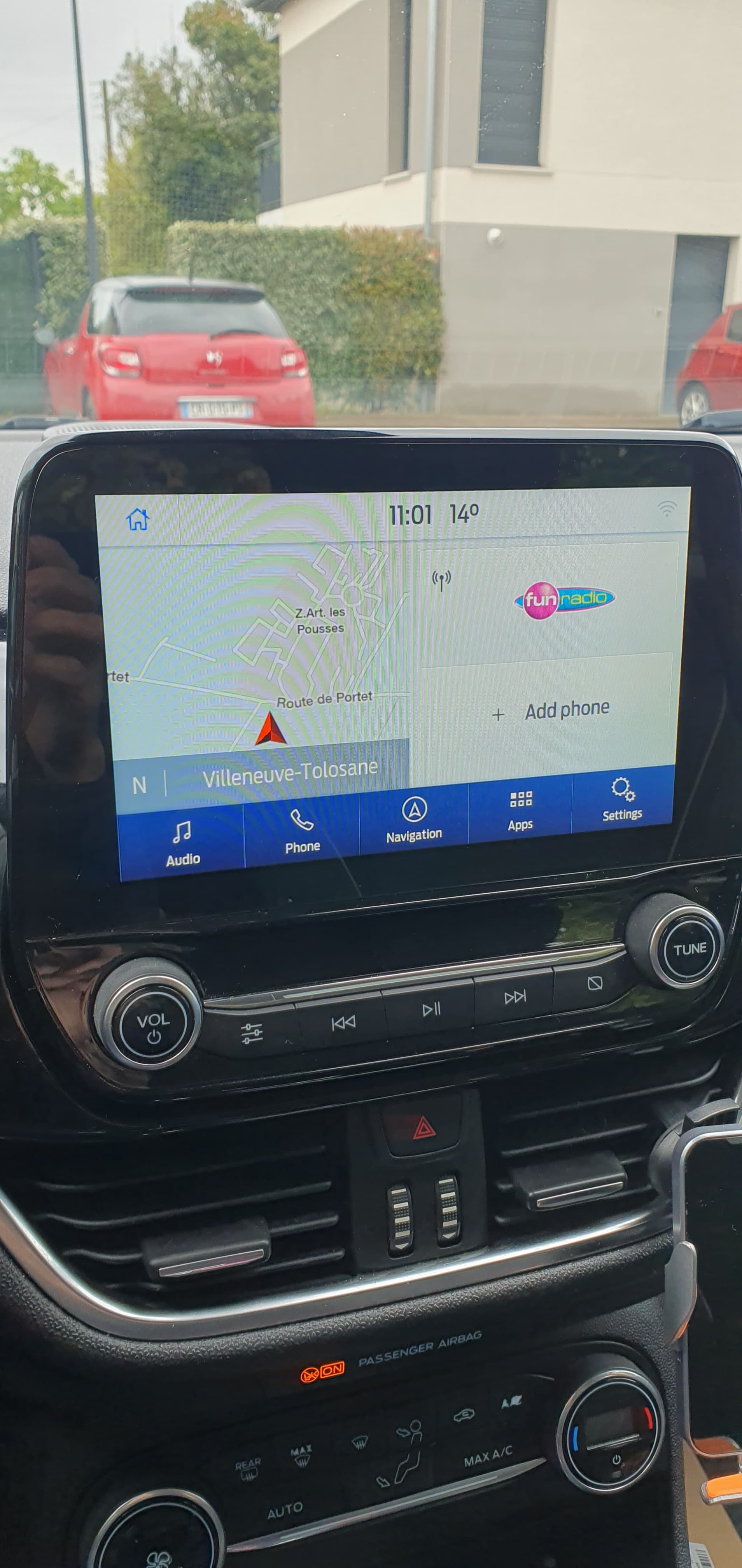

Bonjour, j’ai une ford fiesta 2018. J’ai fait la mise à jour de 3.0.23219 sur 3.4.21194. Tout marche bien mais je n’ai pas eu dans le menu le climate control.

Hello, I have a 2018 Ford Fiesta. I updated from 3.0.23219 to 3.4.21194. Everything works fine, but I don’t have climate control in the menu.

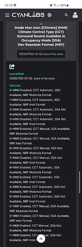

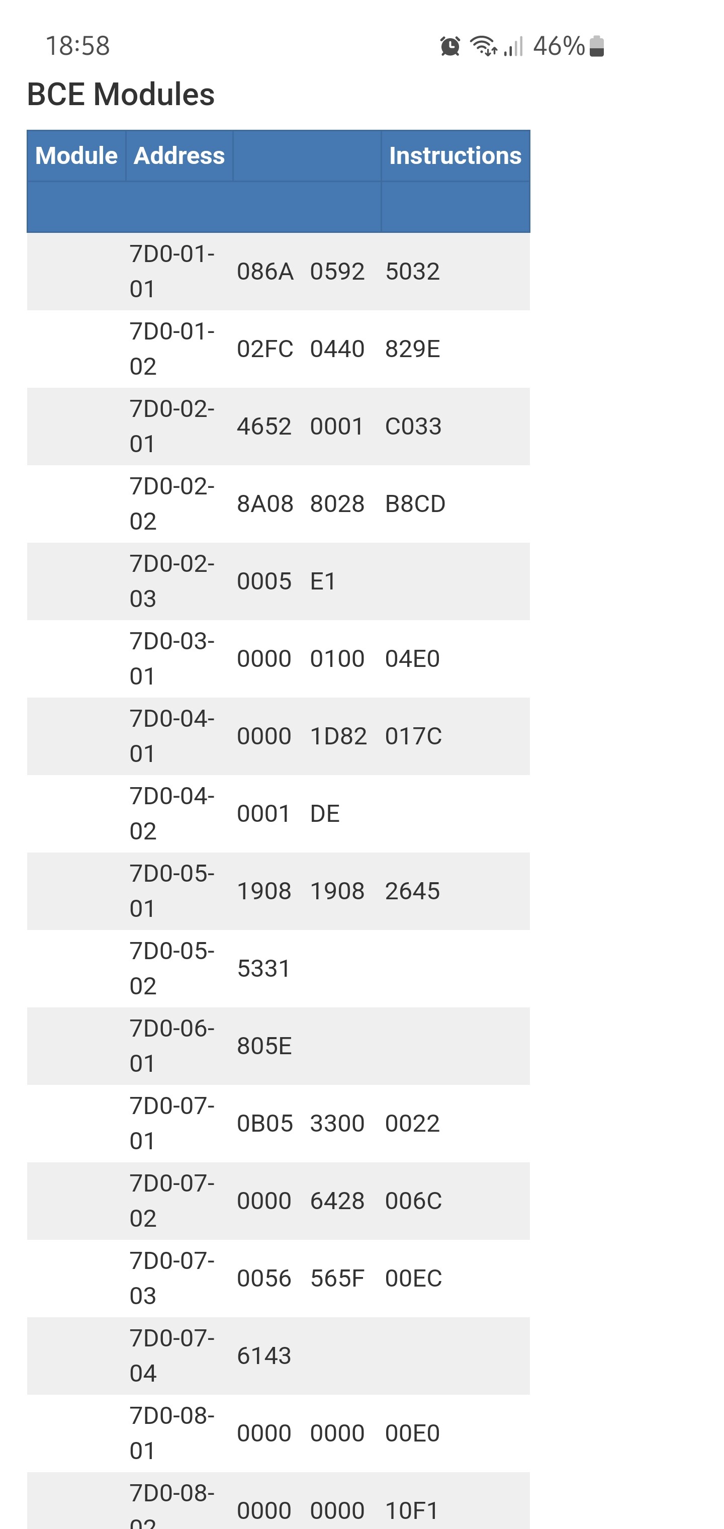

Can someone tell me which numbers I need to change for see the climate contol ? I looked in the SYNC 3 & 4 APIM AsBuilt Decoder but I don’t understand. I understand that I need to change the APIM as-bilt 7D0-01-01 and 7D0-01-02, but which numbers should I use for my car?
This is the as-built for my car from the site motorcraftservice.com :

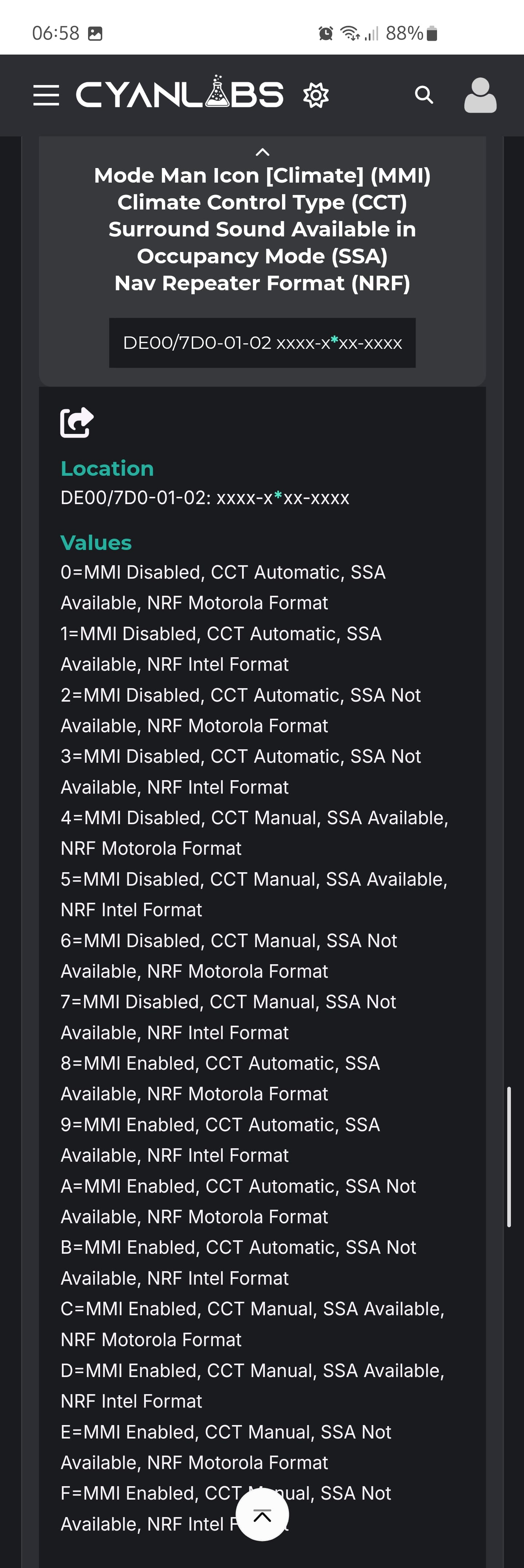

Hello, I am making slow progress with my problem :grinning_face_with_smiling_eyes: I looked at the as built database and there are things I don’t understand.
To change the climate control I have to change the code
DE00/7D0-01-02: xxxx-x*xx-xxxx
In different forums they say I should put 3. But in database here 3=MMI Disabled. Shouldn’t I put 8, which is 8=MMI Enabled ?
