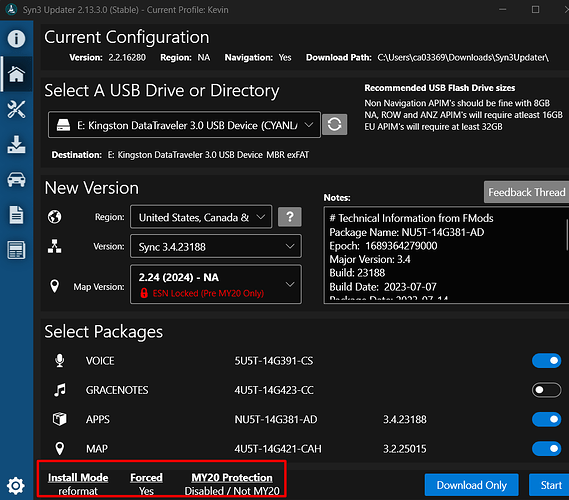

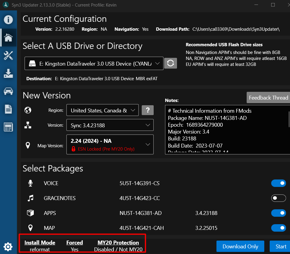

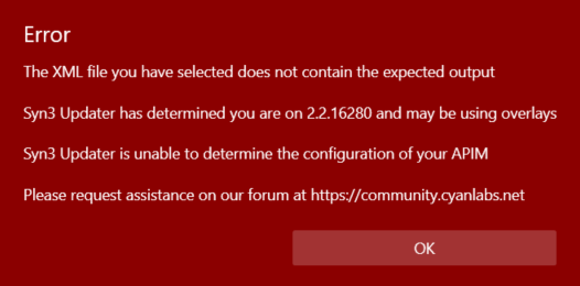

I tried running the interrigator, and Syn3updater sent me here for help.
I am certain this is not a MY20 unit, but wanted to run the interrigator just to make sure I don’t have any surprises. Can I just go ahead with the update without running interrigator?
See file Sync_WW497HJX_2FMPK4J85HBB95328.xml attached.
Sync_WW497HJX_2FMPK4J85HBB95328.xml (10.5 KB)
This is on Sync3.0 so the highest supported without using the Updater to reformat is would be 3.0.23219.

Keep in mind even a 2017 Ford Edge can have a replacement APIM that is 2020+.
This one is older…in fact, very old.

Wow, Not even an H series.
LOL. You guys are the best.
The owner gets an error when trying to update via the version via the ford web site also.
I’m going to tell him he needs a newer apim module if he wants to do anything with his sync and maps.
