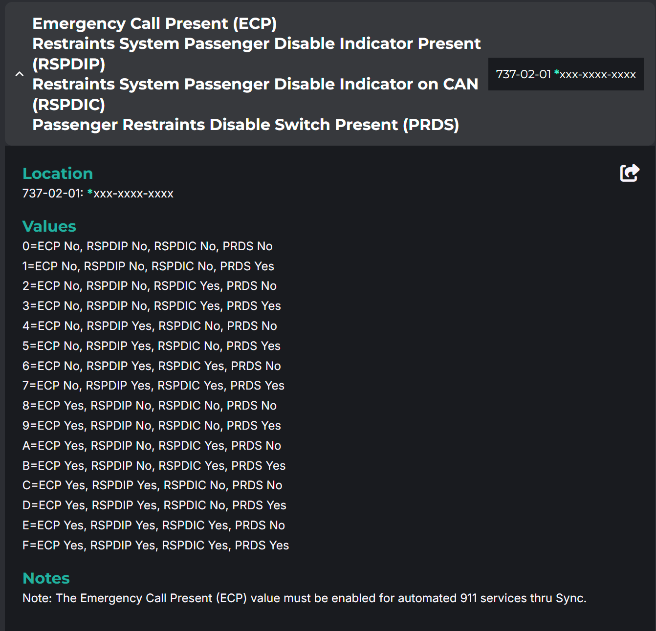

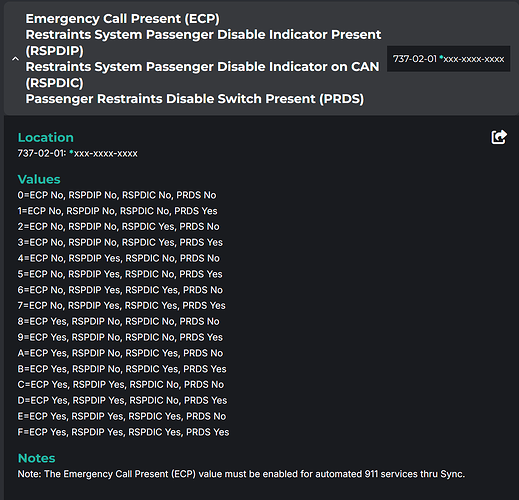

I believe this is the crash signal that the RCM sends out for the emergency call. You just need to use Forscan to turn that off in the RCM.
I believe it too. The doubt in this case is: is the GWM registering the module, forcing RCM to see for it, or it is just a matter of config on RCM?
In case of RCM config, any instructions about what to disable?
RCM (2015-2017) Database - CyanLabs
Not sure what your settings are now but here is what we have in the database.
This will likely solve the issue if it is the emergency call feature. This should be equivalent to turning it off in the APIM…
