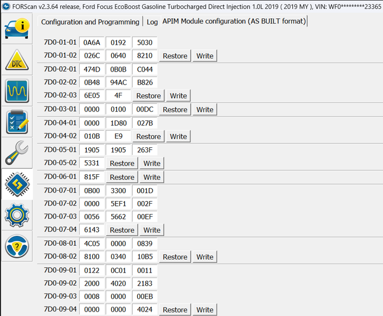

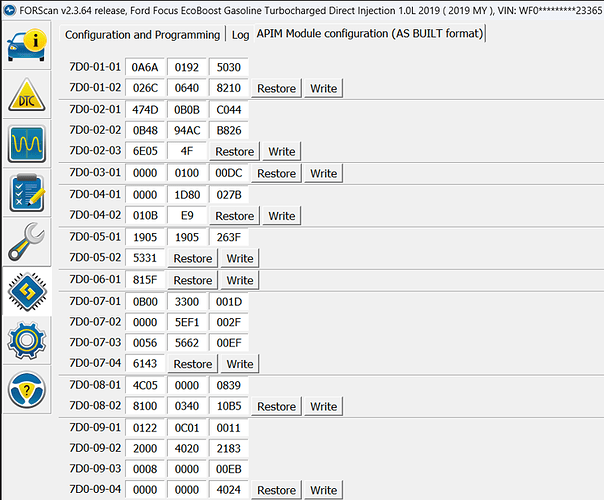

I am trying to enable Flank Guard on my Ford Focus MK4 2019, but I can’t get it working. With Flank Guard I mean the little car in the right top corner with the parking sensors.
My APIM settings:
What I have found what the settings should be, but I already had these settings:
Object Detection for Rear View Camera (Car Icon In Top Right Corner)
7D0-01-01 xXxx xxxx xxxx = A
Flank Guard (On Screen Object Detection for All Sensors When Driving Slowly)
7D0-02-02 xXxx xxxx xxxx = B
Am I missing something? Can anyone help me with this?

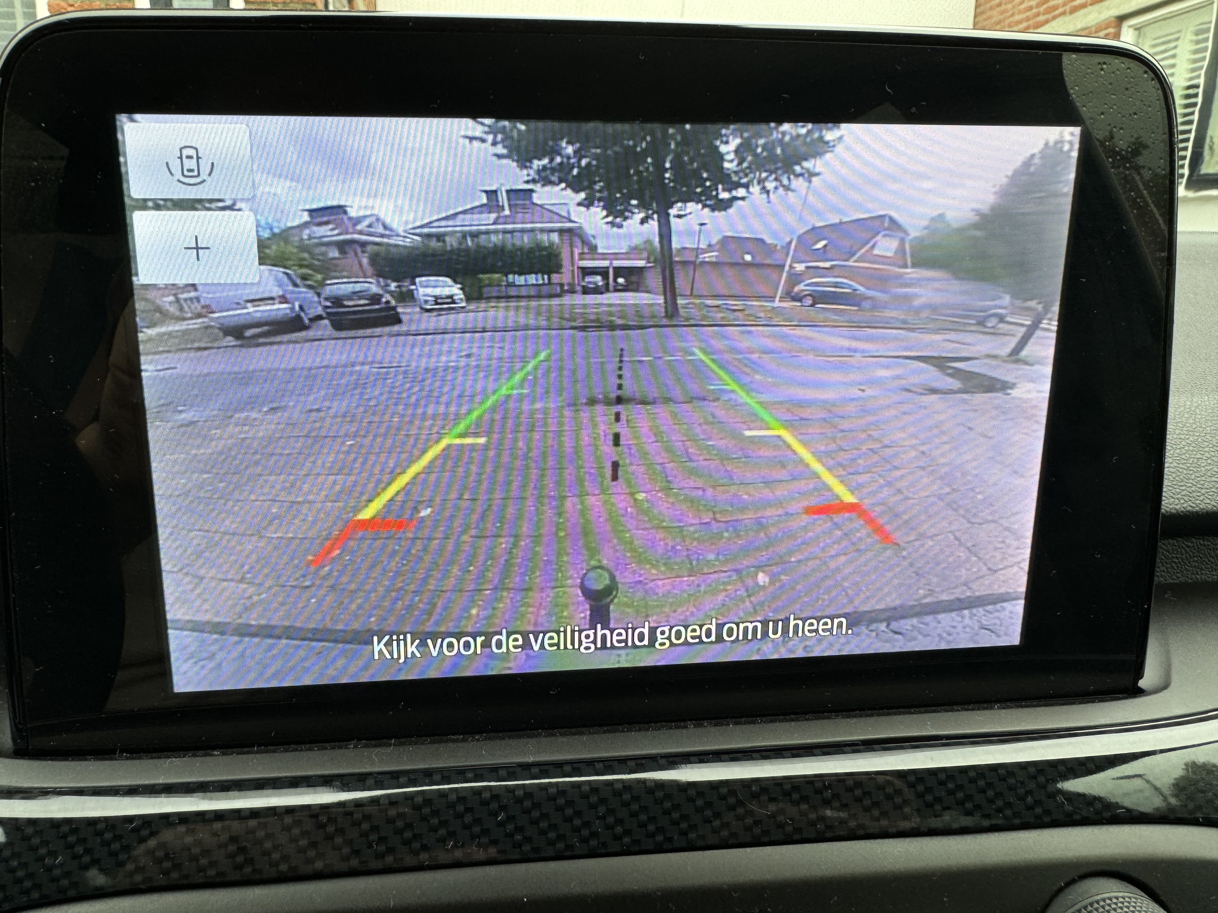

FORscan says it has 12 sensors. I don’t see any visual indication, only audio indication (beep in several tones).
This is what I see in reverse:
You should have the visual indication. Did you make any changes in the past that could have removed it?
Are there physically 12 sensors installed? Active park assist?
Just because you can enable things with Forscan does not mean they will work. In most cases you will need the supporting hardware to get them to work.
Since I have bought the car, it didn’t have the visual indication.
It has 12 sensors installed and I have park assist.
I didn’t change anything in FORscan what could break this, I am very careful with changing tjonge in FORscan.
