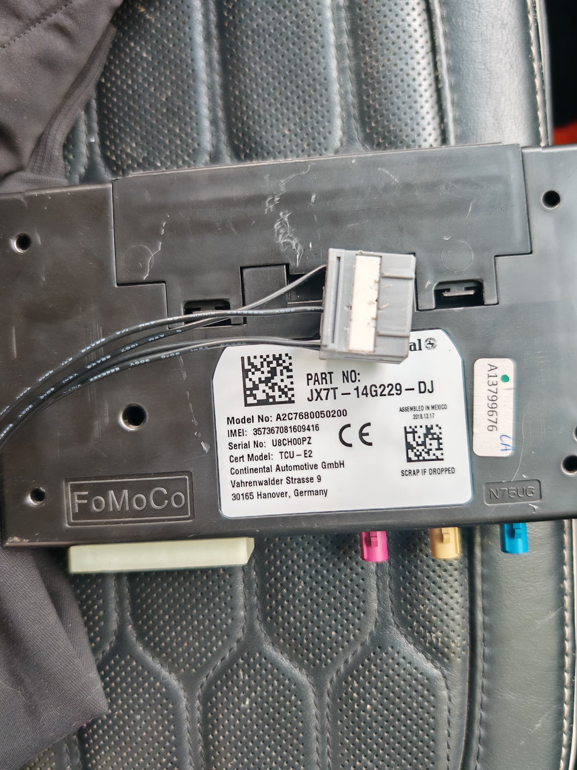

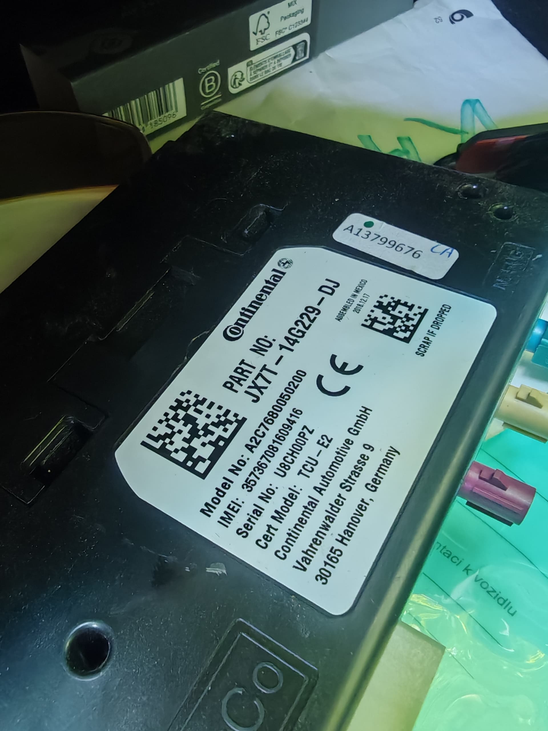

So JX7T-14G229-DJ should be fine?
For EU, yes. It is labeled TCU-E2?
yes on photos is E2, does the edge 2017 have old 3G tcu ? or where its shold located ? if there is wire prepared ?

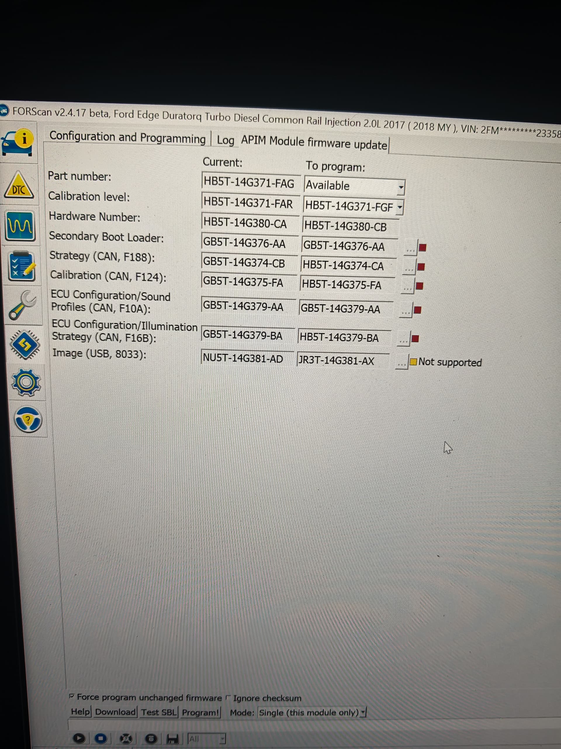

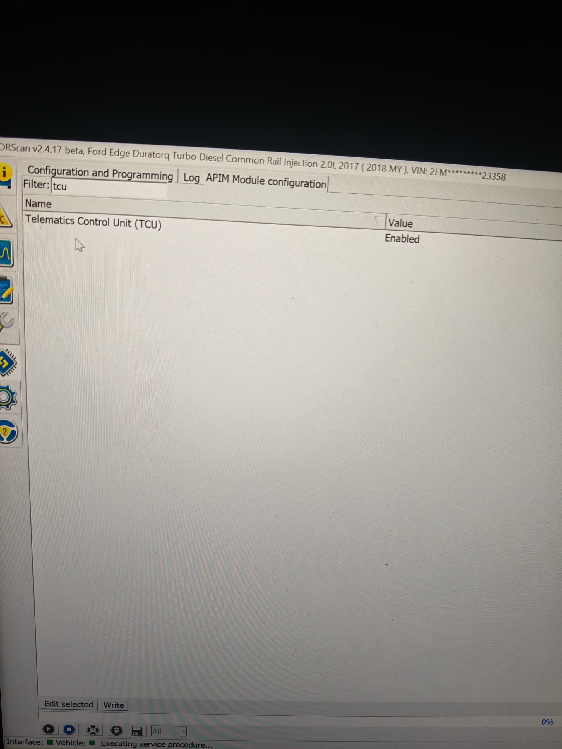

So order this tcu, now i looking for others thinks, i have forscan with pay licence, can i really add the tcu in car via forscan and make the firmware edit? Somewhere i see thay its possible only via ucds. Thanks
Yes you should be able to do it with Forscan. I juat recently did this to my 2015 Mustang using Forscan . I had to update the calibration and strategy of the TCU with Forscan and make a few asbuilt edits. Activated the hotspot and activated Fordpass. Only issue I have is that I do not have remote start/unlock/lock on Fordpass. I do have everything else. I am not sure if this a Ford server exclusion and will never get those options or if there needs to be more asbuilt edits.

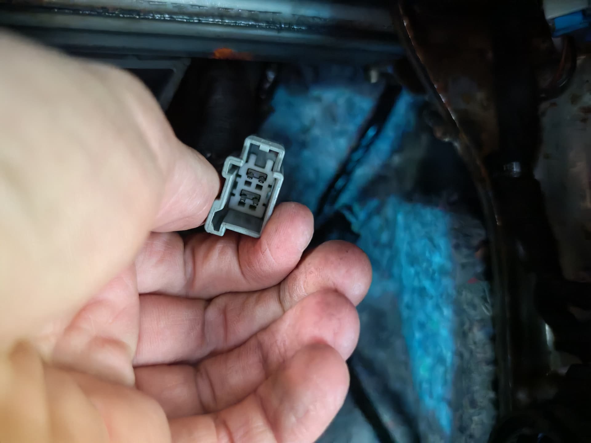

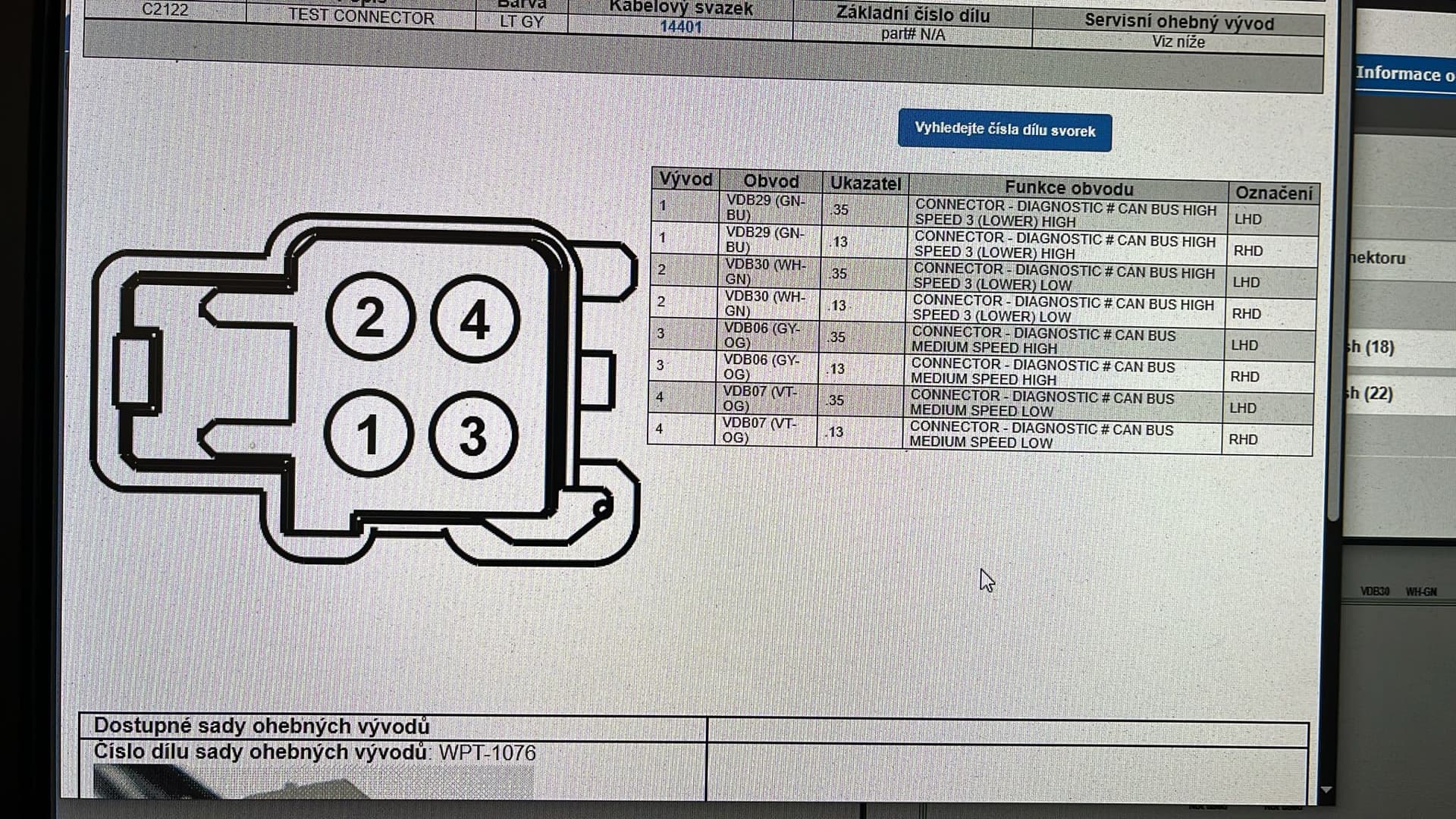

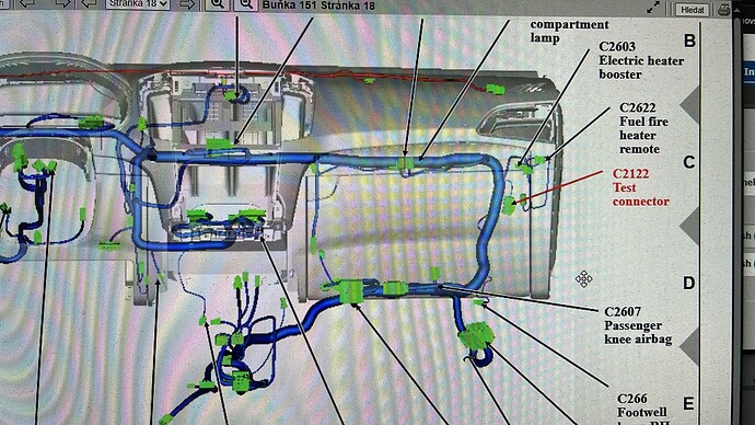

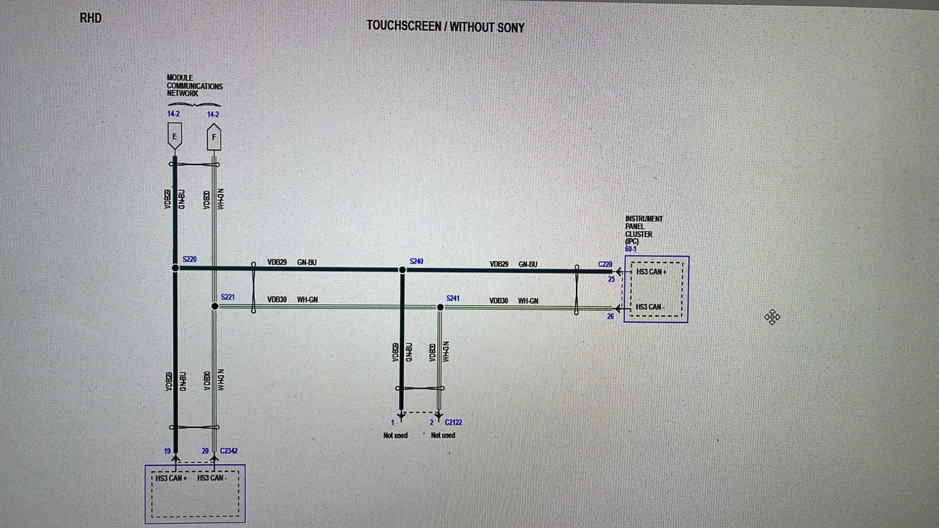

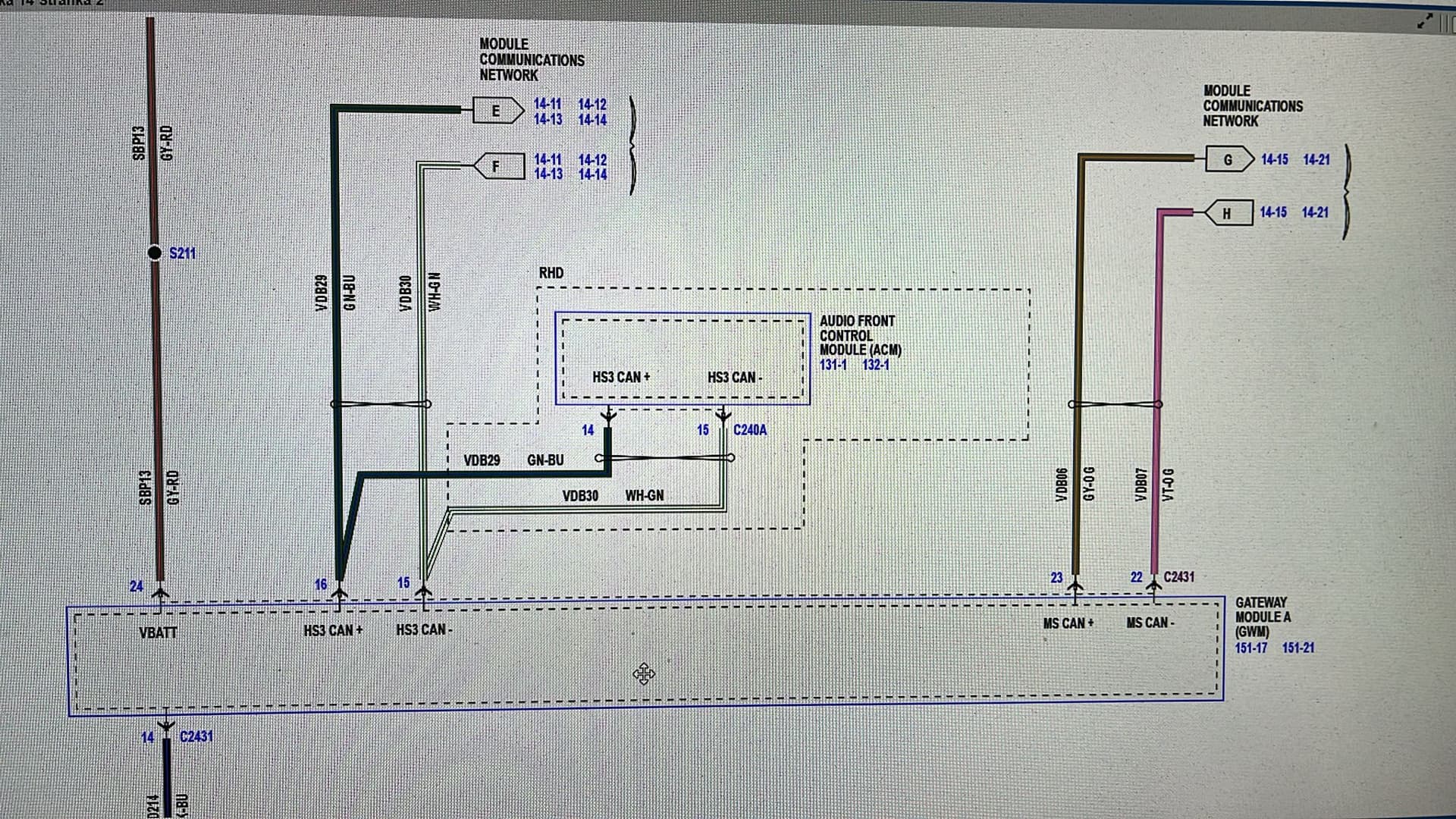

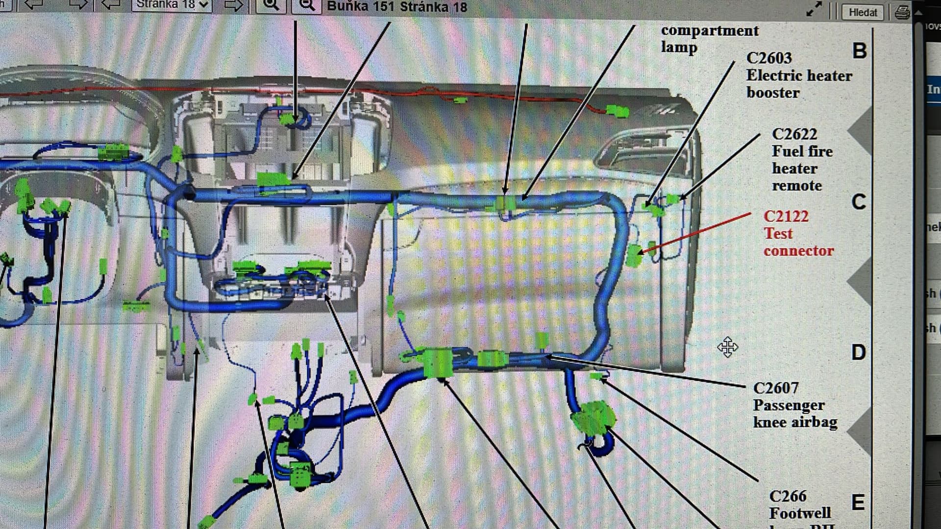

Inorder J series so its on hs3 right, i found free connector with hs3, thats should work right?
Yes. Make sure to use twisted pair wiring, like CAT5 network wire, for the HS3-CAN connection. Pins 1 and 2.
Pin one is hs+ and pin 2 hs- right? I already buy connector for tcu, bud need to look on c2122, and also search here stable 12v
yes

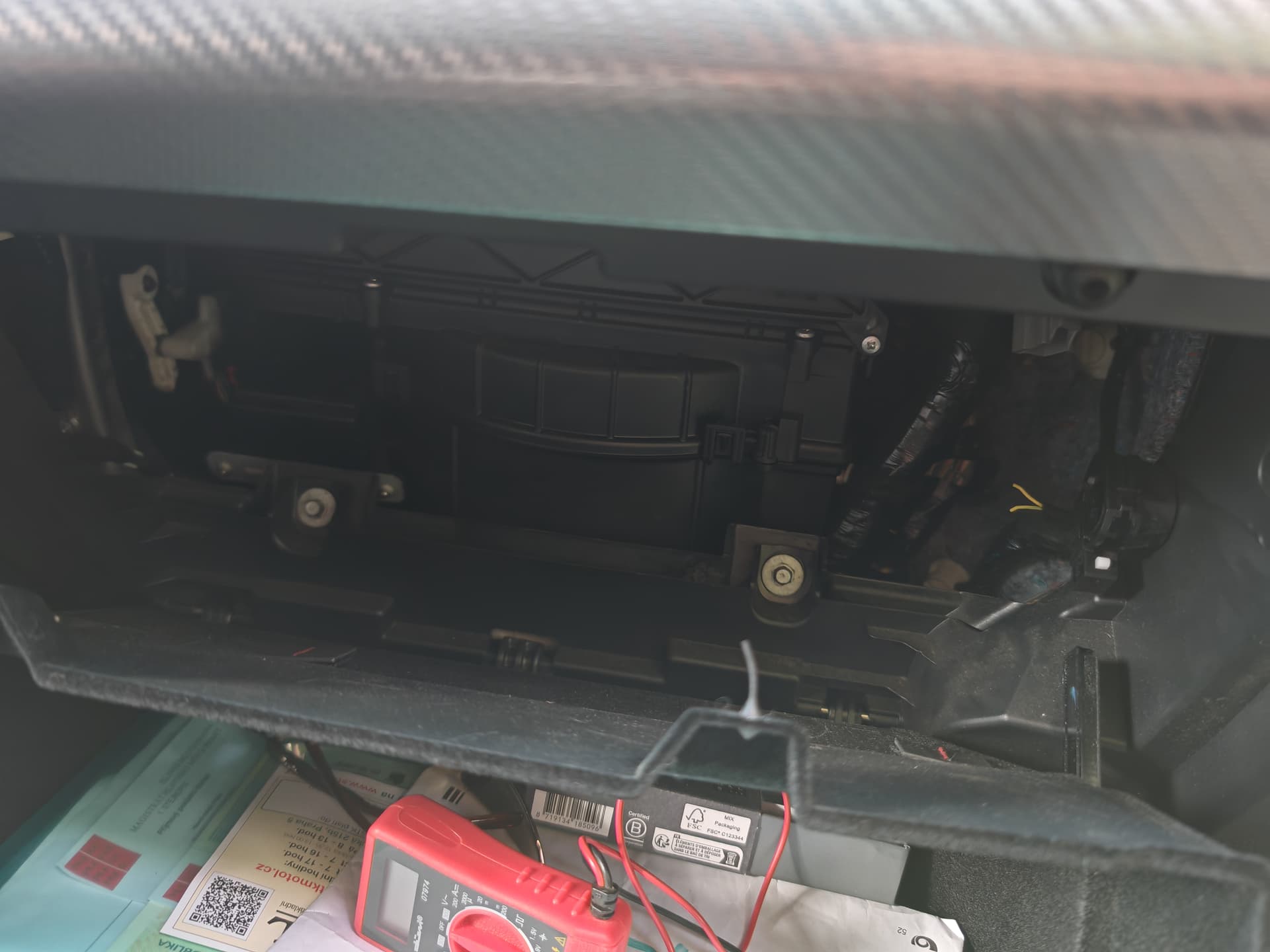

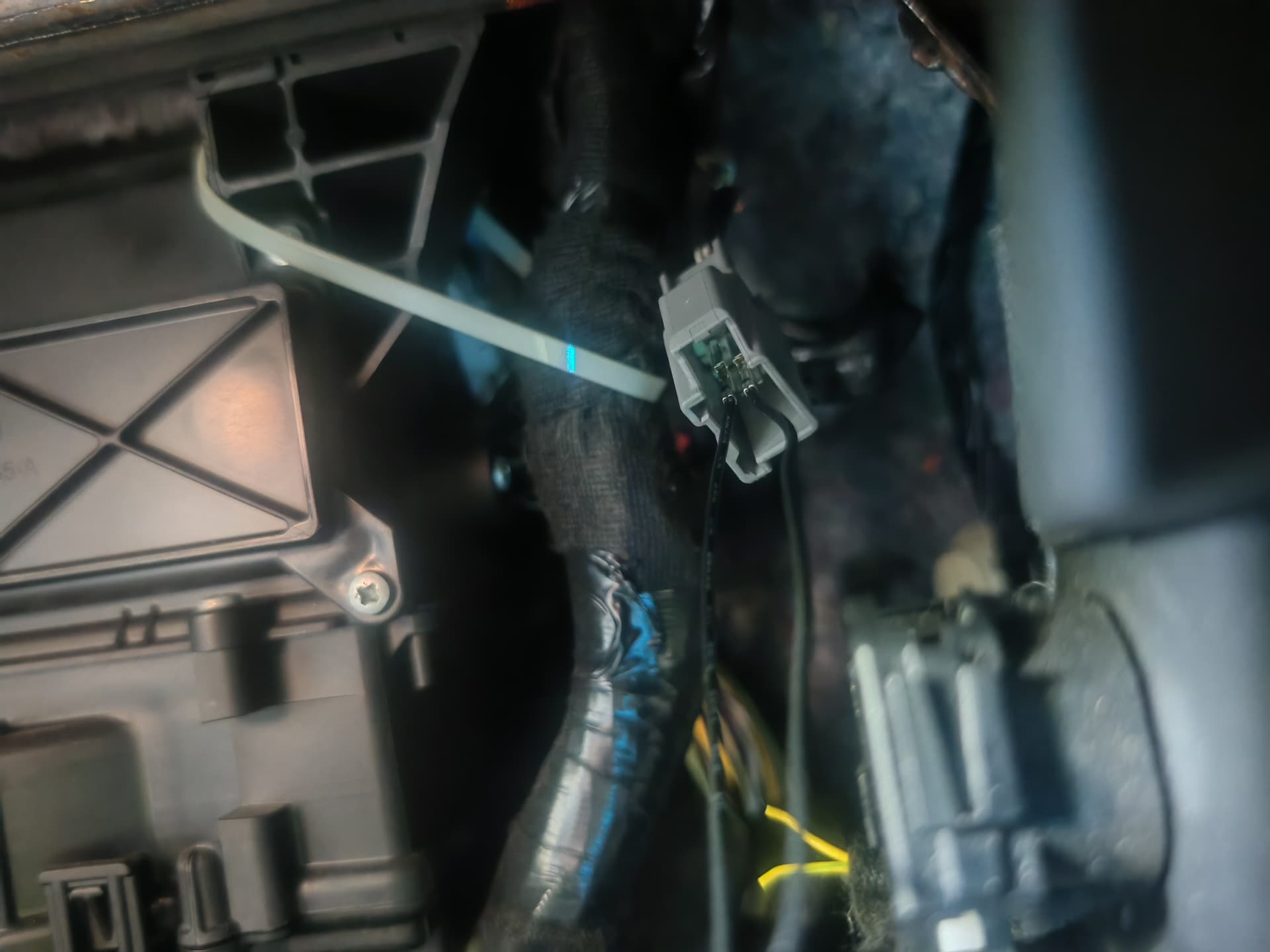

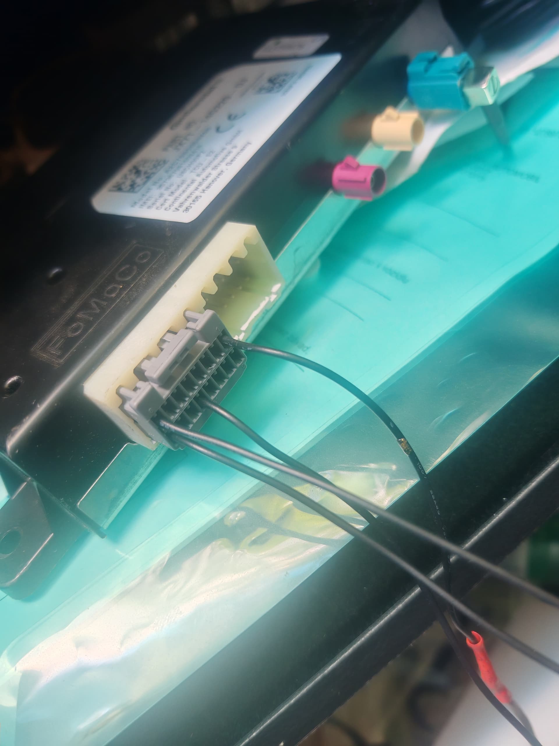

Hello, so i have tcu already, and connector ready, i think i found the hs3 test connector, but now i need to found from where i can take 12v any idea please? And also there is not much space for the tcu… Better will be put the tcu back with tail tcu, but there is not hs3, just hs

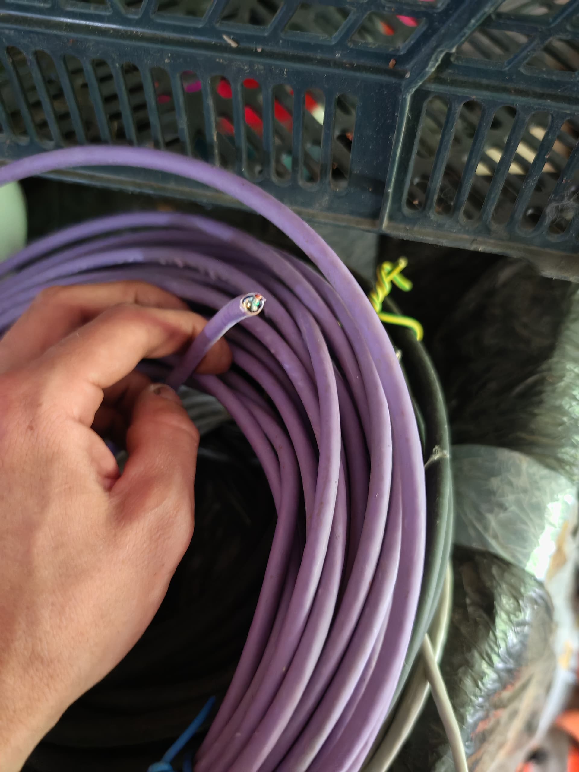

So I used Cat6 cable for my install. One pair twisted wires for HS3, one pair for +12v and one pair for ground. I have a 2015 Mustang and the HS3 connector was driver side by GWM (OBD connector) and the power was on the passenger side BCM/fuse panel. I used a fuse tap in the fuse position that was normally used for a TCU if it had one and the ground was a stud near the BCM/fuse panel. This works quite well.
I would try to do something similar. Look at similar models that have a TCU and see where they get their power from. Depending on the type of fuse you might need to use a different fuse tap.

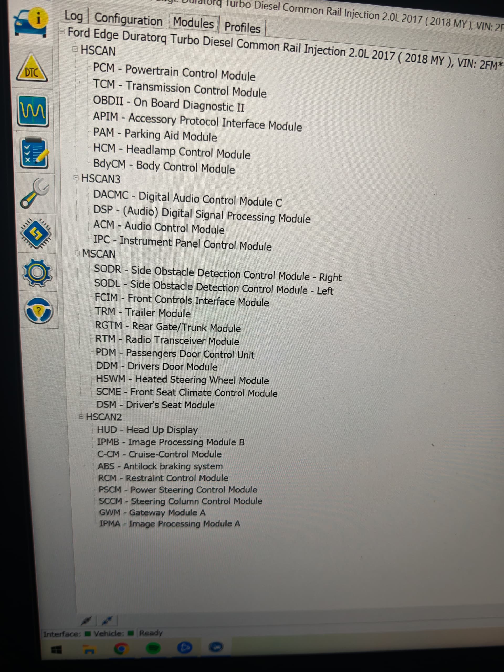

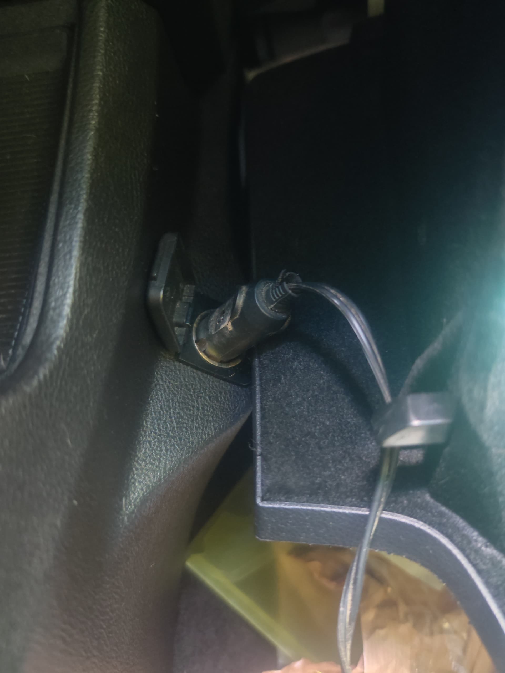

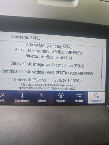

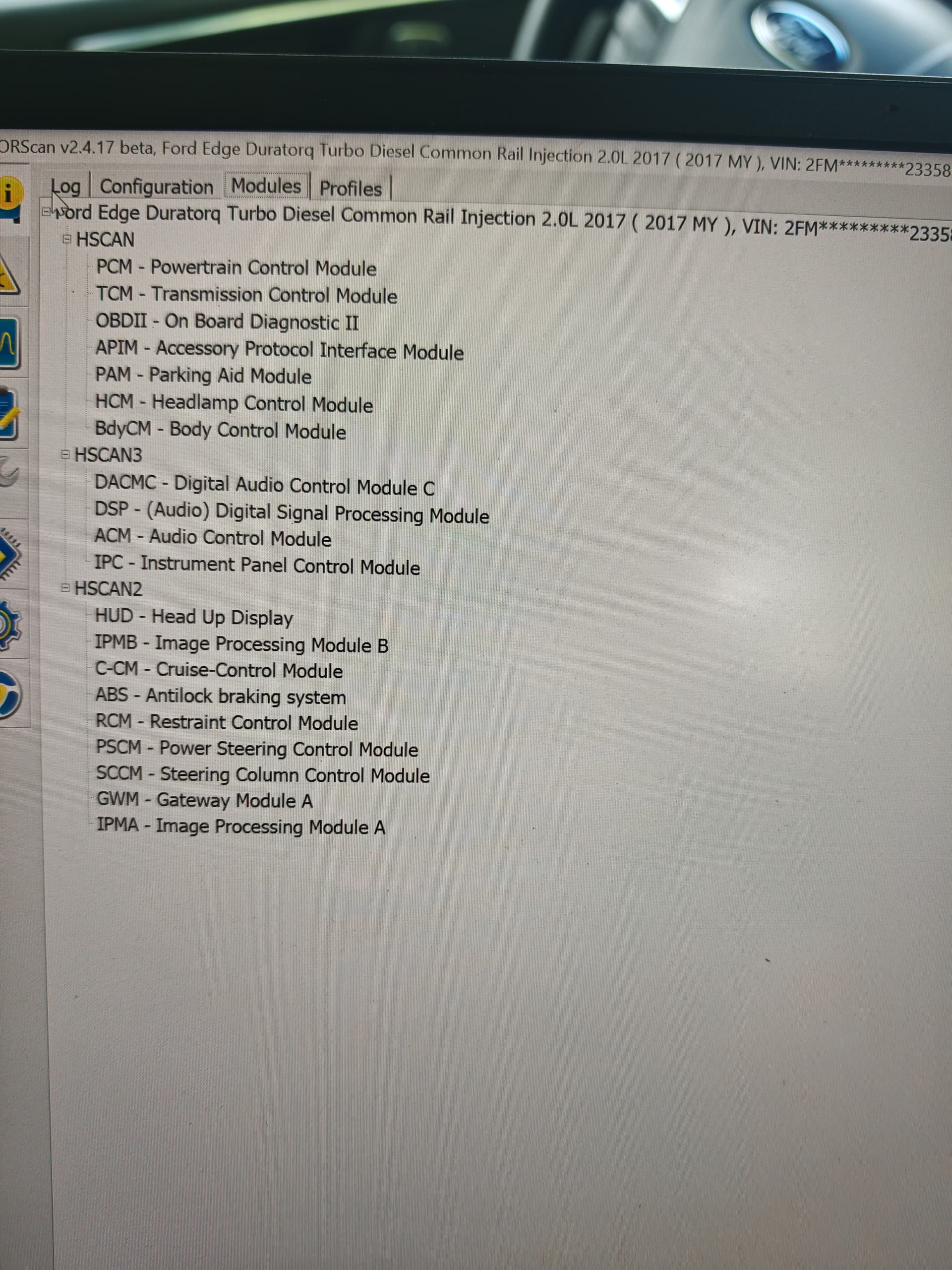

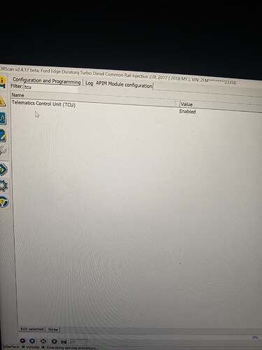

Hello, so i just connect the tcu to hs3 test connector, and for testing i power the tcu with 12v socket in the car, i enable the tcu in apim but there is not serial number, also in forscan i cant see the tcu, any idea what can be wrong?

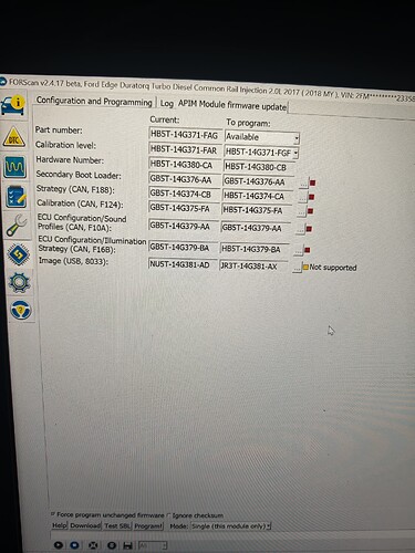

You will need to scan for the TCU with a new FORScan profile. But, getting the TCU to show up on the APIM first. Check you CAN wiring, make sure it is not backwards. Can you post the info for the APIM…look in FORScan at the module tab and post that info.
New profile i do 3 times, i also delete all from forscan and nothing, i check the hs3 pins and its good but should i try change them? Also check the 12v power to unit. Can i do somethink bad to unit if i put them backward? Or on this connector there is can bus medium speed, should i try connect the tcu here?
Make sure the polarity is correct for the HS3 connection
So i check the wire and it was ok, i was try to put it on can bus medium and get some errors and now ms can is not see in car, but see one error lost comunication with tcu. But now the clima control not working
