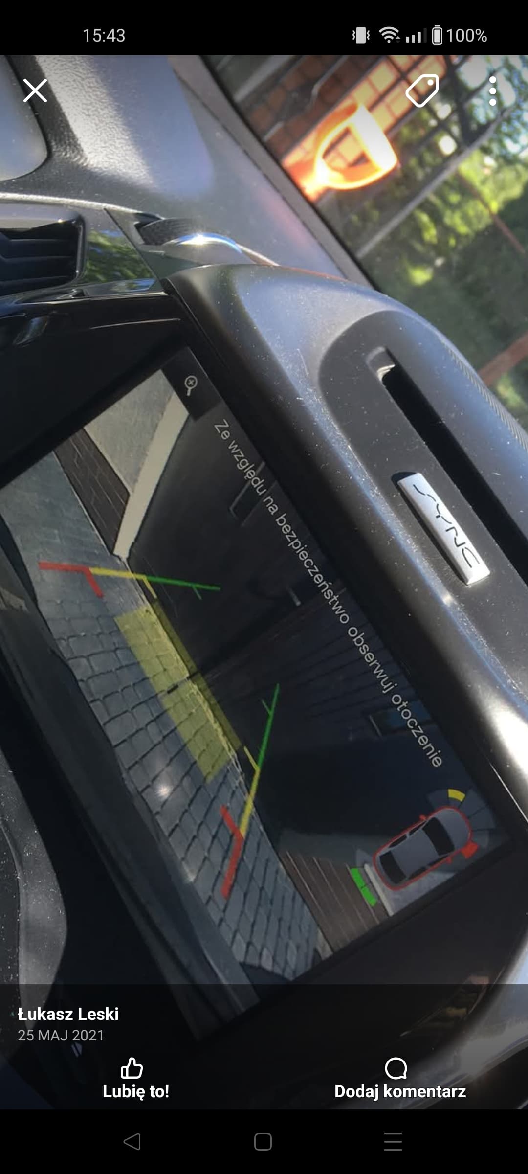

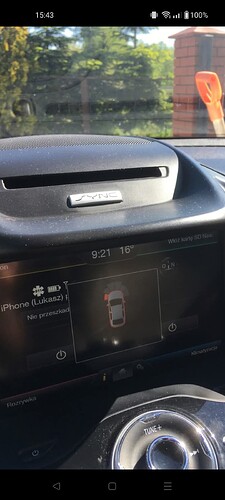

Hello all! I am trying to enable flank guard (some kind of PDC visualisation) in my Ford Escape 2013, Titanium version. The car is equipped with park assist (it is able to park on its own) and as far, as I know it determines that the flank guard (or something like that) should be possible to be turned on.
I’ve found some pictures of Escape 2015 showing exactly what I want to enable:

You probably need to access the PAM with the FoCCUS software. However, a 2013 Escape/Kuga didn’t support flank guard. Flank guard is not parking assist, and requires more sensors than the parking assist feature.
