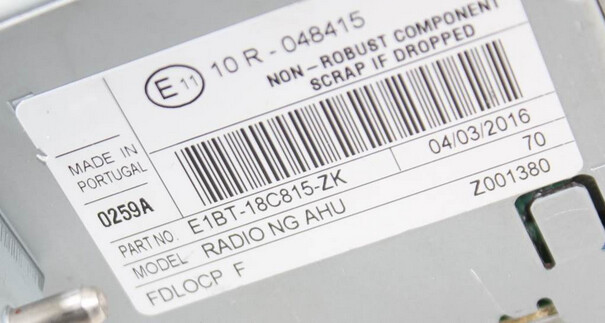

i better ask!
would this one work?
Yes, that ACM should work.
