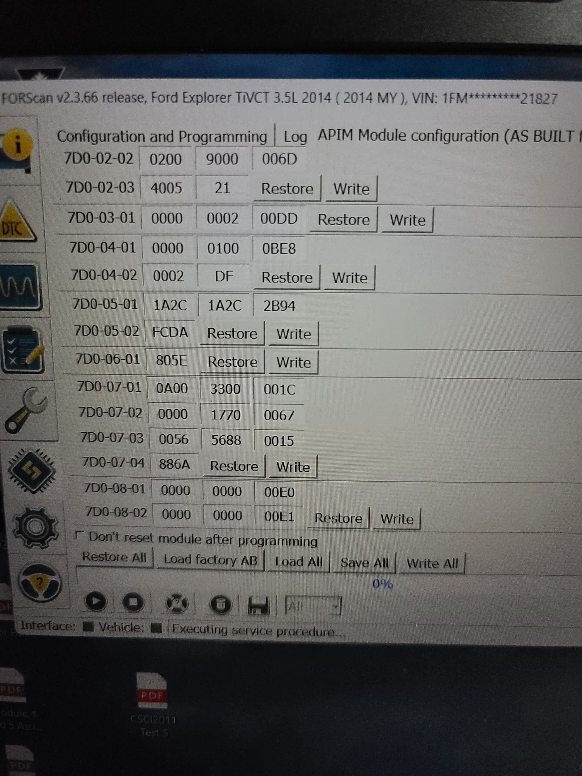

I just want a pic of the AB for the APIM.

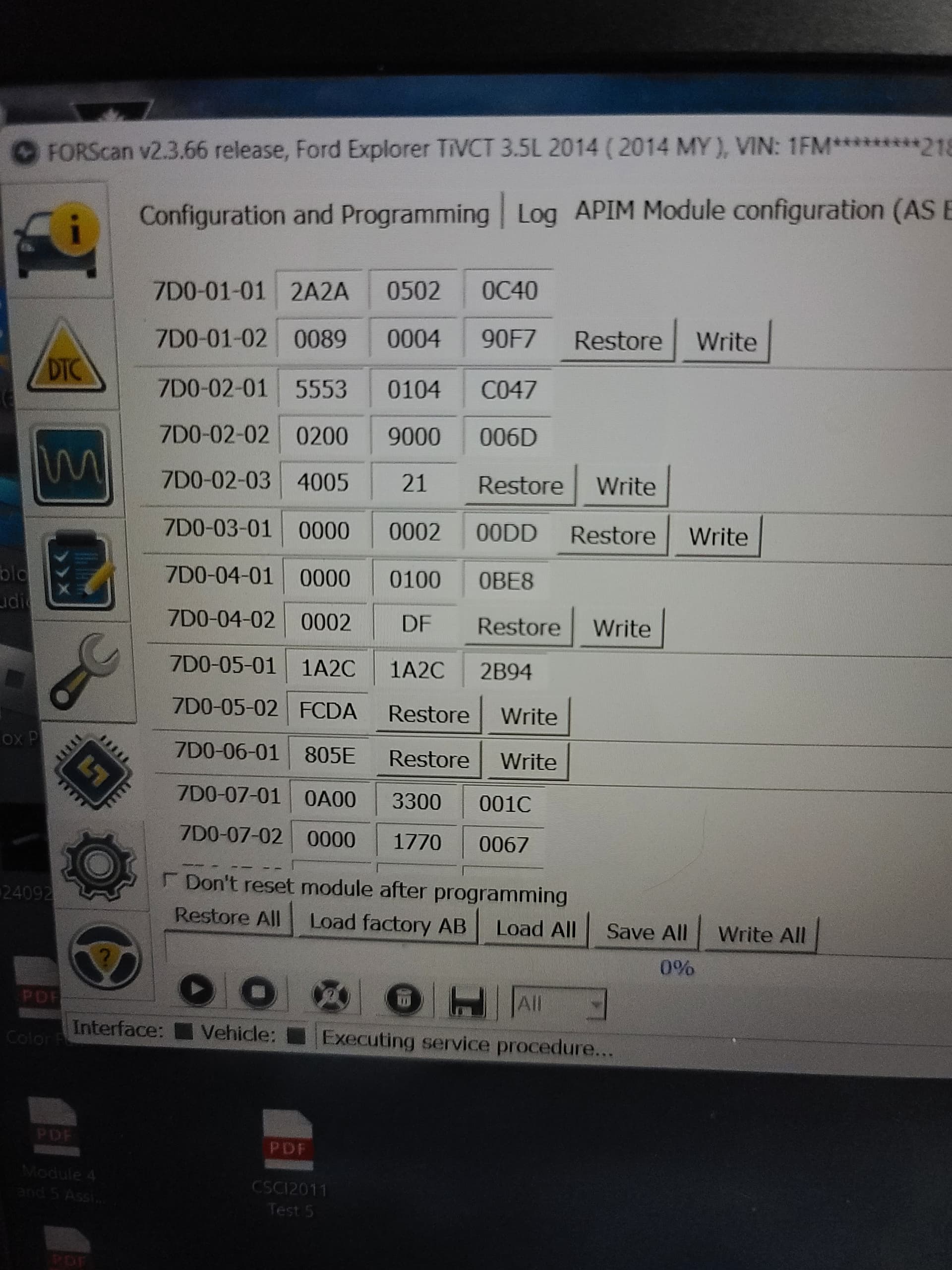

Is it this?
Why 2? Which one is the current one?
Both is current. 2nd pic has last 4 codes that you cant see in the 1st one.
I see what you did, Not worried about the 08 Bytes.

7D0-01-01 is not coded properly. Should be 2A21. That will solve some issues.
Will this go on the first box that has 2A2A? Thank you for the help and I will be trying this tomorrow after work. Will update what fixed and didnt fix
yes
So I changed it and it didnt fix anything. Also I see an option for heated steering wheel which I dont have
